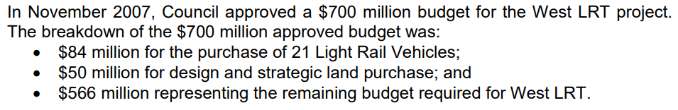

And the Blue Line is a pretty good design, but had is own issues. Here's a public audit done after construction finished, that has some interesting details - some unique, some consistent - with other projects. It didn't seem like a cheap time to build back then, but it certainly looks cheap now!
Main point - budget of $700M became about $1.3B over the life of the project, so nearly 100% cost over-run:
West LRT Audit, 2013
Original budget cost = $700M in 2007, not sure if the alignment was finalized yet:
Total actual cost ended up being ~$1.3B by 2013:
While this third table is the budget approved of about $1.4B:
