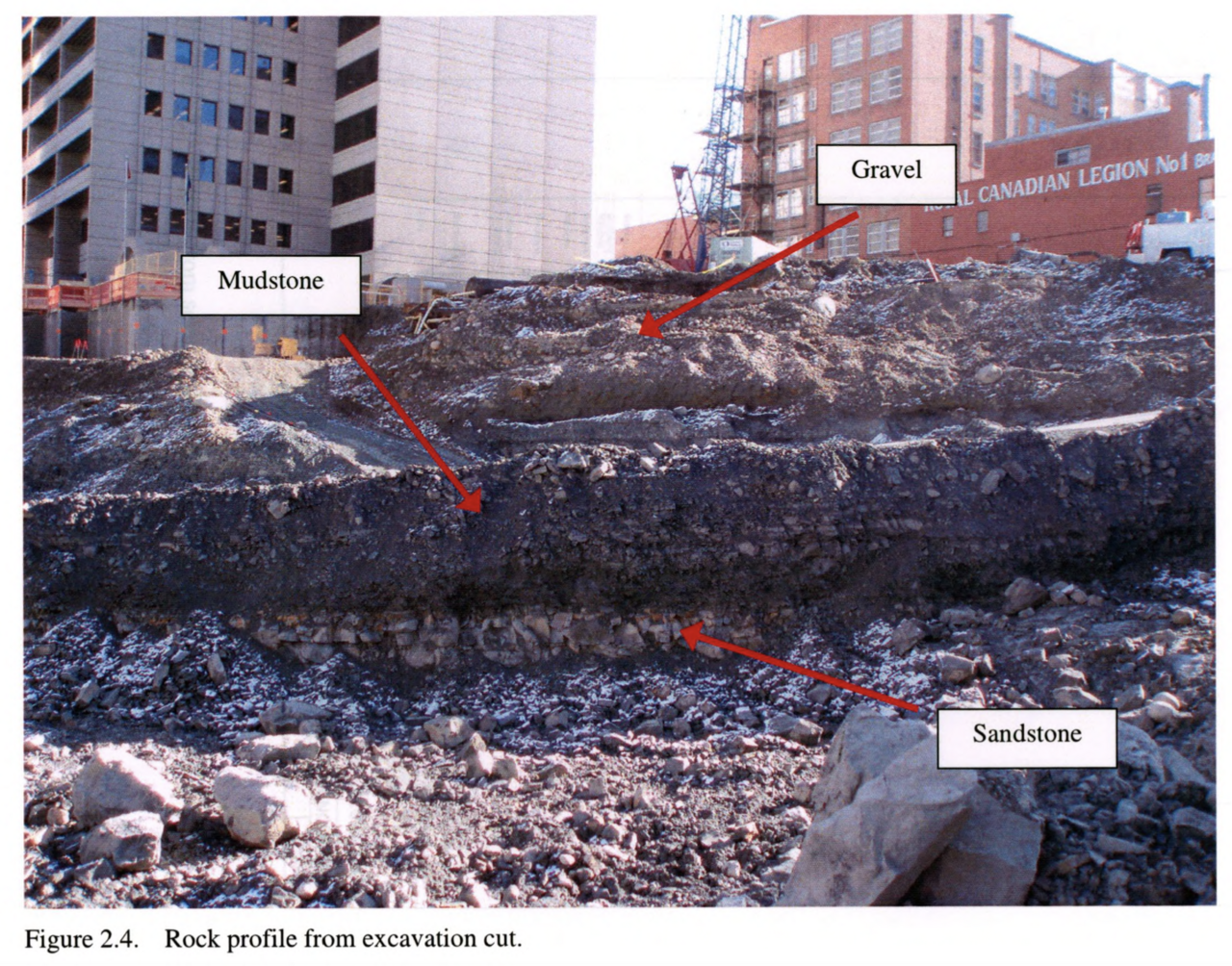

1734554526478-png.620510
An interesting photo from a masters thesis when digging the pit for The Bow
So the tunnel had its risks, and I guess they were just willing to accept those risks but not other risks related to land value.
