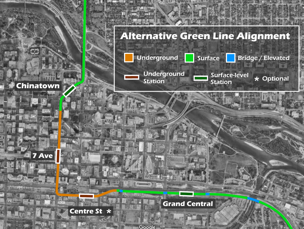

Here's what I would do to mitigate costs downtown.
Guessing it's too late to go this route? But if y'all think there's any chance otherwise I would happily send this to every city councillor.
The issues I see there have to do with the distance required to get to proper tunnel depth. Your tunnel would have to go under the underpass at 1 St SE and the train wouldn't be able to get to the surface by 2 St SE, which means it would have to stay at depth (2 St SE also has an underpass). Perhaps it could surface just west of 4 St SE.
I've been big on this 1st St SW idea for a long time. Even just having the 1st Street underpass as an already dug out starting point will fully supported walls would have to make things so much easier (though I imagine it would need to go a bit deeper there, too).
