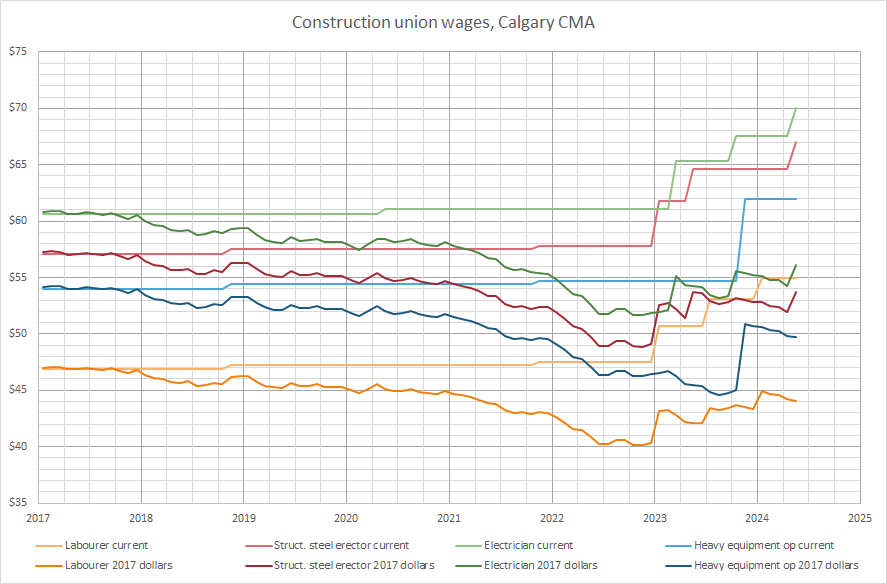

Which leaves labour as another key element; I don't think it'll surprise people what happened to labour if materials went up faster than construction overall. I've got two sources here; one is the union construction wage for Calgary, and one is average weekly earnings in Alberta by industry. Note that these are not identical measures -- you can increase someone's wage and cut their hours, or keep their wage flat but give them overtime to increase their earnings. You can also have someone more productive make more output for the same earnings. Not to mention that plenty of construction workers are non-union (especially in terms of 'construction industry workers', which includes the office staff at construction companies, managers, etc.) Note that the union wage numbers are only updated twice a year.
The actual union wages were pretty flat until 2023; while earnings more generally rose about 20% pretty steadily, but the all get to the same ballpark in the end. In any case, these are going up at a lower rate than construction in general.
Note this is a period of pretty substantial consumer price increases: here are the union wages (in actual dollars), both in current dollars (i.e. what the pay stub will say) and in constant 2017 dollars (i.e. how much they can buy relative to 2017 after inflation), showing the reduced buying power because of inflation:
On paper, these workers saw their wages go up by 20% or so since 2017, mostly in the past year. At the checkout, they can afford about 92-94% of what they could 7 1/2 years ago, and the recent wage bumps only take them back to mid-2021 purchasing power.
All this of course doesn't include other potential inflation factors (land acquisition -- house prices have shot up; financing costs -- interest also spiked), as well as likely the other culprits of scope creep, mispricing risk because of the design-build contract structure, etc, etc, etc.
