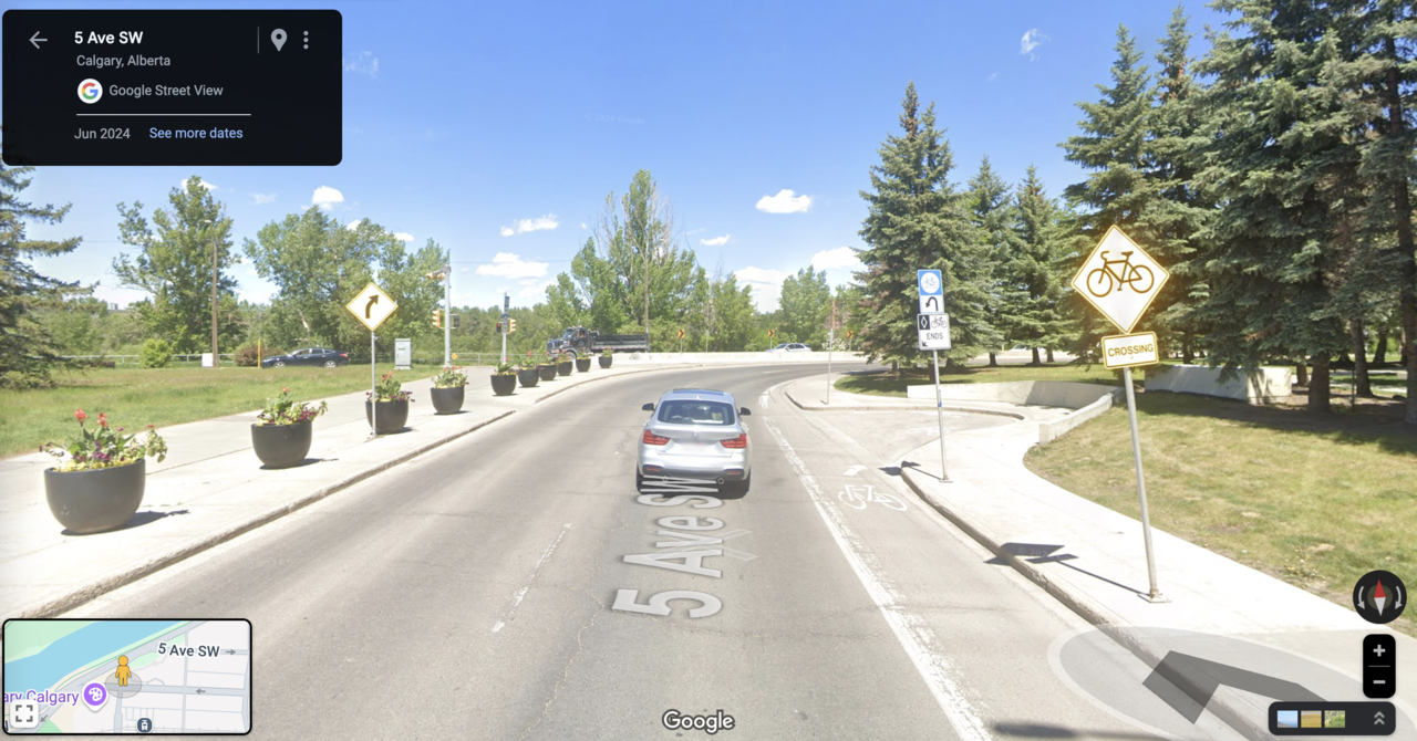

Who has the right of way here? (note the curb ramp on the left side)
I found a Transpo Alberta document explaining the standards to install this sign, but I haven't found anything to clarify the rules.
City website has a slightly different sign, though it seems to be for a crosswalk situation...is this a crosswalk?
https://www.calgary.ca/roads/safety/bike-signage-signals.html

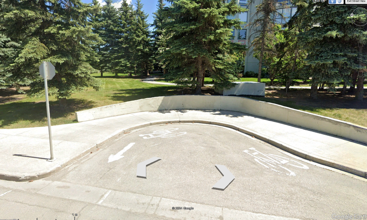

It's a road intersection. The cars have the right of way, the bike route has a stop sign (not visible from the road, but the shape is):
Not that I ever use this; in my experience I always hit a red on 7th. Once I cross 7th on the green light, the light at 6th is always red, so I (and most cyclists I see) cross in the crosswalk to the west curb by Contemporary Calgary, then cross straight north with the light in the crosswalk on the left side of the road in your picture above. I'd rather ride in front of turning traffic in a crosswalk than take my chances riding across 2 lanes of fast traffic midblock in a completely novel situation without even the right of way for my widow to point to.
I used to ride 11th every day, but got tired of nearly getting hit by drivers swerving through the bike lane to get around turning cars that I refuse to use 11th now. When I did, I never once used that useless piece of infrastructure (nor did I ever see anyone use it), I always crossed in the crosswalk that actually connected to the pathway system. You can tell this was designed by someone who never cycles lol.

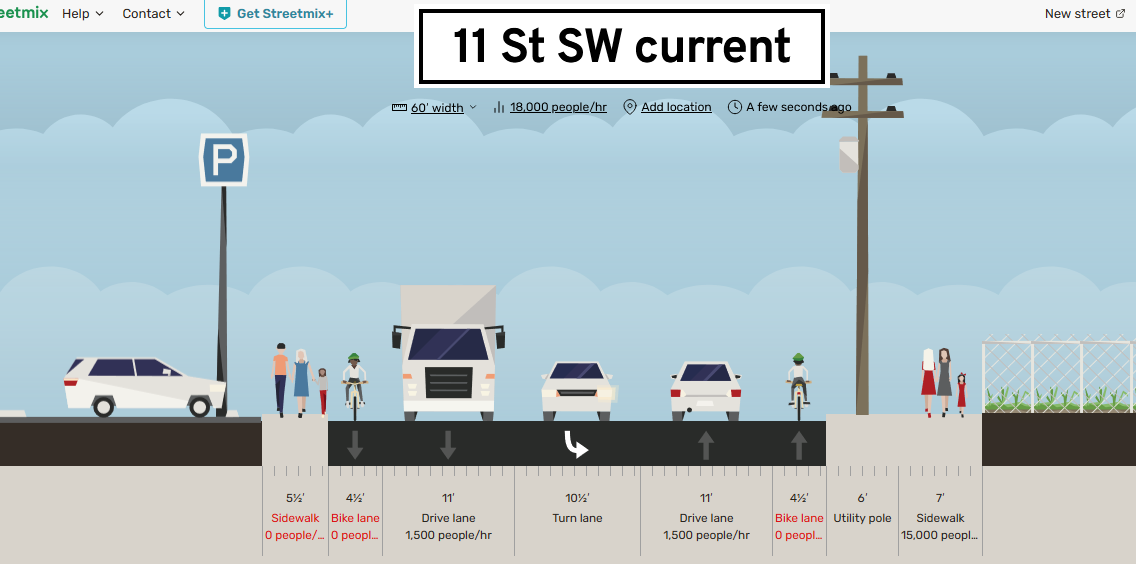

I bolded the important part. Here's the current conditions at 10th Ave

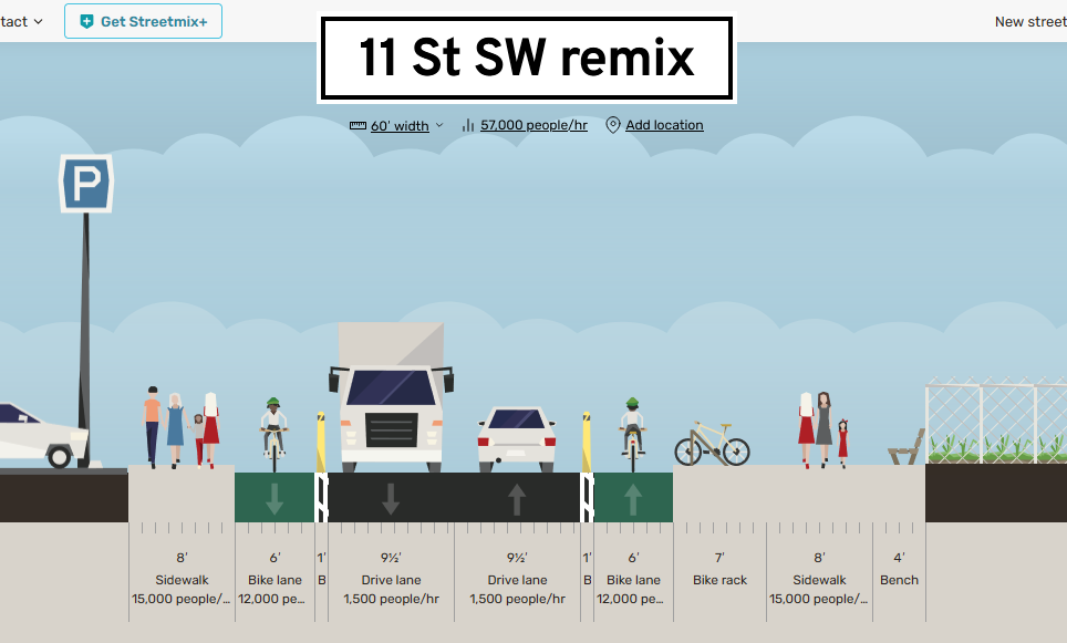

And here's a better version that accommodates cars, cyclists (and other wheelers) and pedestrians equally, specifically 20 feet each.
And here's a better version that accommodates cars, cyclists (and other wheelers) and pedestrians equally.
Sort of. Pedestrians and cyclists can just scoot around someone waiting to turn left in front of them, unlike cars, trucks and buses on a two lane road with hard barriers.

I think there is enough room on 11th to have a single through lane in each direction as well as a turn lane. The option above includes 7' for bike racks and 4' for benches, but these aren't required for the entire length of the street. IF there is a retail use or a park that fronts onto 11th then sure, bike racks and a bench would be nice. The city forces developers to include this stuff on DPs now, so if a use is proposed that warrants bike racks and benches, that's going to be on private property anyway. A more accurate picture would be light poles, transformers and pull boxes in that space lol.

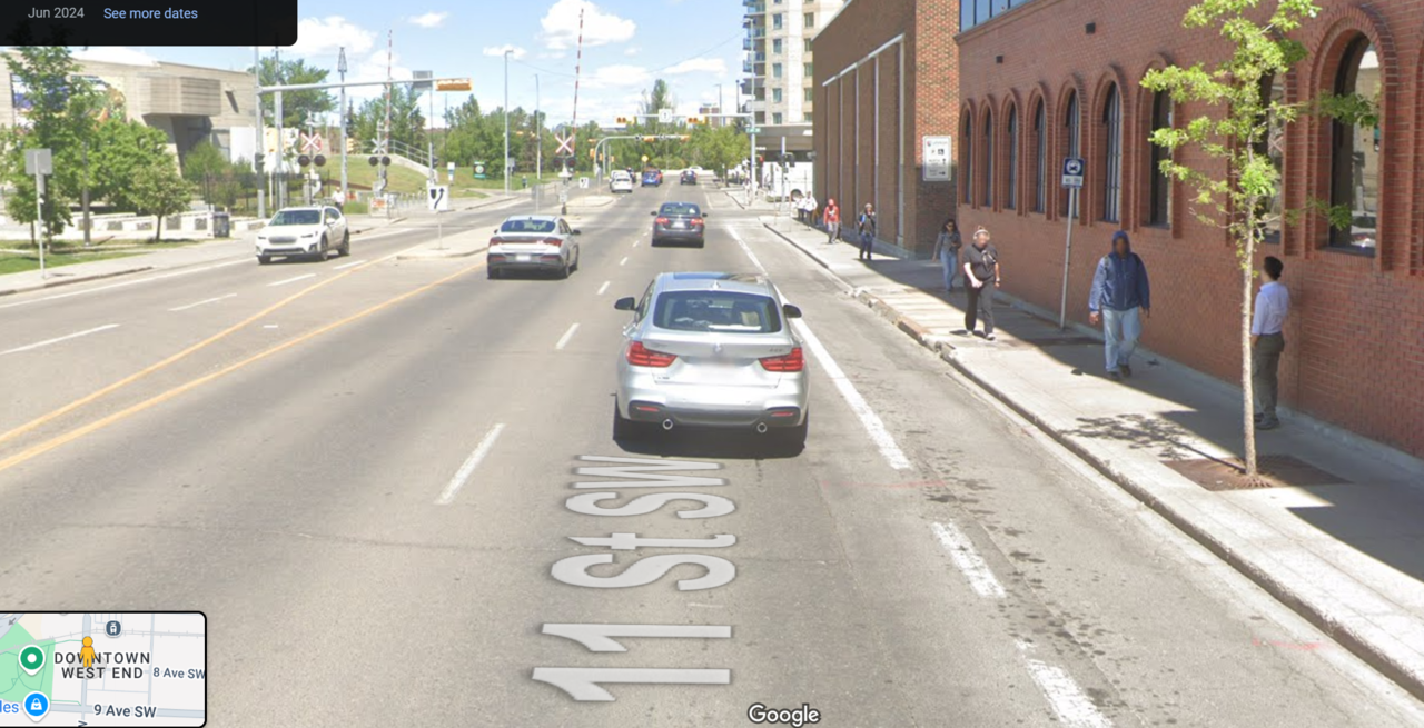

I wonder what this area adjacent to the LRT Station would look like.
I would put the east sidewalk as one of the Top 5 most woefully designed and undersized sidewalks given the context and demand for space given the thousands of LRT users walking through on an less than a metre sidewalk with tree wells and crappy concrete falling apart, in a vehicle splash zone. And a bus stop on top of that - imagine if there's snow here!
As usual, the big space hog is for vehicles. The LRT and the avenues add a bunch of complexity here, so essentially as a driver or pedestrians you are guaranteed to wait for a long or super long red light somewhere between 9th and 6th Avenue. This creates a pretty substantial congested feeling, but it's only made up of a dozen or so cars - probably the long signal times is triggering engineers to want more queuing space for idling vehicles Meanwhile, strollers and LRT uses are jostling and waiting to pass single file for a block nearest to all to wait for 4 minutes to cross 9th or 6th Avenues. All this is complicated by the volumes of the E-W avenues being their highest in the area, therefore giving 11th such a low priority in comparison, therefore long signals, therefore larger queue lanes, therefore no space for acceptable sidewalks ... etc.
The street has other quirks too. This SB turn lane onto 9th Avenue is wild - a full block queue for one of the least likely turn movements in the city. The LRT arm is for some reason in the middle of the road, making the area with the smallest sidewalk also have an in-ordinately large median space to protect the arm mechanism.
All in all, the movements of vehicles connecting to Beltline is pretty low on the list for me - it's a nice-to-have, but not a need and there's several other areas of the street (the sidewalks) that are so deficient that they should take significant priority over the other issues. Although cars to the Beltline also don't seem to be the materially significant issue here either - there's plenty of other design trade-offs that screw over pedestrians on the corridor, with or without 11th connecting to the Beltline.
