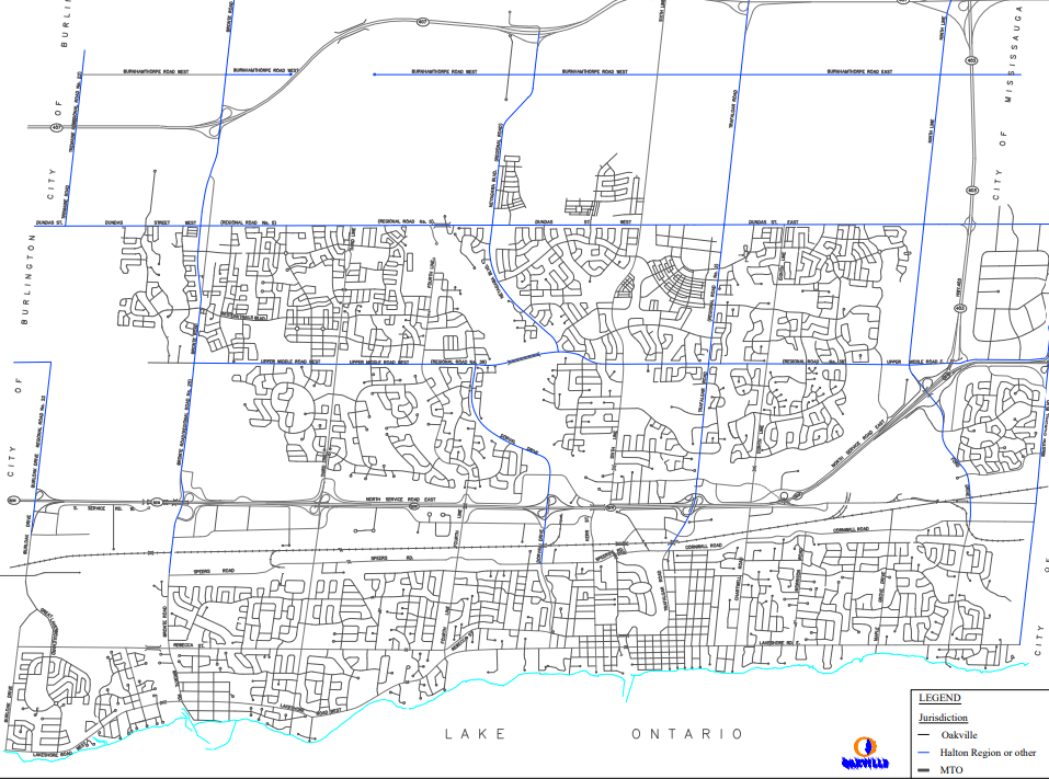

Just because you mentioned it, I wanted to dive into Oakville because I have never thought of it before. Data is from this report ( 2015 Traffic System Report ) - Oakville claims to have 1,900 lane-kilometres of roads and 125 signalized intersections. Oakville is a famously sprawly car-dependent suburb in the GTA that saw it's rapid growth phase in the car-friendly 1970s - 2000s, much like most of suburban Calgary.

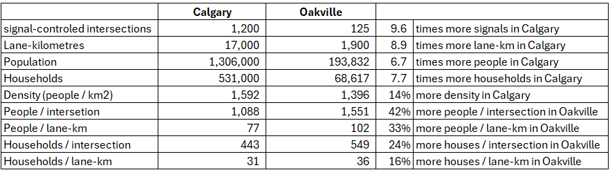

I was curious on how we compare to Oakville, so for some surface level analysis, let's run the numbers. I'll do my best to line up dates, but this information is from a few sources and a few different years. So take it as reasonably, but not perfectly accurate hot-take based on some googling. Calgary's numbers are from 2021 to 2023, Oakville is 2015 and 2016 depending on the source. Here's the comparison:
So clearly, just being car-dependent suburb isn't actually enough - by these measures Oakville has fewer lane-kilometres, and fewer signalized intersections per household (and property taxpayer). So at the surface level, Calgarians are supporting more road infrastructure per house than Oakville-(ians?). What's going on here?

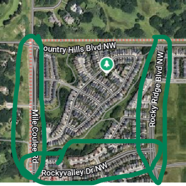

As an example, I found a dozen wasted lane-kilometres right here in the far NW in Rocky Ridge - none of these roads need to be 4 lanes. None of the right-of-ways need to be preserved - future expansion in this direction is not feasible and it's low-density acreages of Bearspaw everywhere north and west of here. Apart from rigidly applied generous road width standards, there's no reason for all this infrastructure that Calgary taxpayers will maintain in perpetuity:

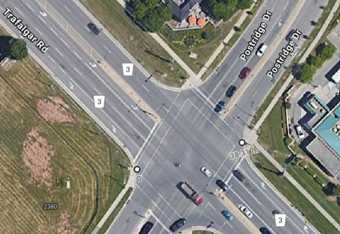

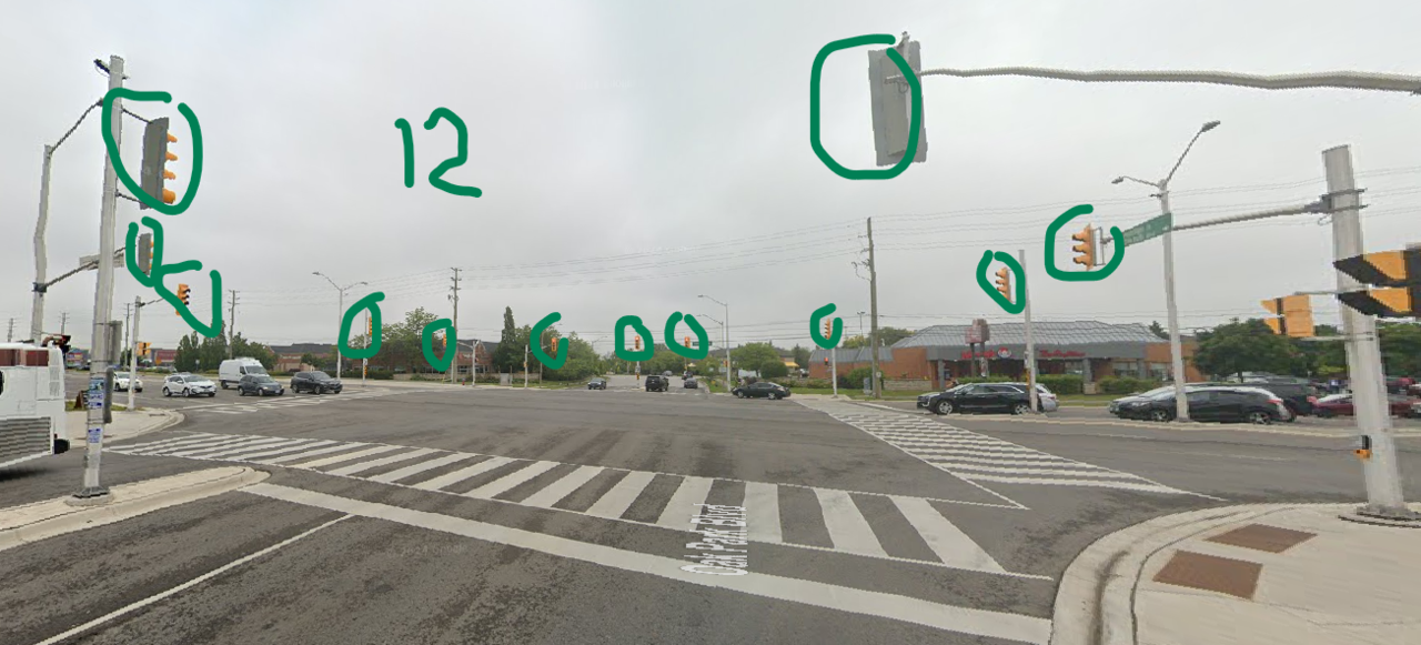

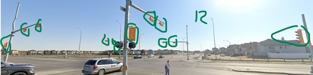

The other one is the size and complexity of intersections considered "normal". Here's a big 4-lane meets 4-lane intersection in Oakville - about 38m diagonally across, turn lanes on all directions. 12 total traffic lights - and importantly - no right-turn slip lanes:

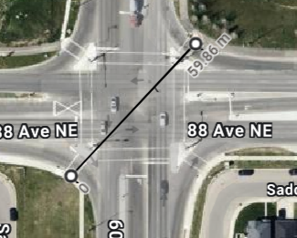

Here's a reasonably similar Calgary one (88th Ave and 60 Street NE). It's about 60 metres diagonal when accommodating the lanes for right-turns. Interestingly, it's got a few single lanes that are double-wide (assumes future dual-turns) and while it doesn't have protected turns yet in all directions has 12 traffic signals too.
Of course, it has the Calgary-classic right-turn slip lanes on every corner - this balloons the paved surface amount, but also adds complexity and cost - all those additional curbs to build and maintain!

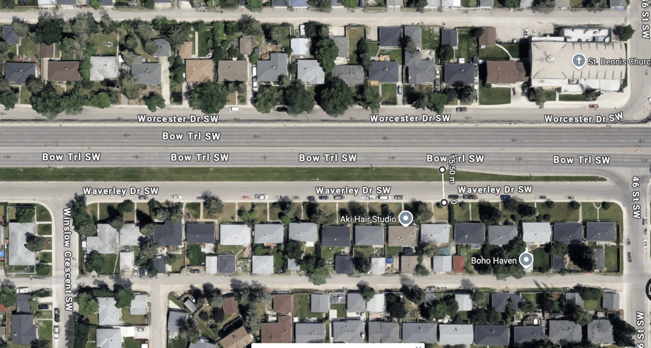

A lot of good stuff to unpack there. One thing that comes to mind is how many residential roads we have running parallel to arterials

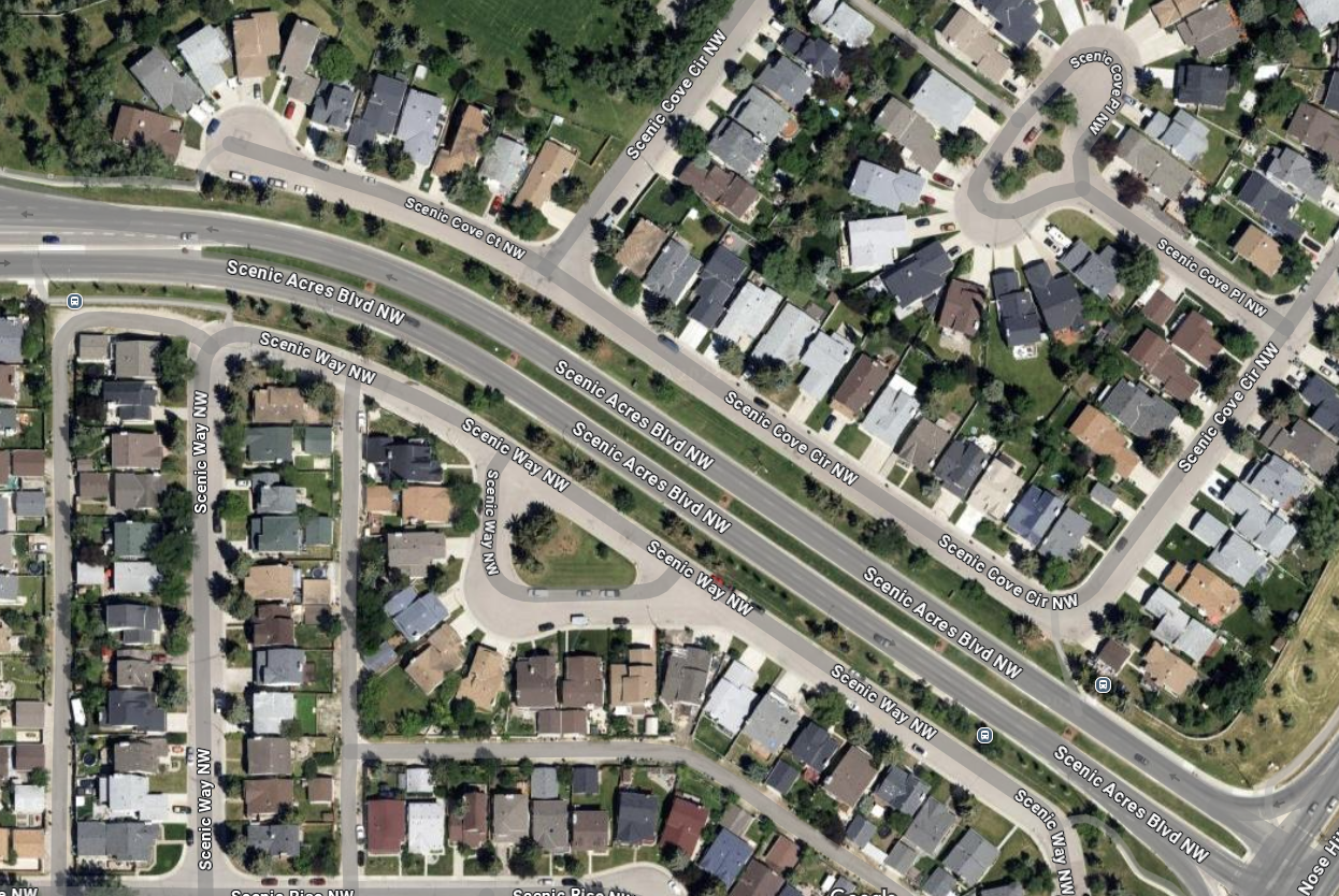

So in addition to 5 lanes/20m wide Bow Tr, you've got another pair of 7-8m wide roads and 6m of grass median (and a sound wall on the other side). Because who wants to live right beside a 60 limit road where people often drive 70kph when its clear enough?
Or you get areas like this near where I grew up:
Scenic Acres Blvd never has much traffic, and is only 50 km/h, but it obviously needs 2 lanes in each direction, PLUS slip lanes, PLUS 2 separate ultra wide residential roads on either side. The amount of excess is quite ridiculous. I've often thought it could be a good idea to reconfigure this whole stretch and add a strip of townhomes (it's walking distance to the LRT even!)
Ahh, the arterial road to nowhere, the 80's must've been a fun time. This road dead ends after one kilometre. There is so much opportunity to reimagine these roads through this age of communities. Removing the centre boulevard, keeping the same lane diet but tightening up the lanes to 50km/h widths and you have a large green corridor through the centre of a community. In some places it would be very easy to create space for homes. You do one or two of these a year and after 10 years you've made some headway.

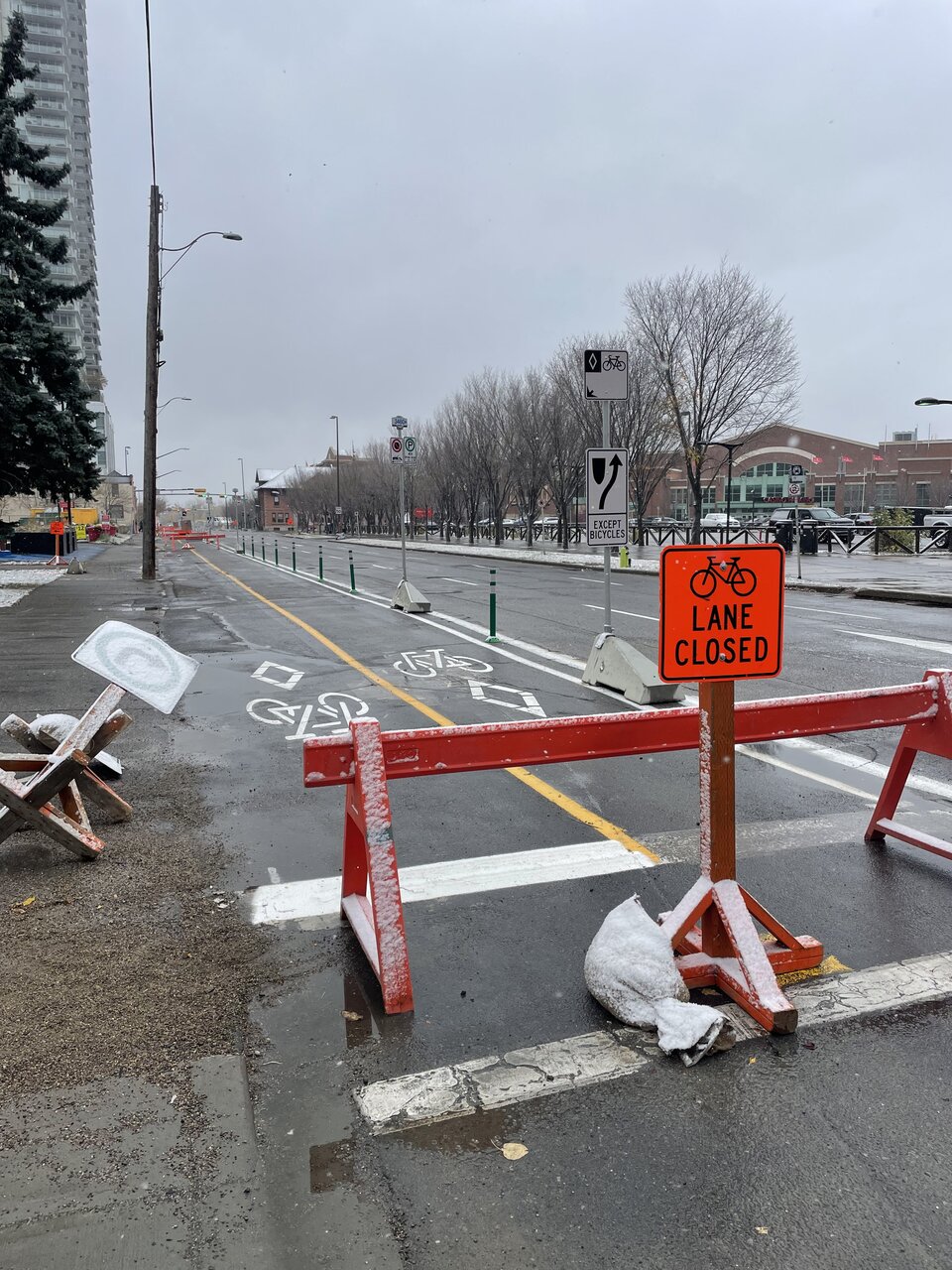

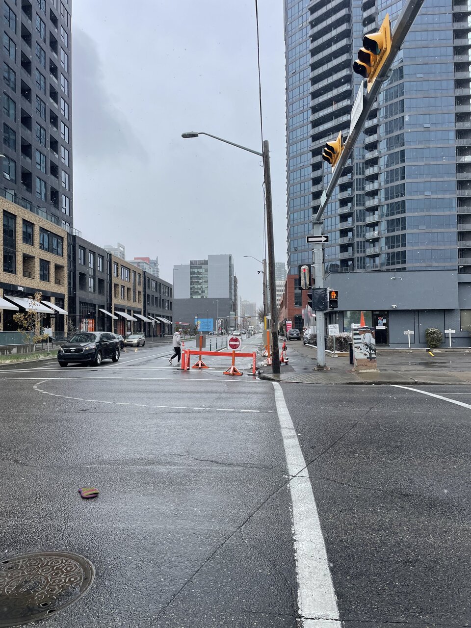

12 Ave cycle track east of Macleod about to be reopened, they’ve repainted the lines and returned it to one-way traffic. Also a pic of my beautiful girl on the Lindsay Park path 😅
