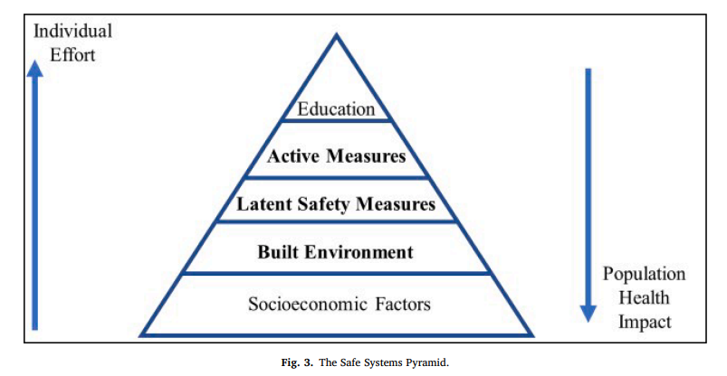

I disagree. Bad drivers are a symptom of the problem, but trying to solve it at that level is doomed to failure. "All we need to do to fix this is for every single one of a million different people to each individually increase their skill and effort just because it's the right thing to do" is a wish, not an answer. Better driver training is good, but unless you're into politically impossible territory, it will marginally improve the small subset of drivers who are newly licensed for a few years until they learn bad habits or get lazy.

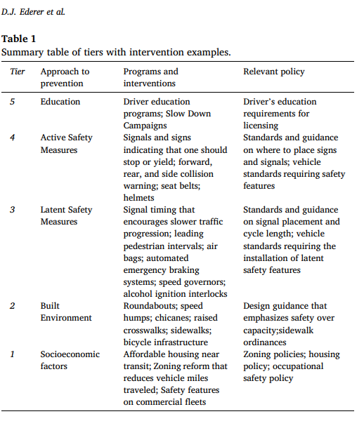

I've really liked the recent Safe Systems Pyramid by Ederer and others which takes a public health approach to road deaths and injuries; the most effective measures are the ones that reduce travel entirely, followed by ones that work automatically on everybody, followed by ones that work for some people or semi-automatically on everybody, and so on until you get to measures that depend on every random person to do the right thing.
Looking at 10th Ave / 14th St as an example, there already some positive socioeconomic factors happening (increasing housing in a location that supports less driving overall).
The built environment is interesting. The curve radius is not ridiculous. Raised crosswalks could keep vehicles back from the crosswalk; 14th St has unsafe excessive lane width, and that could be removed in the short term near the intersection with flex posts or a sidewalk widening (at least to the point where it becomes an underpass); in the long run you could add a bike lane to either side through the underpass, ideally by widening the sidewalk level. These would slow all the traffic in the area.
The big obvious change is on the latent safety factor side; ban right turns on red and probably have at least a leading interval for pedestrians. The ban is arguably an active safety measure -- if it's unenforced and specific to this location. If there's automated enforcement and/or the ban is systemwide, then it becomes more latent.
