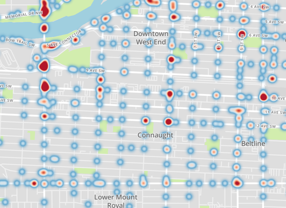

Here's the latest heat map of collisions, all the regular collision data caveats apply (we don't count near-misses, unreported collisions, the severity of the injuries isn't tracked etc).
By inner city standards, 14th Street SW does stand out as a corridor with more collisions and a history of collisions are every intersection.

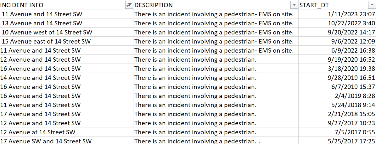

Here's the data that is labelled with "Pedestrian" from the dataset from May 2017 to current. 15 total collisions on 14th or immediately nearby. 5 flagged with EMS on site - 10, 11(x2), 13, 15 Avenues all since June 2022. Perhaps a data issue where EMS was only flagged after a certain date? Not sure.

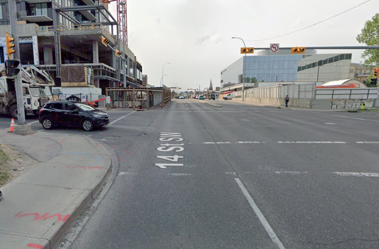

I walk down 14 Street SW about 5 times a week from the river to 15th Avenue. By far the most dangerous is evening rush hour. A similar pattern replicates on most corners, but 10th and 14th Street is the most noticeable. Non-scientifically, I would guess 75% of cars turning north onto 14th Street SW from WB 10th Avenue do not look for pedestrians, roll the stop to make a right-turn on red, or block the crosswalk waiting for a break in traffic.
I diagramed below, green is pedestrian movement, red is cars. Highlighted where I have almost been hit repeatedly:
In my opinion, partially it's a sightline issue due to the rise in 14th Street to the south and the construction scaffolds blocking view to the south that encourages cars to creep out over the sidewalk looking left but not right. The exacerbating issue is a formalized right-turn lane and 14 Street's conversion into a semi-expressway features just north of here and the narrow, crap state of all sidewalks in all directions and poor lighting. All in all, about as dangerous of an intersection that we have in the inner city, it encourages dangerous driving, and is likely only not worse because congestion is bad enough speeds are lower than they otherwise would be.
A similar problem occurs with right turns from 11th Ave to 14 Street NB. 12th Avenue is more interesting as it's often intersection-blocking traffic trying to make the light, plus aggressive last minute turns onto 12th Ave from 14 Street SB and 14 Street NB. Most corners are wide and sweeping to encourage turns at speed, including right-turns, and everywhere paint is missing and sidewalks are poorly lit and in bad condition.
I could go on, but I have seen enough in person and enough in the data to suggest this is a dangerous road for pedestrians. It's probably more unsafe than many other roads in the area. Should we do anything about it? Well that depends on if we want to prioritize high-speed, no-look right turns on red for commuters or people's lives.
