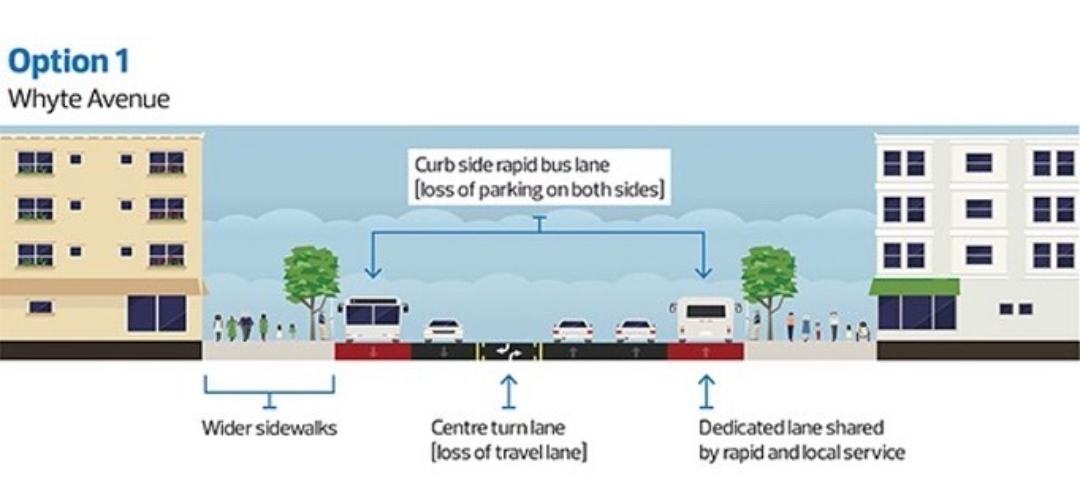

I thought I'd share this post from Miscellaneous Projects:
engaged.edmonton.ca
Mass Transit: Network Implementation for 1.25 Million People
We want to hear from you about transit in your community! Edmonton needs a robust transit network that connects to all areas of the city, providing Edmontonians with access to safe, convenient and reliable service. The foundation of any transit network is mass transit.
engaged.edmonton.ca
engaged.edmonton.ca
I think that Calgary Trail/97 Street could work, and it would be a vital north-south route. I think that the intersection at 97 Street/118 Avenue could be a bottleneck.
Option 2 all day for all the areas.
I see option one being treated the same way bike lanes are now. Used as a loading zone / street parking, windrow.
Imagine winter… it would be a mess
Id rather see transit lanes run down the middle. Better separation, better signal priority, easier to make turns. Its just, higher quality.
I’m curious if there’s a potential for a rail conversion in the next LRT buildout. (~30+ years/HLB replacement) they would be steps ahead if it was possible.
I think Option 2 might work better, given the businesses or residences along the sides. I posted a Google Map link to Calgary’s 17 Avenue SE.
