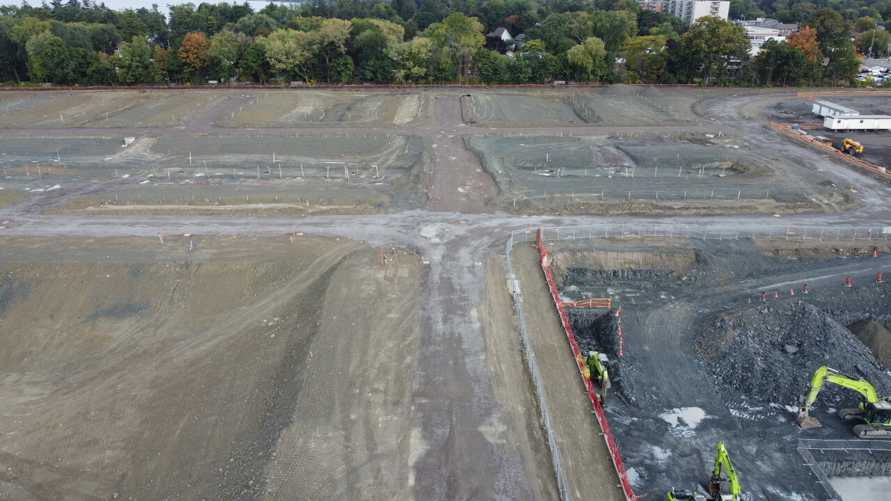

Those curb radii. Looks like we still are not learning, even in essentially greenfield high density neighbourhoods.
Mississauga has always been particularly terrible for that kind of thing. It's especially crazy here as these streets will see effectively 0 truck traffic - the typical excuse for wider radii. No reason these can't be much smaller intersections.
There's going to be more truck traffic than you think. The property does have a commercial aspect so you will see tractor trailers making deliveries to the new LCBO, a new school is planned so there will be school buses to turn and what about snow plows in the winter and garbage/recycling trucks? How about fire trucks? Even a 28 foot straight truck can be challenging on narrow streets and if you combine that with pedestrians buried on the phone while standing right at the edge it is no wonder they can be clipped by right turning trucks.
There's nothing stopping anyone from using smaller vehicles. The notion that you need a tractor trailer to make a local delivery to a neighbourhood LCBO is, frankly, ridiculous. 28-foot firetrucks are also too big for dense metropolitan neighbourhoods.
It's time to adapt our vehicles to our neighbourhoods instead of the ridiculous notion that neighbourhoods must be built to accommodate impractically-sized vehicles. It's pedestrians (e.g. everyone) who suffer having to cross large windswept vehicular spaces and people in general who end up suffering from the effects of overly wide roads and the resulting lower density--fewer places to walk to, less affordable housing, higher property taxes, and more speeding and dangerous driving.
There's really no pedestrian safety advantage to it, either. The typically large turning radii in Mississauga and in many parts of Toronto increase the amount of time that pedestrians have to spend on the roadway at intersections. They therefore increase the chances of getting hit by a vehicle. Since drivers can make a turn at a higher rate of speed when there's a wider curb radius, there's an increased risk of serious injuries to pedestrians, as the risk of serious injuries increases with vehicle speed.
If Mississauga and Toronto are serious about the quality of their roads, they need to decrease the turning radii at intersections and narrow their streets in general. There are neighbourhood streets in Mississauga where a two lane street has enough space for 5 or 6 cars side by side. It's excessive, and it's the result of a mentality where every street has to maximize driver convenience and accommodate oversized vehicles before anything else.
That's no different than any urban neighbourhood, and honestly most of that traffic will stick to the block immediately south of Lakeshore.
The turning radii here look more appropriate for semi-trailers, not local delivery trucks and garbage trucks. 6m radii corners can accommodate these vehicles - the radii of those intersections looks closer to 12m.
You can't drop 0m radii here, no, but the size as constructed is well in excess of provincial minimums or even what is typically required for residential streets almost anywhere else in the GTA. This has long been the case in Mississauga as well, which generally has wider streets with larger turning radii than basically any other municipality. It's hugely expensive for the municipality to maintain all that extra asphalt and produces nothing but more dangerous, anti-urban roads.

The province recently changed the OTM to reduce required turning radii. I can tell you right now, those are MASSIVE turning radii for a pedestrian focused private development site. Perhaps Mississauga has large turning requirements, but I'm almost sure I've seen smaller turning radii. I know in Hamilton they've slowly been retrofitting smaller turns into old intersections designed seemingly for planet Earth's largest trailer trucks.
Some turning radii here are truly tiny, like almost European level small where you can't make a turn in a pick up truck if someone is stopping at the stop sign. It's beautiful.
