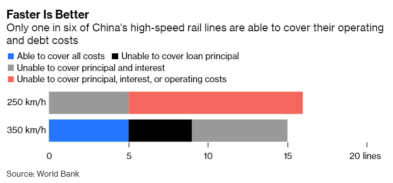

A 2.4 to 2.7 exponent would also be wildly inconsistent with the World Bank’s 2019 China HSR report:
"The capital cost of a 350 kph line is about 18 percent higher than the 250 kph line"
A World Bank project report on a specific Chinese line points in the same direction: "At completion, the Project’s total cost was RMB31.2 billion, representing a 10 percent saving compared to the cost estimate of RMB34.65 billion in the Feasibility Study Report. The lower cost at completion is due to the revised design, which reduced design speed from 350 to 250 km/h, simplified construction by separating a very long tunnel into a series of shorter tunnels, increased ruling grade, and used ballasted instead of slab track."
Alto will be using ballasted track as well.
Therefore, the 2.4 to 2.7 velocity exponent claim is
unsubstantiated drivel.
And if this obvious category error was made, I wonder what else from Citizen Research was just amateurish armchairing dressed up as rigorous analysis. Assuming this claim is true: "Our research"

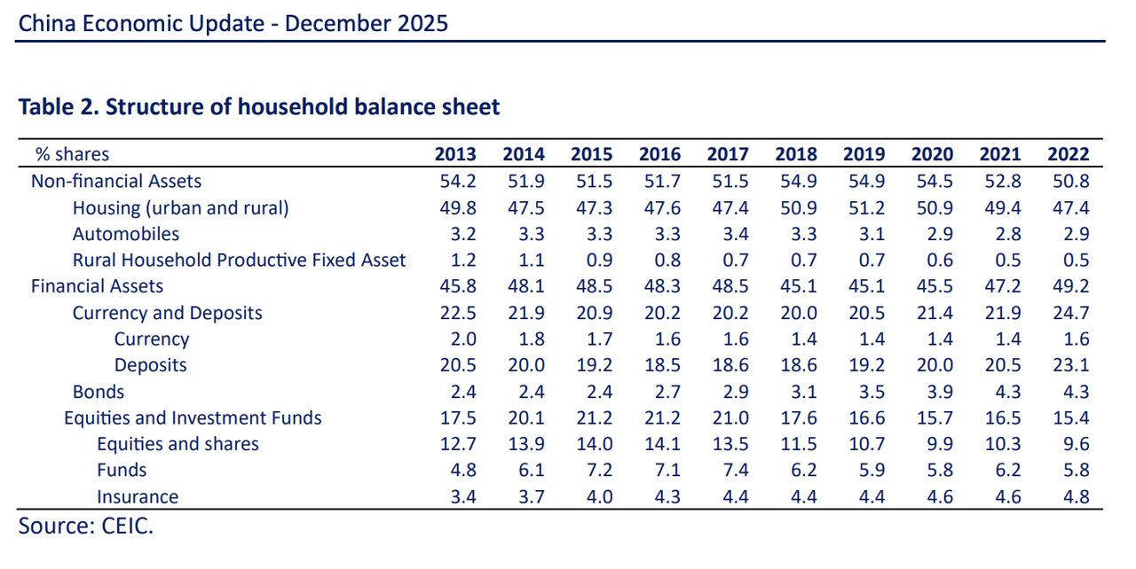

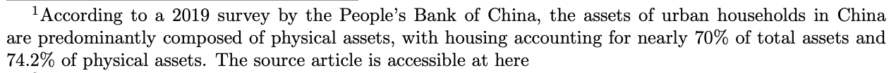

Are you unaware of where much of China's wealth got locked up during the last 2-3 decades?
World Bank’s 2025 China update says housing was 47% of Chinese household assets in 2022.
For urban only, BIS cites a 2019 People's Bank of China survey saying housing was nearly 70% of total urban household assets.
Conversely, Stats Canada says household residential real estate was $8.4506 trillion in Q4 2025, household financial assets were $11.9548 trillion, and financial assets were 120.7% of non-financial assets. That implies total household assets of about $21.86 trillion. Real estate being 38.7% of household assets.
https://www150.statcan.gc.ca/n1/daily-quotidien/260316/dq260316b-eng.htm
