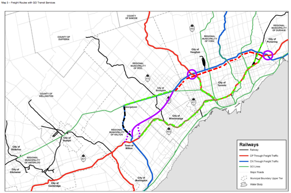

The freight bypass would benefit BOTH the Milton Line and Midtown Line by removing CPKC and putting it on the new freight bypass in Peel/Halton, and adding track to the existing CN York Sub (with I assume rail interchanges for the MacTier Sub and the yard in Agincourt). It would ALSO benefit the Kitchener Line and the pinch point between Bramalea and Georgetown. The Ford gov declined to pursue after being elected the freight bypass option that only involved CN and only benefited the Kitchener Line.

It's one bypass that would serve both CPKC and CN.
My annotations:
Purple: new track for bypass for CPKC and CN.
Dotted purple: options for CPKC to join Galt Sub
Purple circle: interchange tracks for CPCK
Dotted red: CPKC joins the York Sub
Dotted green: more space improved and new GO lines
Dotted black: redundant CN track
My annotations:

In order to see this happen, CN would have to be okay with allowing CPKC trains to pass infront of their Intermodal yard in Brampton and their MAC yard in Vauaghan.
CP trains would have to be entirely segregated from CN trains. They wouldn't be allowed to share the same tracks. It would negatively impact CN's Intermodal operations.
CN regularly moves trains between Brampton and Malport.
This is why I propose the 413 route for CPKC.
My annotations:
Would enjoy seeing the @Willybru21 version :)

Here's the issue with allowing both CN and CPKC to share the missing link. CN will be asked to allow CPKC trains to run right through the middle of their intermodal operation.
The yellow line represents "The Missing Link". CPKC trains will run right in between CN's Brampton Yard and Malport Yard.
