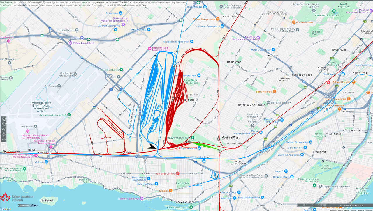

Would it not be possible for both CP and CN to have separate parallel bypasses along the 407, each with their own set of tracks, between Milton and Bramalea?
Between Milton and Bramalea, allowing both CP & CN to run parallel freight lines would be problematic once the CP track gets to CN's Intermodal facility near Airport Rd. & the 407. Perhaps CN and CP could work some kind of a deal out and have their tracks setup in a similar fashion as in Montreal. CP's tracks run elevated over the tracks heading towards CN's main yard in Montreal.
If CN agrees to share the missing link with CP, then CP trains absolutely cannot interfere with CN's intermodal operations. CP would have to construct either an overpass or an underpass for their trains while passing tracks heading to/from CN's intermodal facility. Same for CN's Mac Yard in Vaughan.
Also another point of contention is the currently under construction Goreway Dr. bridge. It's only being built wide enough to accommodate the existing CN tracks to go underneath it.
Map of tracks in Montreal. I put an arrow showing where the CP tracks go over top the CN tracks heading into CN's Montreal yard.
Image from Google maps
