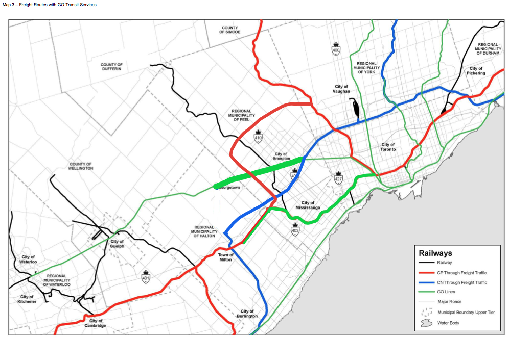

A bypass from CPKC Milton West to CN Halwest along the 407 corridor would be about 29.5 kms (18.4 miles). Then it's 11.1 miles alongside CN to Snider, 25.0 miles to Pickering Jct, and 11.8 miles to rejoin CPKC at Oshawa East where the lines come together. That's 66.3 miles, where today via CPKC it's 27.4 + 5.9 + 31.1 = 64.4 miles. CP will not be happy to add two miles of track with added long term fuel and maintenance costs. CN will not be happy about the appropriation of an asset that they own as private property. Both will fight bitterly against the idea that government holds the control on their assets.
Where this gets silly in my view is the premise that this will lead to CPKC yielding the whole line across North Toronto and GO immediately building a cross town line. There is first the reality that CPKC needs to get from Vaughan to Oshawa to head eastwards, and a tight curve to the bypass at Woodbridge may not be doable. Then there is the reality that even if CP had the ability to cease using the Mactier and North Toronto and Belleville Subs through the city, and repurpose its Agincourt Yard, the market value of that asset as developable real estate is well beyond what Ontario can afford to buy for a transit line. So, no.... I don't believe that this is laying the ground work for a North Toronto GO line. That idea may have been studied, but IMHO it's not affordable and won't be needed for decades, if ever.
To my mind, the compelling rationale would be to place CP in a bypass so that the Milton- West Toronto line (and only that line) can be converted to 2WAD without adding trackage(especially over bridges) or having to buy adjoining land to achieve a 4-track right of way that achieves 2WAD as well as preserving CPKC's needed freight capacity and potential growth. Maybe that cost comparison is compelling, maybe it isn't. ML probably already knows, and as I said Ford is simply pasting a new cover on what has already been studied to death. And debated to death here.

GO doesn't run on the CP tracks through Weston. It's entirely freight now. If you divert the CP tracks (presumably along the 407 from Milton) and then up the 413 to MacTier, you still have to come down Mactier, through Weston, to The Junction to change to the North Toronto sub to get to the Belleville sub.
GTA track map with both 407 freight bypass & 413 freight bypass.
413 CPKC Freight bypass
Oh fergawshsakes.... I hope those are your creations and not an official proposal ????
The idea of adding a transit corridor to the 413 to make it more palatable sounds like.... a Ford tunnel idea. Or a ferris wheel.
Putting a freight line there, and asking CP to add those miles of roundabout (and feet of vertical elevation) when it currently has a through route.... not gonna happen.
But so very Ford.
Now you are confusing me. You literally show the CP mainline going through Weston. Not only for the east-west traffic but now for all the traffic to the north.
And I see no point of this CP diversion - as you still have CP sharing with GO from Milton to the 407.
I mean it doesn't have to be exactly as I've drawn it. East of Campbellvile, build a rail bridge going over the 401 and run CP's mainline north of Milton along side Campbellville Rd/ 5 side Rd. and then turn North to go up between Georgetown and Brampton?
