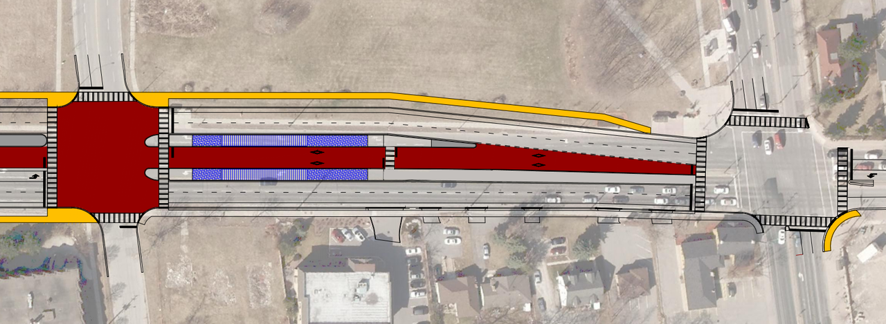

I think reconstructing the intersection is the only solution here and it doesn't even have to be much. To obtain more space, the northbound left turn lane can be closed and traffic can turn one light earlier at Hopkins Street with a new traffic signal added at Atkinson Street to turn onto Major Mackenzie Drive. This would allow for a single pedestrian path on the east side of the lanes in the median to be built. Southbound passengers can cross the bus lanes from a pedestrian crossing at the north of the station, where busses will yield.
it would make sense if the station was farther north, closer to MM than currently, but considering that the stop is pretty much at the intersection as you have illuistrated, ther distance and time required to get from MM to the stop is pretty much tyhe same for both cases.
I would suppose its now just a matter of conditioning the mind to realise that it will take similar time to get to the stop the correct way than to jaywalk to the stop from the top.
That sounds like an easy way to have everyone in Richmond Hill turn against you and tear you to shreds. I feel like the reason why the stop is built as it is is because I think they want to leave room for a potential underground tunnel under Richmond Hill Centre. A lot of older renders seem to consider this as a possibility:
Yeah no. That was a complete joke, even more so than Brampton’s laughable LRT tunnel. And besides, even if a tunnel were to be built in 30 years, moving a stop like that is basically a nothing cost in a ~1.3 km tunnel project. And in the meantime, every single person who transfers at that intersection has to waste 5 mins walking 200m for no good reason.
There is no justification for this incredibly dumb stop location. Making a horrible 200m transfer at a corridor where there are two important bus connections today and is literally planned to become a major transfer point to other BRT services in the future is completely asinine. It’s almost like if we deleted Warden/Golden Mile station on ECLRT and saying “yeah but you can get off at Hakimi-Lebovic.”
I suspect the reason is because there’s no space in the current ROW to widen the road north of Major Mack, and the government doesn’t have the guts to expropriate a few properties and would rather have transferring transit users walk 200m for no reason since NIMBYs will go crazy and transit is for poor people and broke students anyways. I mean, what can you expect from York Region... (Slightly joking, but seriously, this is horrible)
I don't think the suggestion is that controversial. It's not like I'm suggesting to remove left turns from the entire corridor and require U-turns.

No, I'm not saying they should have expropriated all of Downtown Richmond Hill to put in bus lanes. That would be ridiculous. All that needs to be done to make Major Mack station at Major Mack instead of 200m away is to have the buses merge into Yonge St. north of Major Mack instead of south of it. That way, there's room for the station at Major Mack. (Basically, it's just copying 19th-Gamble station).
Approximate expropriation required:
- slivers of maybe a dozen properties
- 2-3 buildings demolished/relocated

There are probably a lot of issues relating to heritage status there in terms of that plan.
Heritage buildings can be moved. Even in Newmarket on Davis Dr they actually moved a heritage house to make way for the BRT to nowhere. Heck, even the massive Kodak building got moved for Mount Dennis on Eglinton.That’s why I said “demolished or relocated”. Probably not cheap, but 100% worth it. At least better than spending millions to make transit worse for a significant number of riders.
It's different though... you're asking them to relocate not only an almost 200 year old building, but also its cemetery. Not to mention if you've every been there its not level grade; there's a mini embankment right at the intersection. So not only will you have to move the building and graves, you'll have to spend extra bucks leveling the land.

Lets just look at the Streetview for the area of Yonge immediate north of Major Mack on the east side.
There is only 1 building in this photo; I don't know if its heritage, can't say it looks the part; but there's nothing else there, and the building wouldn't have to be touched anyway, just an already molested frontage eaten into a tiny bit.
The same could really be said of the west side too.
Though I'll concede that the landscaping and retaining wall closer to Major Mack are attractive.
The wall could be rebuilt slightly further back at no loss.
To lose the trees would be unfortunate, and might be avoidable if the east side if fully utilized for net new space; but certainly could be considered.
On the south side of Major Mack, the south-west corner looks plenty roomy:
While the west side has only one building that might be heritage:
And it seems to have lots of room behind it to shift it, if desired:
