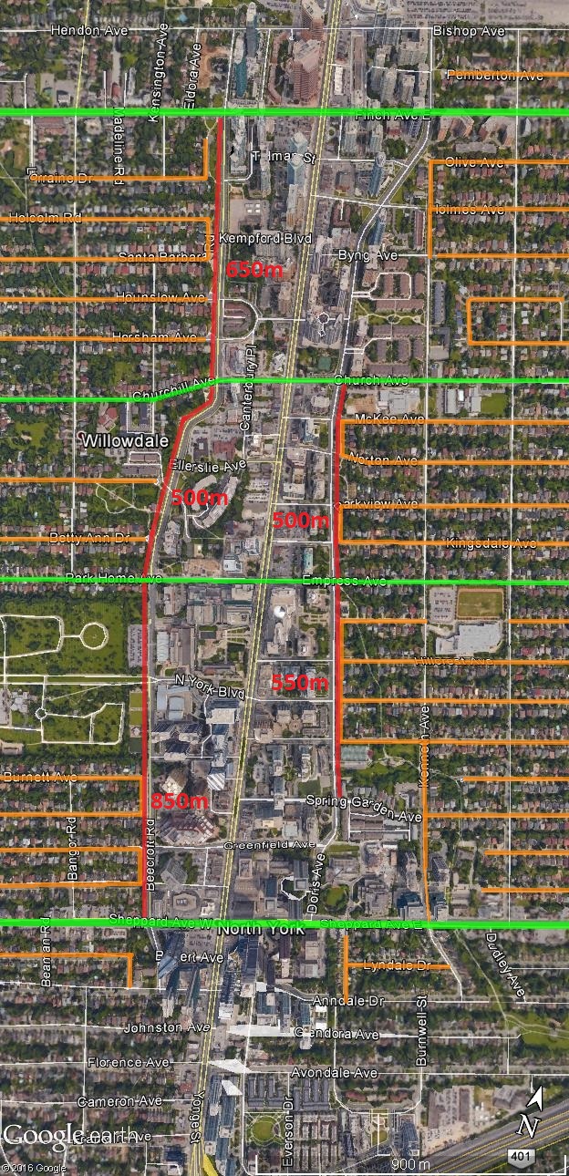

For that very reason, we should be putting cycle tracks on Yonge. We should be building safe cycling infrastructure on the roads that are the least safe - that's the whole point of cycle tracks. Why are we spending millions of dollars making something that - according to Sunnyraytoronto's usage statistics - is already much times safer than Yonge. Help those most at risk on Yonge, create better connections to destinations rather than "backdoor" access, and still connect to the Hydro Corridor, and Under 401 (which Beecroft would not actually connect to) while saving millions of taxpayer dollars.
Green painted CycleTracks don't make cyclist invincible.
Transform Yonge with CycleTracks will still have all the exact same high number of Cyclist-Vehicle Conflict Points (right-hook, left-cross, pull-out),... generally every 80m since east-west side street dominate local road grid system.
The only way to eliminate/lower these Cyclist-Vehicle Conflict Points is to dead-end side streets before they connect with Yonge,... as you can see, now both sidewalk and CycleTracks become more longer, more continuous and safer since vehicular conflict point eliminated!
Gee,... Wouldn't it be great if we can get the vast majority of these east-west side street to dead end before meeting the north-south street! Oh,... We already have that! Due to North York Centre's protective road grid system, 90% of all east-west side streets from the single residential house area between Sheppard & Finch already dead end or "loop-out" (in Orange) and thus never intersect with Beecroft Rd or Doris Ave! Result: 500m to 850m of long continuous safe stretches of sidewalk without Vehicular conflict points along west-side Beecroft Rd & east-side Doris Ave,.... So it's much safer to add Cycling Infrastructure here!
And since west-side Beecroft Rd is generally open greenspace with no-house/commercial fronting onto it,.... it means going Bi-Directional you can actually put in fully protective CycleTracks with guard-rails/Jersey barriers (which you can't on Yonge).

Regardless "Transform Yonge" or "Enhance Yonge", Yonge Street will be getting signalized intersections every 200m (new at Ellerslie & Horsham/NorthTownWay). These Yonge Street signalized intersection generally already or will have matching signalized intersection along Beecroft Rd & Doris Ave. So additional signalized intersection at Doris&Elmwood, maybe Doris&Bishop, maybe Greenview(Beecroft north)&Hendon,... timed light at Doris&Princess (EarlHaig SS & EmpressWalk jaywalking) timed wtih Doris&Empress
Thus, sufficient number of signalized intersection along Beecroft Rd,....
NOTE: Most of Beecroft Road signalized intersections are "T" shaped (vs "+" shaped) with no intersecting street along west-side of Beecroft, meaning, you can walk north-south "against red-light" here!,... that's why I'd perfer cycling infrastructure be West of sidewalk here onto open green space, so Cyclist don't have to stop at intersection!
