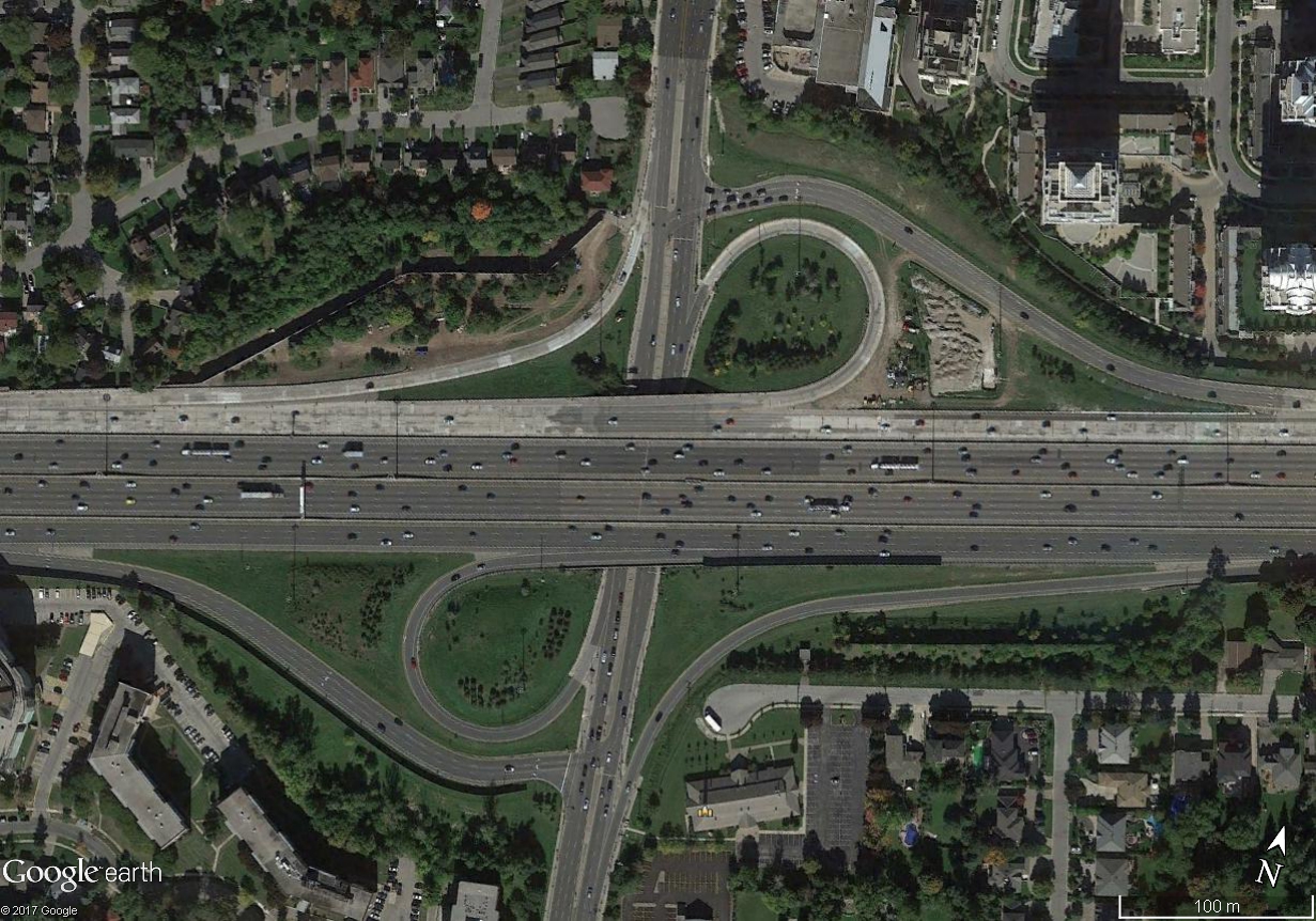

The picture also shows why EB 401-NB Yonge is configured as free-flowing: look at the traffic volume, vs. that of EB 401 to SB Yonge. It's also a reason why localizing Yonge in the NYCC stretch may not be the wisest idea. It may be to the best interest of condo dwellers, but Yonge serves a regional function, even though it's no longer a provincial highway. (before people jumping in to say Bayview can serve as the alternative, no it can't - the 11 Bayview buses already get messed up every rush hour by the long traffic queue around the 401 interchange.)
Yonge does serve some regional function, but not as access to the 401. Everyone who wants to take the 401 eastbound from north of Finch is already taking Bayview or Leslie. Even from Sheppard & Yonge, it's often just as fast to drive east to Leslie and take the 401 there (or go west on the 401, turn around at Avenue and take the Express lanes) because of the regular traffic between Bayview and Leslie on the 401 Collector lanes.
Agreed, but taking Bayview or Leslie would only work if they are going EB on the 401.

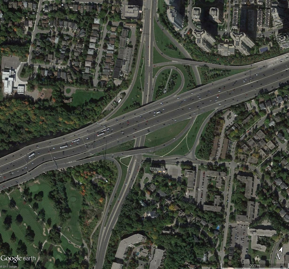

Here's some various interchange designs,... mark up right turn VS left turn VS straight-through,....
Partial Clover A4 at Bayview-401:
Full Clover at Lawrence East - DVP:
Typical American Diamond at Lawrence West - Allen Rd (NOTE: two very inefficient 3-phase signalized intersections):
Our odd Yonge-401 ParClov-Diamond hybrid interchange:
