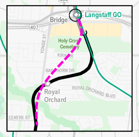

Wouldn't cutting through a corner of Holy Cross Cemetery disturb the (Progressive) Conservative voters residing there? :eek:
(Sorry, couldn't resist.)
Actually, this alignment was changed in the refined business case to make sure that none of it goes under Holy Cross Cemetery, which is part of the reason why the final Option #3 alignment is even curvier.
That's something that confuses me: why is it a requirement to not go underneath the cemetery if it is constructed with TBMs? It's not like any corpses will need to be reinterred or if there would be any property impacts. A better alignment would be to cross the cemetery diagonally and then have the curve/portal in the Langstaff lands. E.g. like this in pink:
This would reduce the total distance tunneled and improve speeds... but might take up some of the Langstaff lands for the portal and result in the "Bridge" station platform in a trench.
It probably has something to do with it being considered disrespectful to disturb the ground where the dead live. Its the same reason why Vancouver can't built a skytrain extension to Stanley Park in any capacity since its an indigenous burial ground. In other words its an attempt to avoid further nimbyism.
Logically, this is so. Practically, you are digging under land owned by the Catholic Church and they likely have different views than you or I of how those corpses should be regarded and what they want happening underground.
Oh no, did you just try to use logic to point out that the massive S curve actually has a longer tunnel than the supposedly cheap at grade option? Next thing you know you are going to point out almost all the properties south of Langstaff road are empty so expropriation of land to build the station on the cheap south of the roadway is possible, and that Langstaff Road is going to need a bridge anyway so the subway could be in an open trench at that point. Why don't you just point out that the stations planned are closer together than King and Queen stations downtown but with a massive highway and hydro corridor guaranteeing no similar density of development while you are at it?? :)
