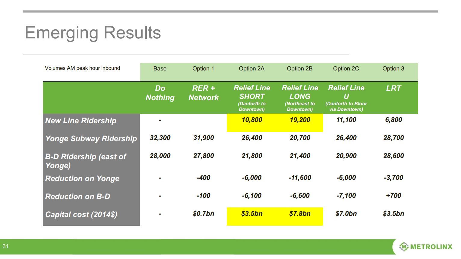

We cannot continue with the Yonge North extension until after the Relief Line is built to Sheppard-Don Mills. As shown by the Metrolinx study, it is the ONLY way to adequately provide relief to the Yonge Subway. With 11,600 riders taken off of the Yonge Subway, we can (and should) proceed with the Yonge North extension.

Yes the Yonge Line has no capacity and it will have some if the DRL is built to Steeles for a Decade or 2 at best depending when it happens. Depending when the DRL reach Sheppard (prefer Steeles) it will be back to today problem or has increase to the point that will require a 2nd subway on Yonge. It will be more an express line and travel down Bay St south of St Clair since none of the existing Yonge stations will be able to handle both lines.
Unless the Relief Line goes to Steeles, not going to help the Young Line. Going to Danforth does nothing for the Young Line. Going to Eglinton will help some, but not like going to Sheppard.
Given all the development taking place on Young St today as well on the books, the Young Line will be over capacity for the rest of everyone life. If one looks at Yonge Street from Steeles to Queens Quay closely, they will see density within one block of Young St requiring a 2nd subway line by 2050 or sooner.

No, you are absolutely right I believe. It is one of the biggest benefits of the Yonge North extension.
It just won't be enough. The 38,000 Yonge line capacity number is citing 90 seconds frequencies already.

The Spadina extension is actually taking 1,200 peak riders off of the Yonge Line, largely because of how it will intercept the Finch West bust. The Finch LRT is going to feed into it. This is why the Relief Line to Sheppard is so important. Just like the Spadina extension intercepts the Finch West bus, the Relief Line would intercept Eglinton, Lawrence, York Mills and Sheppard buses.
The Crosstown is needed because Eglinton is hopelessly congested with buses and is in desperate need of a rapid transit upgrade. I checked and the VIVA Blue bus to Finch station travelling along Yonge south of Steeles has a weekday ridership of 16,600. That is cute.
Here is the reality on Eglinton:
Eglinton West - 38,100
Eglinton East - 28,100
Lawrence East - 33,700
Flemingdon Park - 15,100
All these routes (+5 more minor routes) terminate at Eglinton Station at present.
As for the Crosstown, it will allow for some load-sharing as riders coming in from the east will be allowed to transfer at Eglinton West on the Spadina line and head downtown. It will also reduce the load from the Bloor-Danforth subway (especially if Crosstown East and Crosstown West are approved) which will help somewhat with the crush point at Bloor-Yonge station, albeit by transferring that load to a new crush point at Eglinton Station.
Finally, the Crosstown largely consists of existing riders. The Yonge North extension brings in new riders.
As for the Scarborough Subway, I agree it is stupid. However, Scarborough is not nearly as bad as the Yonge North extension is for dumping ridership onto the over-capacity Yonge subway line. Look here:
I lament the fact that Scarborough subway money can't go towards building the Relief Line, but the unfortunate scenario is that the SRT is at the end of its lifecycle and it needs to be replaced. You keep saying that Toronto wants a Scarborough subway, but it is Provincial and Federal MPs and MPPs that are forcing it on us. The Scarborough Subway is largely the Infrastructure Minister Brad Duguid's pet project. John Tory can't drop the subway if he wants provincial funding for SmartTrack or the Relief Line or any other Toronto transit project.

No, I do not believe that under-investment in the suburbs is a good thing for the region. Quite the opposite.
But here is the thing, our region's region's core and central spine is threatened with over-capacity issues and paralyzing congestion. We are talking about the economic center of not just the GTHA but of all Canada. It is a problem if people on Sheppard, Eglinton and Bloor cannot get onto the subway. It leads to staggering economic losses due to loss of productivity. It stunts growth and investment for our entire region.
Our region's vitality is predicated on the Yonge subway's upper capacity. This includes York Region.
