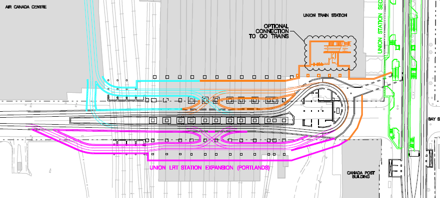

Looking at the materials, interesting to see that they are protecting a future streetcar line on Bremner. I thought that was missing on the last version - though I'm starting to lose track of all these iterations.
Good to see more exits as well - though will we ever see an exit to the SE corner of Bay and Front?

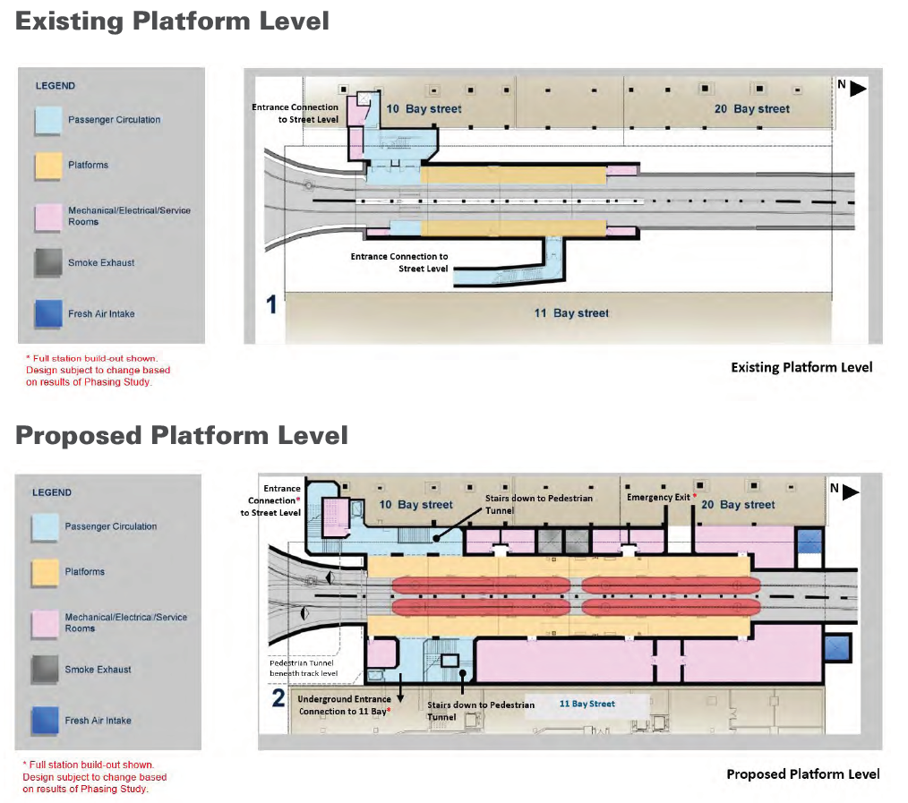

I don't recall seeing a detailed figure of the changes at Queens Quay station before. Are we finally going to see the end of pedestrians walking over the tracks? I'm not quite sure what it's showing at the south end of the two platforms. But the addition of a tunnel under the station, and elevators on both sides, suggests so.
Also, with the extension of Queens Quay station further north, and the Union terminus further south -at what point does it start making sense, just to connect the two with a pedestrian walkway along the east side of the tracks? :)
I don't recall seeing a detailed figure of the changes at Queens Quay station before. Are we finally going to see the end of pedestrians walking over the tracks? I'm not quite sure what it's showing at the east end of the two platforms. But the addition of a tunnel under the station, and elevators on both sides, suggests so.
Passenger circulation is in light blue, there is no light blue across the tracks.
What is shown is stairs leading down to a pedestrian tunnel under the tracks.
So, I agree there will no passenger crossing of the ROW permitted.
Also just to clear up confusion, the platforms are oriented N-S. So there is no east end to the platforms.
Why was it mined? unlike the rest of the stations.
The "Bremner" Line Connection is just rough-in, setting aside space, just in case sometime in the 22nd century they decide to add a new line.
Here's an iteration I archived 12 years ago. The iterative progress here is gawbsmacking.
Looking at all the videos, I see no changes from what I saw and reported in Dec, other than material cut that would offer more info to the public. Someone needs to turn up the volume for TTC presentation as the person was speaking to low like they did in Dec.
I hope we have more info pertaining to 2B by the meeting as well later on this year, as it prevents how to determine how phasing should take place as well cost and where is the funding for it coming from.
I prefer to see ramps for the Dock Station to/from all levels and will remove the need for elevators. and easy to be place in 11 Bay while it being built. This also applies at Union loop area as well..
Best to build all platforms now including track work with the exception of no trackwork for Bremner since it so far out and there is no need for it at all. The Bremner Line has never been carry forward and some thing TTC is pushing regardless of no need for it.
If we can get the funding into 2022 budget for 100% design work and construction, a tender could be issue late 2022 or early 2023 for the east-west line with it up and running by 2027. This is based on going to Parliament Loop at this time until I know more about 2B funding and time frame as well if it going to Cherry St Loop or Portland.
As for the loop, tunnel and stations, TTC can spread the time frame out since this is where the bulk of the cost is for the extension as well what unknown maybe found during the excavation like what was found the new concourse.
But isn't there a pedestrian crossing now - or have they gotten rid of it in the last year? It doesn't show blue across at the south(!) end of the current station.
But yeah, seems there won't be in the future?
Indeed. But for some reason, I thought it had vanished in the previous iteration. Maybe this is just more detailed.
