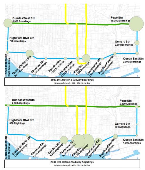

According to the Downtown Rapid Transit Expansion Study (2012) there are more peak hour boardings+alightings west of line 1 (11 800+9 600) than east of it (8 300+10 700). Overall the numbers for local ridership are about equal but the higher transfer volume at Pape results in greater ridership on the eastern leg
What this analysis really shows though is the benefit that comes with reaching Liberty Village.
True, although that ridership is not all going to/from the east of Liberty. I wonder what the potential for ridership along the Sherway-Humber Bay - Liberty Village axis will be, especially as development happens along the Queensway. If you are feeding both Lakeshore and Queensway towards Liberty, and on to downtown, the ridership will be pretty darn good. At the least, one might do an LRT tunnel from Sunnyside to the DRL at Liberty. That would greatly improve auto traffic, and create a speedier transit link. At the public meeting, someone asked about the views on LRT along the Queensway. The response was "not in this study, but yes eventually".
