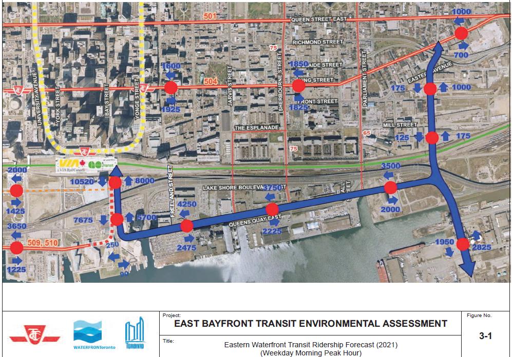

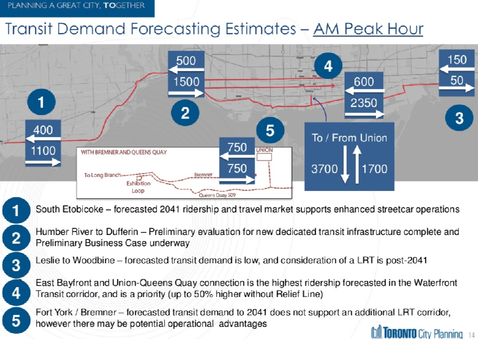

And.. there you go. Exactly what I was talking about. East Bayfront is expected to have 2350 PPHD eastbound in morning rush.. Compared to 1500 coming from Humber Bay. Note how the East Bayfront is eastbound as well - it is people coming from Union Station to travel to employment along the waterfront. Far more present and urgent of a need than Humber Bay. It could be up to 50% more if the Relief line is not constructed too.
You know, I always took you as someone who knows planning - but you failed to highlight that these assumptions take zoning as is. Christie's is used as employment lands to forecast demand. Think light industrial. Until zoning changes - planning continues to classify this land as manufacturing.

So with the new report, is anyone else noticing that the peak ridership numbers have taken a nosedive? It says "conservative estimate", but how conservative are we talking here? Originally the AM peak hour ridership numbers for Union Loop by 2021 were 10,500 outbound and 8k inbound. Now they're saying 'conservatively' (by 2041 no less) it's to be 3,700 outbound and 1,700 inbound. That's like a mere fraction. How does that make sense, even with the RL or ST in place? This seems to be the last 50yrs of transit planning in TO in a nutshell. Severely lowball ridership numbers in the downtown area, but do the opposite elsewhere with unrealistic projection inflation.
original ridership #s
updated ridership #s

What got me on Tuesday as well tonight, how low the inbound ridership was compare to the 2008 numbers that were higher for the QQE back then. QQE was close to 2,000 with about 1,500 for QQW for a combine of 3,500. Talk about skewing number to met a different out come.
