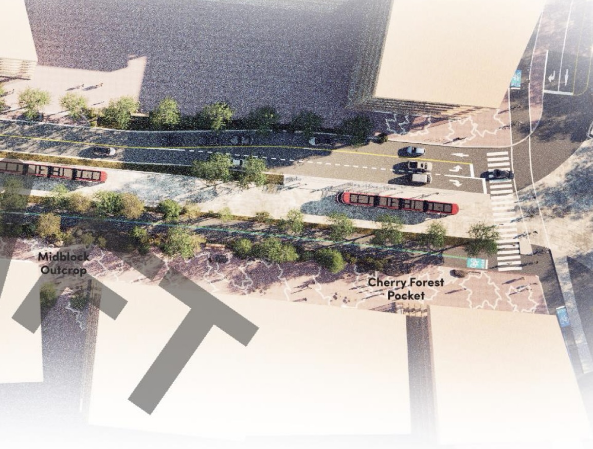

It’s not the focus of this review but there is a glimpse of how Queens Quay interfaces with the new Cherry St, which I believe is new:
Also of note, there are changes to the typical road section. No more green track on LRT guideway to support fire, EMS, and replacement bus service. As a result, the 2 lane roadway can be reduced from 8.5m to 6.6m width. This saved width will go to additional green infrastructure.
It seems they have looked at other ROWs where center poles mean buses can't run on the tracks when the streetcar is interrupted. Trying to run bustitution in the remaining narrow car lanes would be a nightmare. Losing the green track is probably a good compromise.
