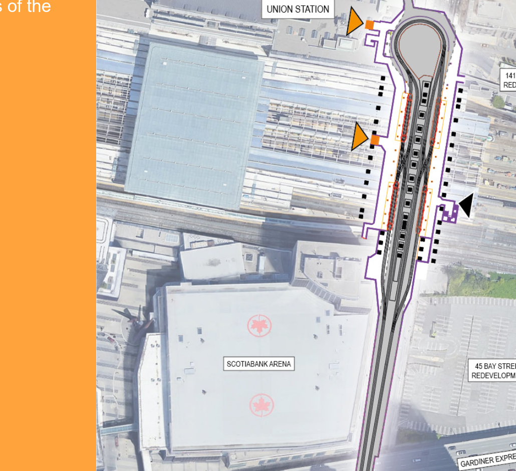

This might be silly idea but just thinking ... was there an opportunity to to put the street car platforms underneath the new south concourse at union? and have a pedestrian runnel to the subway platform?
The below image is from the 2019 report. GOs new platform is where the south tracks are in this image.
I can see a few challenges:
  • The curve to that south track space would be really tight. The arena office building foundation probably gets in the way.
  • Black squares are railway support pillars. A few of those are in the way too and moving them is non-trivial.
  • It would be a deadend track and require double-ended rolling stock. IMO, TTC should be heading this direction anyway despite a small loss in capacity.
  • Barrier free transfer to the subway looks doable but would be a long walk.
