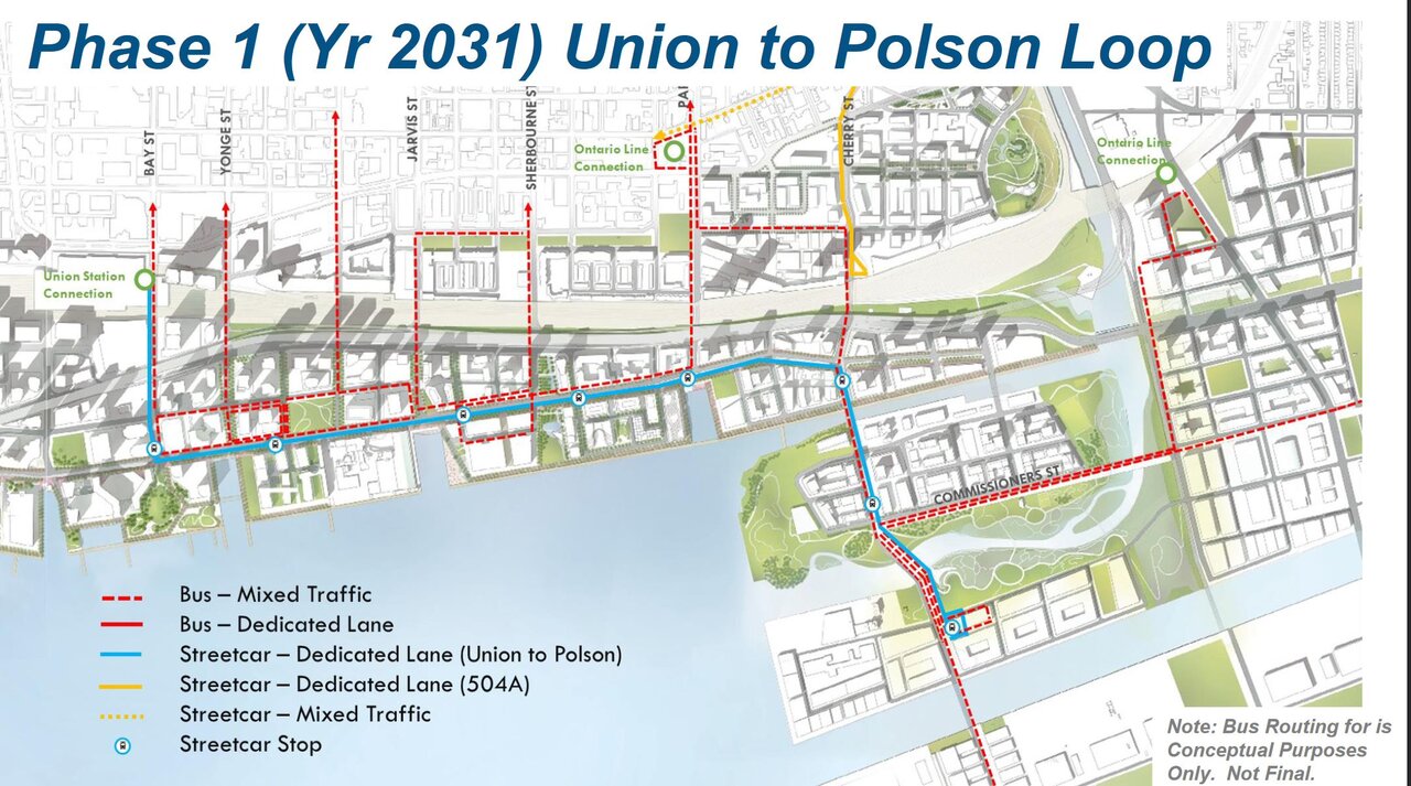

Word is (others have more info), a test bed is to be setup on Cherry St ROW to tryout grass for QQE and Portland. Long over due and need to look at QQW as well.
QQE will go south on the New Cherry St and turn east on Commissioner St To a loop north of Commissioner before the bridge
No money for Cherry South Bridge and development of Polson years off, best to do Commissioner at this time so say TO and Waterfront Toronto.

This is generally correct, more info will be distributed very soon - there were a couple of advisory group meetings earlier in the week. It is also suggested that the Cherry St line should go south of the current loop and connect with QQE.

That is exactly why there is no serious talk of going south of the Ship Channel (at least in the foreseeable future) and also why the current discussions are of 'only' bringing the QQ LRT south to Commissioners Street - which avoids a crossing of the new Don River.
Plus the Portlands plans see to it that it will remain industrial in the foreseeable future. Can a case be made to extend the line further? Yes - especially if there is a serious attempt to build a bridge over the Eastern Gap (even then you have to wonder how much of a draw that would be), but it's all hypothetical at this point. It's like we're worrying about the plans when we can't even get what's truly needed off the ground.
I thought that after deciding that the loop would be removed in the distillery district that the loop was moving to Polson, across the new river mouth. Has new material been presented with other loop locations? Other loops would occupy more immediately developable land or park space.
The most recent discussions see the QQE LRT line linking to an extension of the Cherry Street line that would go under and just south of the rail berm and then this 'merged line would go south to Commissioners with a (temporary) loop just east of Cherry Street serving both QQE and Cherry. (The current Cherry loop will go as it would block a link under the berm due to height limitations.)
This will allow for the line to (eventually) continue along Commissioners and end at the Leslie St Barns and give the TTC a (much needed) additional link for the barns to the rest of the TTC system. There will be a public presentation on this 'plan' in October, or so I have been told. A loop at Polson (south of the new Don is certainly not rejected, it will just (probably) not happen for quite a while.
