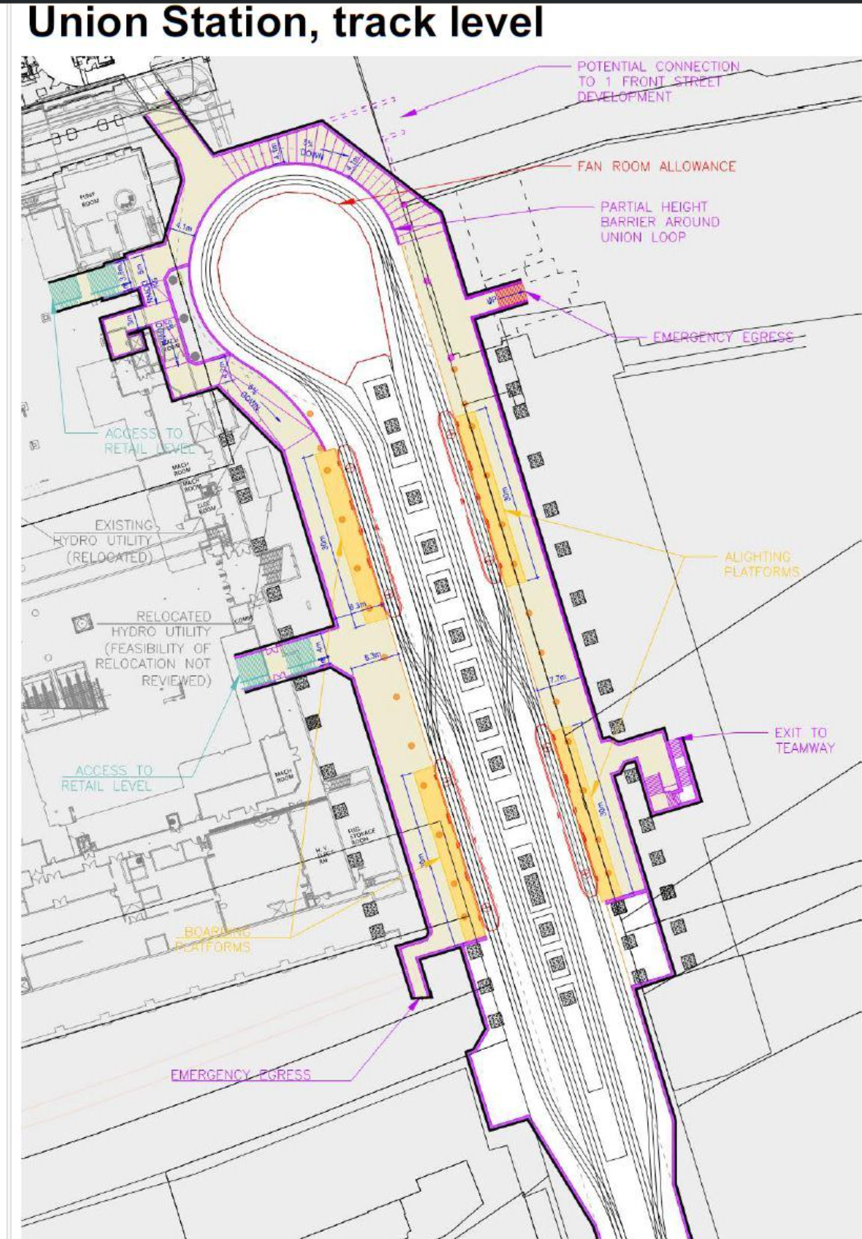

Sorry out of the loop. What's this VE for Area 1? Isn't that what's been happening for over 10yrs now? Not tongue in cheek, I still believe there are ways to lower the costs, or at least keep costs neutral with better bang. Basically anything that doesn't require full scale loop rebuild.
What was to take place 12 years ago is different today. You are now looking at a portal on the west side of Yonge and infilling the waterfront in place of a portal at Freeland. Then doing the work in 2 phases with Bay being done after there is a e-w line in place.
Union loop has to be fully rebuilt to handle 10,000 riders at peak time.
The work on Bay Street and the actual Union Station loop (whether you are in or out of it :->) is being re-designed by the TTC. The current loop is very poorly designed to meet even current passenger volumes so I think there is little doubt that 'something' needs to be done to serve the future (larger) passenger volumes. WT is dealing with the rest of the project and there are details of their (already public) plans on their website.
I believe the whole loop station also needs to be rebuilt lower due to fire safety regulations, so making any changes means changing everything.
Lots of useful info on Steve Munro's site, of course. This is from 2019. See: https://stevemunro.ca/2019/03/05/waterfront-transit-reset-the-union-station-connection/
Two operational modes are possible:
  • Offload northbound, load southbound. In this scheme, the northbound berths would be used for offloading cars, and the crossover would allow cars to leapfrog each other. The southbound berths would be used for loading with one berth assigned to each route (waterfront east and west) and the crossovers used for cars to bypass each other. In this arrangement, the northbound double track is not, strictly, required as offloading activities are not route specific.
  • Dedicate the northbound berths to one route (say Waterfront east) and the southbound berths to the other (west). In this scheme, the crossovers are not strictly required because only one route would serve the platforms on either side of the station, and they would run through “express” on the inner track to bypass the other route’s platform.
There have doubtless been tweaks to this in the intervening years but.....
