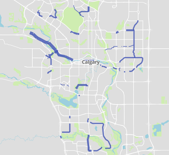

Anyways, found the data set, which the city has in a nice visualizer.
Here are the concrete pipes installed between 1969 and 1981.
