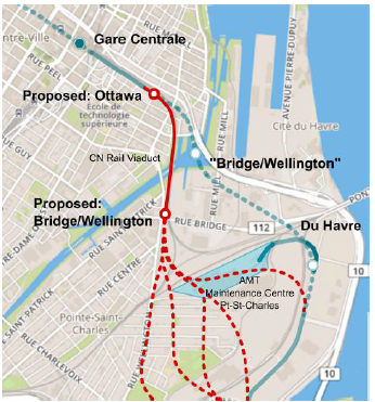

Personally, I'd like to see them make a few more design changes (note, many of these images are taken from Anton Dubrau's BAPE deposition)
1) Change the south downtown alignment to improve coverage
The current alignment just has a single, underwater station at Peel basin, with exits at both ends, to serve Griffintown and Point Saint Charles. This isn't great because 1) it's expensive, 2) it means that Ottawa street, which was slated for BRT, will have to be closed and 3) the ridership potential at Du Havre station is very limited because it is a sliver of incredibly toxic land in between a railyard, highway, and river.
If instead of being tunneled, the REM were elevated using the existing rail viaduct (which has room), you could have separate stations to service Griffintown and Point Saint Charles, maintain Ottawa street for BRT, and have a better catchment area. This would also avoid tunneling through incredibly contaminated land.
2) Connect to the airport from the south instead of the north
The current connection involves tunnelling under an active runway, when the airport is only 500 meters away from a railway. There is a pre-built station in the airport, which is pointing south (the logical direction for a connection)
By going south you could avoid all that tunneling, which is the most expensive part of the REM route and also one of the lowest ridership sections.
If the desire is to have the airport connection as part of the REM and not as a stand-alone line, I see two options that would cost about the same but would provide much better coverage:

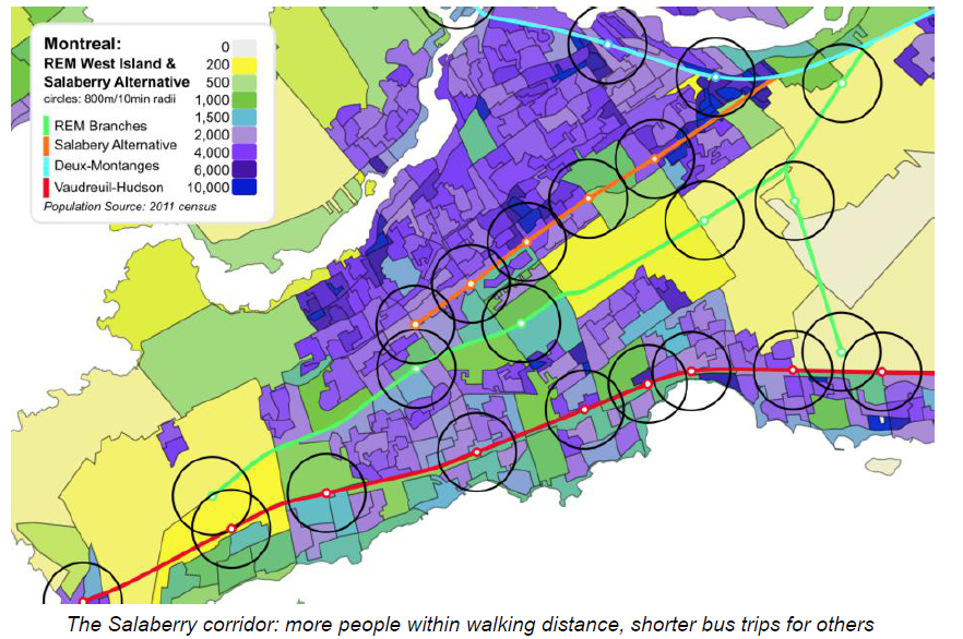

3) Move the west island branch north and bury it with the hydro lines
I'm not completely sold on this change, but the idea is that the current middle-of-a-highway alignment isn't great because A) nobody lives next to a highway so almost all the ridership is from Park n rides, B) densification is almost impossible (and not desireable because of pollution/noise) next to a highway and C) the station locations result in lengthy bus tours.
If the west island branch were built along the hydro corridor, it could be trenched and decked over, and combined with a proposed burial of power lines. Then it would be much closer to where population centers are, you could have intensification along the corridor, and the stations would be directly under north/south arteries for better bus connections. This would also reduce competition for the Vaudreil-Hudson line, which dies with the REM along with the Mascouche line, and avoids urban sprawl because it doesn't extend as far into sensitive areas/wetlands.
I'm not 100% sold because 1) even though population density is greater along Salaberry, there tend to be more jobs located near highways because of office parks 2) although there exists the potential for densification, west island communities have an awful track record of actually allowing it so you would still end up with SFH next to rapid transit 3) you get less coverage than with elevated transit.

CP/Pink line routing
I've drawn the fantasy map above to show what is under consideration. It's a combination of the AMT "Train de l'Ouest" proposal and Phase II of Projet Montréal's Pink line. The idea is that the CP ROW would be used, which is on top of the Bluffs and much closer to where people live. Rather than terminate at Lucien L'allier (like the AMT proposal) or continue northeast (as part of phase I of the pink line, which is unlikely to be built anytime this half century) it would be a branch of the REM from downtown. This way, we would be doing the tunneling in places that make sense (downtown, under Rene-Levesque) instead of under a runway. Tunelling may not even be necessary, since there is extra room in the decked-over Ville-Marie expressway.
The REM vehicles would allow for new stations in NDG, including one at Cavendish (very useful connection, especially with the Dalle-parc cyclist/pedestrian connection south to Ville Emard and the planned Cavendish extension north at Cote-St-Luc.
The advantages is that this serves many population centers and destinations, and is a much more direct route downtown than the REM routing. The disadvantages are the unknowns about the shared ROW with CP/AMT, and how the tunneling (if any) would be done downtown.
If the west island branch were built along the hydro corridor, it could be trenched and decked over, and combined with a proposed burial of power lines. Then it would be much closer to where population centers are, you could have intensification along the corridor, and the stations would be directly under north/south arteries for better bus connections. This would also reduce competition for the Vaudreil-Hudson line, which dies with the REM along with the Mascouche line, and avoids urban sprawl because you get fewer kilometers of rapid transit.
