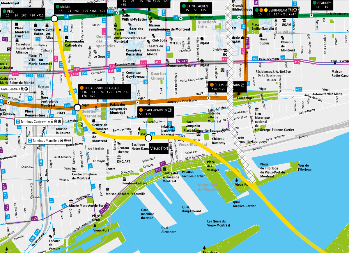

Ah, maybe that elevation map explains why there is no yellow-line station in Old Port. From this, I would guestimate that the tunnel doesn't get reasonable flat until north of Viger.
Although really, the yellow line alignment was a mistake, more built as a shuttle for Expo 67 than as a commuter line. They should have pointed it towards McGill and had it intersect the orange and green line at separate stations. That way, instead of forcing everyone to transfer at Berri-UQAM (and overloading the central section of the green line) more people would have a one-seat ride. It also means that you no longer have the entire network shutting down because of an incident at one station.
Here is my fantasy alignment. Because the yellow line has a longer route, there is a small enough elevation change to allow for a station in Old port.

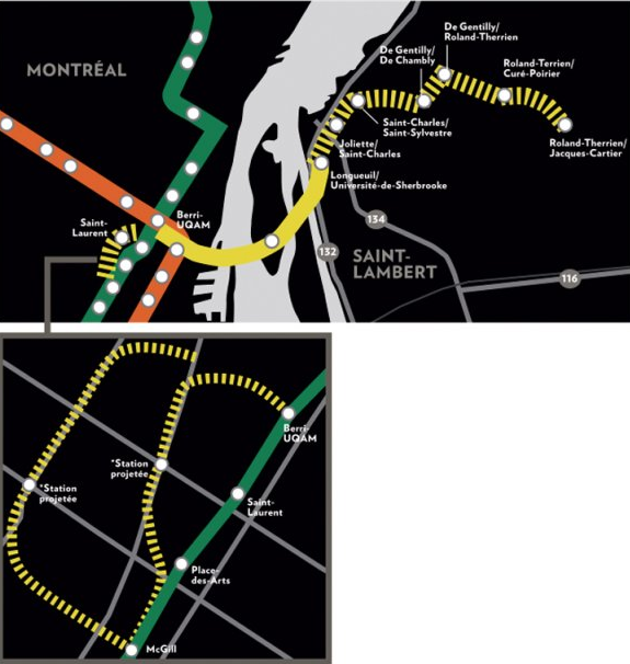

The original mistake of putting it under Saint-Denis means that the STM is planning on building the silly extension pictured below to McGill before expanding the line further into the South Shore, because of concerns about all the transfer traffic.
