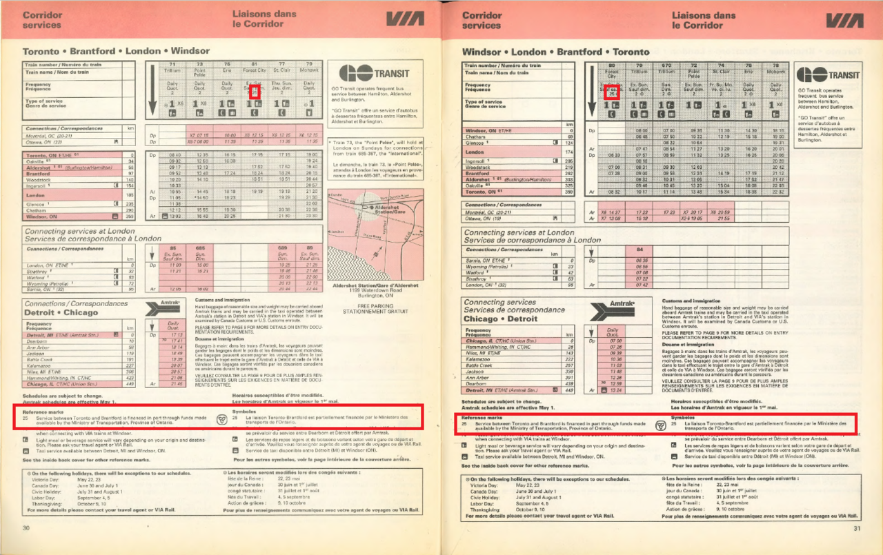

I thought we had already discussed that here, but I am not aware of any changes in VIA's mandate since January 1990 (when an Order-in-Council forced VIA to drastically cut its network and services), but that doesn't seem to have prevented the MTO from co-financing the reintroduction of what is today train #82 and #83 (i.e. the early-morning commuter train from London to Toronto and the late-afternoon return trip) just a year later, or are you aware of any changes in VIA's mandate since then?
VIA brochure (effective 1991/01/14):
VIA timetable (effective 1994/04/24):
