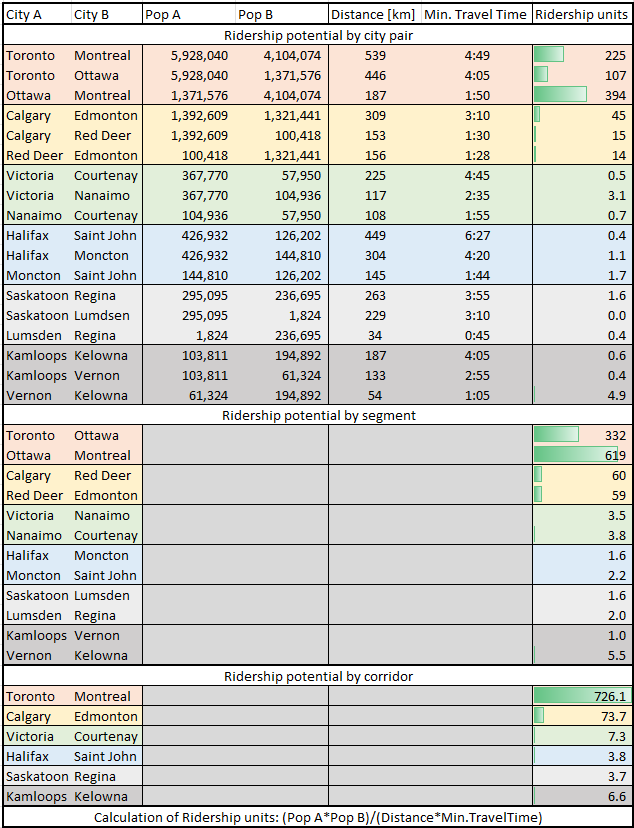

Applying gravity model:
for Kitchener - Toronto CMAs
(575,000)*(6,202,000)/(93.78)^2 = 405 489 067.697
for Montreal - Toronto CMA's
(4,300,000)*(6,202,000)/(508.87 )^2 = 102 987 975.53
Montreal-Toronto has1/4 the theoretical demand of Kitchener -Toronto.

An easy way to do this, so the numbers don't get huge is to use the population in thousands (ie. 1 million becomes 1000 in your calculation). It also works out nicely because when you then divide by the square of the distances, you usually get tens of thousands or hundreds of thousands in your denominator. So that way you get a nice round double or triple digit score at the end. For distances, I use the Google Maps road distances between stations usually. Also significant figures. LOL. You don't need distances in tenths of a kilometre when you are rounding off your population to the nearest thousand or even ten thousand. It's a rough order of magnitude estimate (ROME) technique to gauge potential demand. Doesn't have to be precise to 5 decimals.
Using your numbers and my technique:
Kitchener-Toronto: 404
Montreal-Toronto: 103

Yep. And it's absolutely ridiculous. A Toronto-Kitchener-London line has substantially more demand potential than Toronto-Ottawa-Montreal when you add up the segments. And a huge part of this is because HSR makes all these places commutable with each other. Something that only happens on the Ottawa-Montreal segment of the TOM corridor.

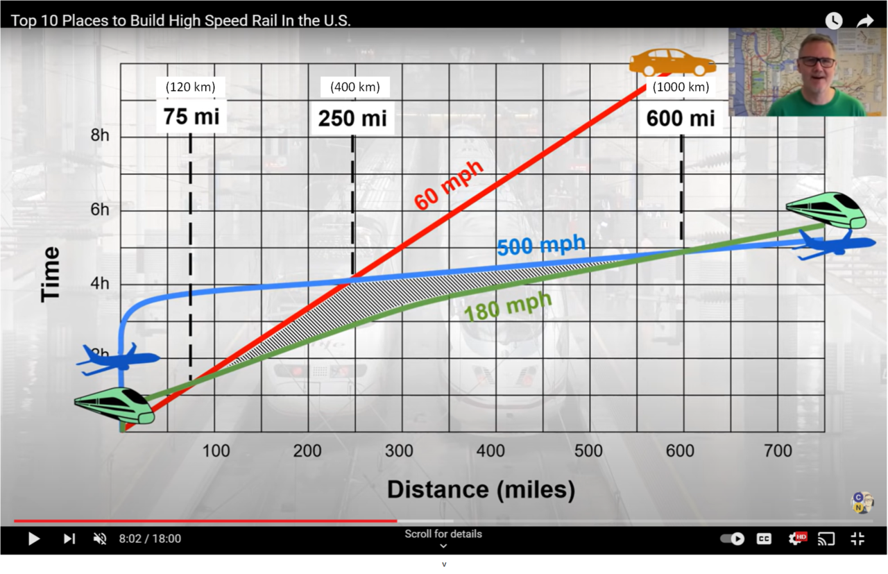

The gravity model estimates overall demand, not just HSR demand. To get the potential demand for HSR, you need to compensate for the competition from other modes of travel. CityNerd does a good job of explaining this in his video Top 10 Places to Build High Speed Rail In the U.S. At about the 8:00 mark, he shows the following chart showing travel time vs. distance (I added conversion of the distances to kilometers). At a distance of only 94 km, HSR between Kitchener and Toronto CMAs is going to have difficulties competing with driving. Now traffic will play a role, but I would argue that KW-TO is in the range that regional rail would be more appropriate.
At a distance of only 94 km, HSR between Kitchener and Toronto CMAs is going to have difficulties competing with driving. Now traffic will play a role, but I would argue that KW-TO is more of the range that regional rail would be more appropriate.
I'm not sure his model translates well here. His model does not account for traffic or higher fuel prices here. And traffic, cost of gas and parking are highly relevant in this example. At rush hour (8AM), from Kitchener GO to Union, it's 1:50 hrs to drive and 1:43 hrs on the train according to Google. GO RER is supposed to reduce travel times by 20%. That should take it down to 1:22 hrs. The proposed Ontario HSR would have cut that down to 48 mins. The biggest competition to any HSR proposal from Kitchener will then be GO RER. It will essentially be a trade-off between a longer ride and a higher fare with people falling along the spectrum. I suspect Toronto-Kitchener would still have similar ridership numbers to Toronto-Montreal.
