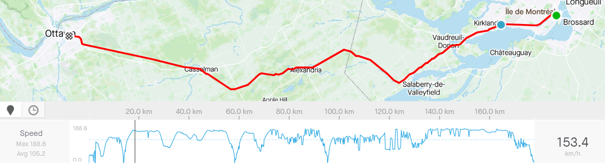

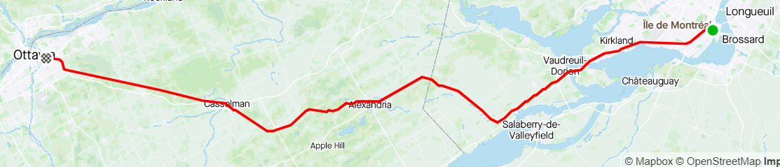

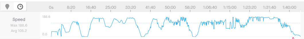

I have attached the speed/time and speed/distance graphs below. The recording was only started as the train left Gare Centrale on the viaduct but before it reached the Lachine canal.
As you can see, this travel time was achieved despite several slowdowns that could likely be removed with the ~150m dollars for this leg of HFR.
I'm puzzled by the label reading Max 188 km/hr. Is that just the labelling of the axis? I'm sure your train did not go that fast.
