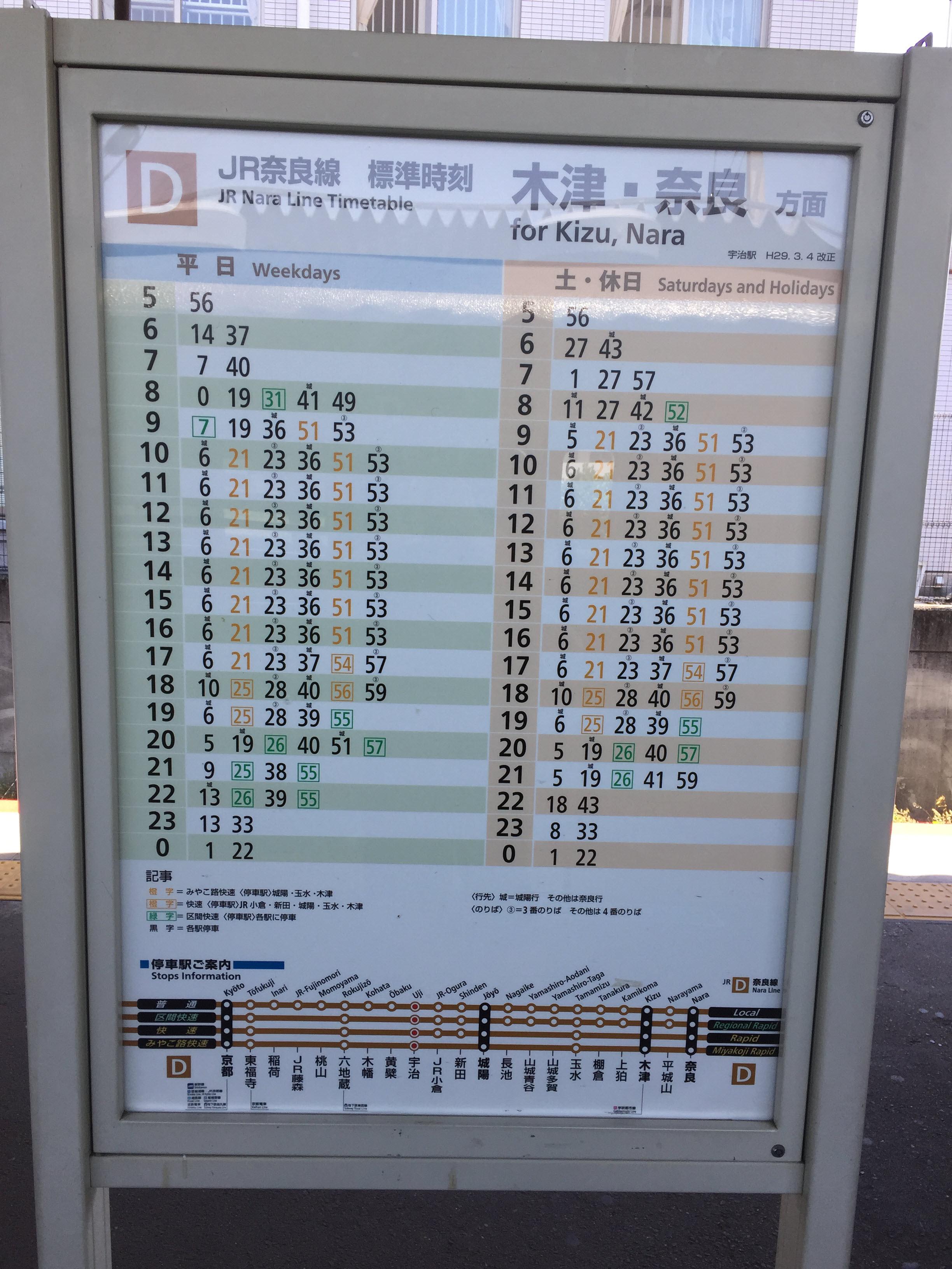

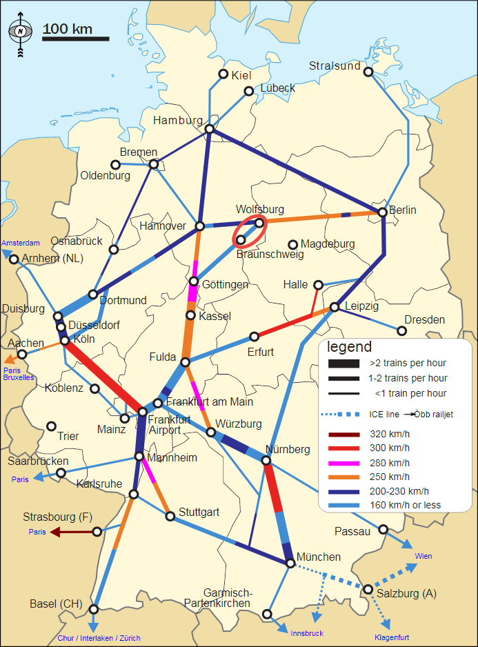

In addition, @steveintoronto also identified the following two impressive examples of high-frequency single-track operations (both of which I have witnessed myself):
ICE, Braunschweig-Wolfsburg (One ICE and one RE (Regional Express) train per hour and direction):
upload_2017-7-13_13-58-54-png.114868
This is the timetable with 6 trains per hour and direction (the orange trains overtake the preceding train at Uji) on what is a single-tracked line between Momoyama and Uji (all stations equipped with passing loops, but single-tracked sections are up to 2.2 km long):
kyoto-to-nara-jpg.114869
It is posts like the above which make me highly regret his forced absence from this forum...
