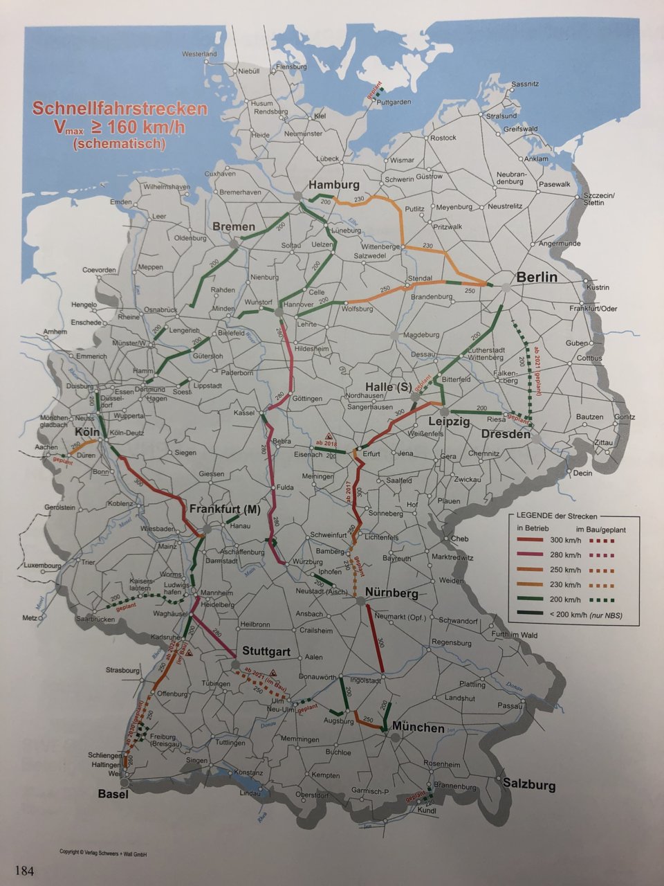

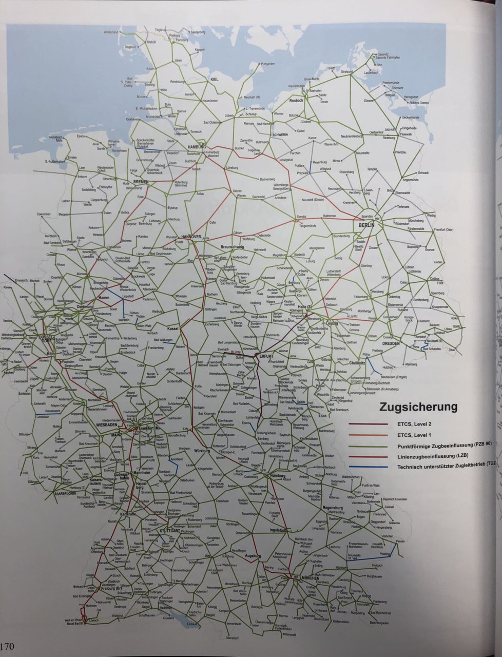

I have always said, that we can improve track sections to HSR standards so that speeds on those sections can be increased. I experienced that between Dresden and Berlin a few years ago, while the rest of that journey between Prague and Dresden was at standard VIA speeds.
I agree that the rail system in Germany is impressive, but this would make you a time traveller, because the upgrade of the Dresden-Berlin line to 200 km/h is only planned for 2021...
...as anything beyond 160 km/h would require the installation of LZB or ETCS, as PZB with its stationary signals is limited to 160 km/h:
I don't know what speed we were travelling at but it was really fast (I was being mesmerized just looking out the window) and the track was very straight, no level crossings and highly segregated with high fences. Perhaps, they needed new trains to reach a full 200 km/hr or part of the route between the two cities was not yet upgraded to that standard. I don't remember how far from Dresden I was before we hit that stretch that was super fast. As I said, track upgrades can be incremental.

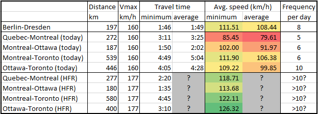

Go on Deutsche Bahn's Register of infrastructure (requires Java Script), click on the "Select by rectangle" option, select the same area as in the screenshot below (Berlin is exactly at the top left of that rectangle, whereas Dresden is at the exactly opposite corner) and scroll to the right until you've reached the "permissible speed" column and then scroll down until the last object:
195192
You will not find a single object with a permissible speed beyond 160 km/h (i.e. the maximum speed for PZB), because none of the segments has been equipped with LZB or ETCS, which are the only train control systems which are certified in Germany for operations beyond 160 km/h:
And this is why I find your praise of track segments which have been upgraded "to HSR standards" so ironic: because the line you were presenting to us as a role model of what you can do when you go beyond HFR (i.e. towards HSR), is in reality exactly between present-day VIA's corridor services and what HFR promises to deliver in the future - with a maximum speed (160 km/h) of what you call "standard VIA speeds", a minimum travel time (1:46) representing an average speed which is (very marginally) surpassed (111.51 vs. 111.90 km/h) by present-day's Montreal-Toronto service (which is of course 50 minutes slower than the famous "3:59") and a frequency (8) which lies exactly between present-day Montreal-Toronto or Montreal-Ottawa (6 each) and Ottawa-Toronto (8) services:
195197
Source: Gahnert.de (for Berlin-Dresden), official VIA Rail timetable (effective 2019-06-02) and official VIA Rail presentation (for HFR)
