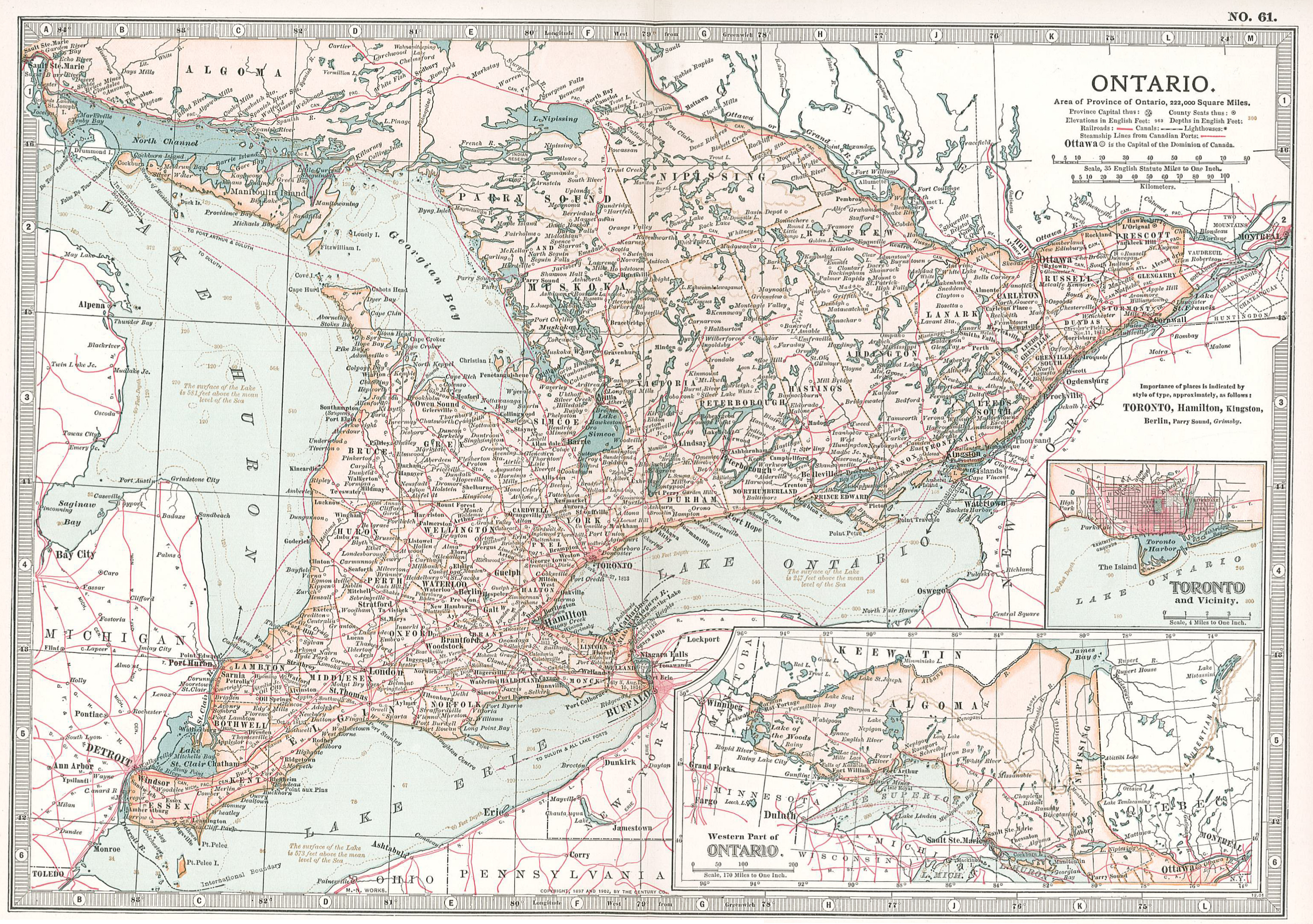

I was looking for a map of where the original rail alignment went. And never did find much.
But I was looking for something completely different (BTW, if anyone knows where 1960s/1970s Ontario maps with old Township road numbers are, please message me - they are surprisingly hard to find. I've no end of sources for 1800s and very early 1900s maps. But 1960s? 1970s? Good luck. I thought the old 1970s MTC series might have them - some of which were reproduced by AllMaps in the 1980s ... but the sheet I'm looking for must have disintegrated years ago.
Anyway, here's a part of a good Ontario map from 1902. Which amusingly has railways, canals, steamship lines, and lighthouses. But not one road! Probably not that useful on a provincial scale at that time! This is from the University of Western collection (which frustratingly seems to go no later than 1902. Some great old stuff though!
The map shows the railway line coming from Peterborough to Havelock (where it now ends) towards Madoc, though Tweed, Kaladar, and then onto Perth, etc.In particular Glen Tay is shown, which I believe is about to where it gets to being still in service.
