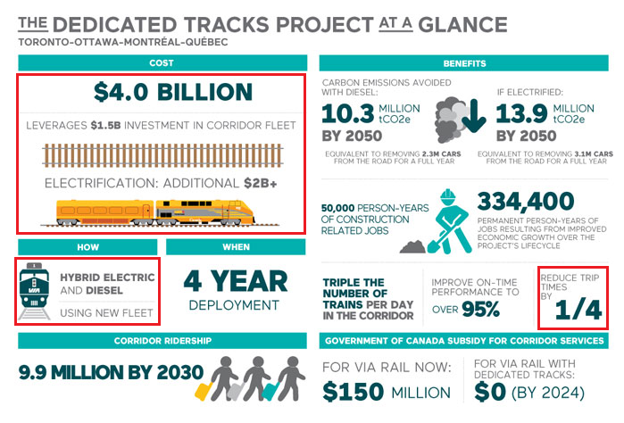

For any questions regarding HFR, I refer to the current Infographic on the VIA Rail website:
Source: http://www.viarail.ca/en/about-via-rail/governance-and-reports/dedicated-tracks
Where did they get $4 billion from? The 2010 Metrolinx study from Patrick O'Connor, at Hatch Mott MacDonald said it would cost $1.5 billion just to go the 120 km from Union to Peterborough so as not to impact CP freight activities. And that's all existing track, without any curve upgrades for faster service.
It's over 750 km from there to Quebec City. That's 6 times the distance, a nightmare in Montreal, at least 2 major river crossings, many km of abandoned alignment, that won't be easy to expropriate. And yet there's only $2.5 billion left to do it?
Any engineer who signs off on those numbers, should have their licence stripped by PEO or OIQ. It clearly doesn't pass the BS test.

I'm still skeptical that VIA can get to Quebec City for $4 billion.
It certainly makes for more meaningful discussions if people look at projects with some healthy scepticism (and I wish there was more of that in all those delusion-fueled discussions about the Hyperloop!), but as long as you have no access to those studies and we can't discuss them here in public, your conclusions are mere speculation, as the assumptions and assessments made by the engineering firms analyzing this project might differ quite significantly from those made by yourself and with the very limited amount of information available to you at this point. Also, would you mind if I asked you about your own qualifications and expertise which allows you to contest the qualification of (other?) engineers? Otherwise, can we just wait until the studies are released and become available for our scrutiny before we entirely dismiss every probability that their assessments and conclusions could be realistic, methodologically sound and at the same time: supportive of the project and its claimed benefits?

I'm an aerospace engineer. So I won't comment on the civil works portion. But I am skeptical of the current cost projects simply because, like niftz pointed out, other assessments have said it'll be expensive to reach Peterborough. And from there we're looking at some very expensive track to get up and running. And if I'm not mistaken, the $4 billion also includes the costs of trainsets and stations. I was on the fence on $4 billion getting them to Montreal but I could various arrangements with Metrolinx and AMT working out to make that happen. $4 billion from Toronto to Quebec City really seems a stretch.
But you're right. None of us have access to those internal project reports. And this is why I keep saying, I am most curious to see what the CIB and the investment consortium they put together say. They're best placed to judge the business case.

So looking at the chart above would I be correct to infer that VIA would be aiming for Tier 1C? If they need to get to Ottawa in 2.5 hrs from Toronto, given the number of stops they have, that would basically be speed they need (~200 kph = 125 mph). So basically that would get them off the hook for most grade separations. And that would get the cost down there.
I think most of us are wondering how the curvy nature of the corridor will impact costs. I know I am. I always figured that VIA would find a way to avoid most of the costs of grade separation. I figured the goal would be to build a corridor that can be upgraded. Add grade separations as required down the road and boost speeds on operating sections. But to do that, the track has to be aligned in a way that's conducive to operating at higher speeds.
If not the above, we're talking about an alignment that can handle 180-200 kph. That would seem rather expensive to me. If I assume $800 million for trainsets and station works, that means to me, about $3.2 billion left to spend on track from Toronto to Quebec City. About $4 million per km on average. Anybody know of similar rail works in Canada or the US through rural areas? Were they able to achieve similar costs?
The closest comparator that I would put forward is the relaying of the Newmarket Sub from Bradford to Barrie. I have gone hunting for that figure without success. That project involved both track replacement and construction of a yard at Barrie, so even if I had the number I'm not sure you can divide the cost by the number of kms of line. From rough memory it came out to more like $20M per mile. That work put down new rail and ties on a roadbed that was largely intact and not degraded by a long period of abandonment. The line remained unsignalled and speeds remain in the 75-80 mph range.
The Auditor General report on VIA reported the cost of adding the triple track to the Kingston Sub as being about $10M per km. That includes extension of culverts, and laying of a whole new subgrade, and signalling. My theory is that the Havelock Sub would need this level of subgrade improvement and culvert/drainage restoration, pretty much as if the line had never been graded, but I defer to the pro's in that.
I found one earlier press release which indicated that adding two sidings to the Smiths Falls Sub and signalling them cost $10M in 2008. There had been lots of earlier work to undercut and reballast the line and upgrade the rail and do tie replacement, but that was in a much earlier era. Same with the Brockville Subdivision. Again, those were in-service lines that had not deteriorated for 40+ years. Those new sidings were each only a half mile long.
Bottom line, this layman would expect closer to $10M per km than $4M.
Edit - see also this for the Chatham Sub - $17M just to signal 56 kms of line, add one new siding, and replace about 13,000 ties (there 2,000 + ties per mile of line, so that was far less than full replacement) and this for Ottawa-Montreal upgrades and this and this for the Brockville Sub.

I can't comment on HFR, but comparing the top results of the Google searches for "VIA Rail 110 mph" and "VIA Rail 125 mph" might be instructive. As for travel times and whether the future fleet is included in the capital cost figures or extra, I can only refer to the most recent graphic on the HFR page on the VIA website:
PS: There is a separate page on VIA's fleet renewal program: http://www.viarail.ca/en/about-via-rail/governance-and-reports/fleet-renewal-program
