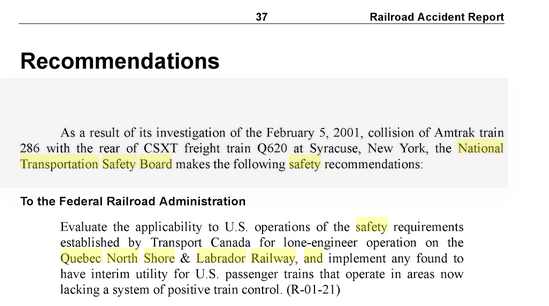

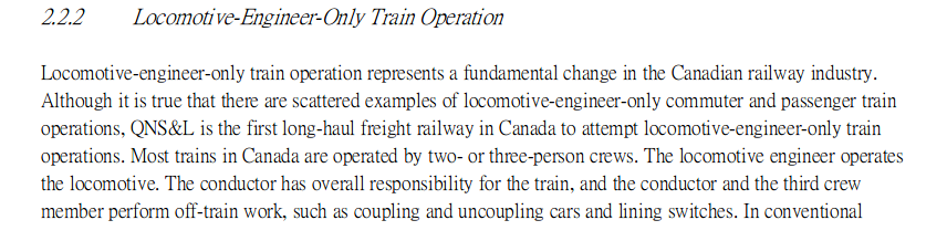

TC have come under heavy criticism for 'making it up as they go along'...and appear to still be doing it in many cases.
The QNS&L incident was the subject of a chapter in a massive US regulatory report on Amtrak train crew numbers that I can't find on-line right now, but have found reference to the report in a book:
https://books.google.ca/books?id=ogv-GUpN8xEC&pg=PA37&lpg=PA37&dq=national+transportation+safety+board+QUEBEC+NORTH+SHORE+AND+LABRADOR+RAILWAY&source=bl&ots=kQbRmw5XWP&sig=zoEyYb7HdsO9oNREKntC41bhm9c&hl=en&sa=X&ved=0ahUKEwiog4HRlIDUAhXi7YMKHc-RBy4Q6AEIXjAJ#v=onepage&q=national transportation safety board QUEBEC NORTH SHORE AND LABRADOR RAILWAY&f=false
As to how Transport Canada has used their own report (which was quoted verbatim in the NTSB report, but unavailable to Cdns in any published report) to set regs is a good question. Lac Megantic truly shook out a lot of shortcomings in TC regulations and/or oversight.
