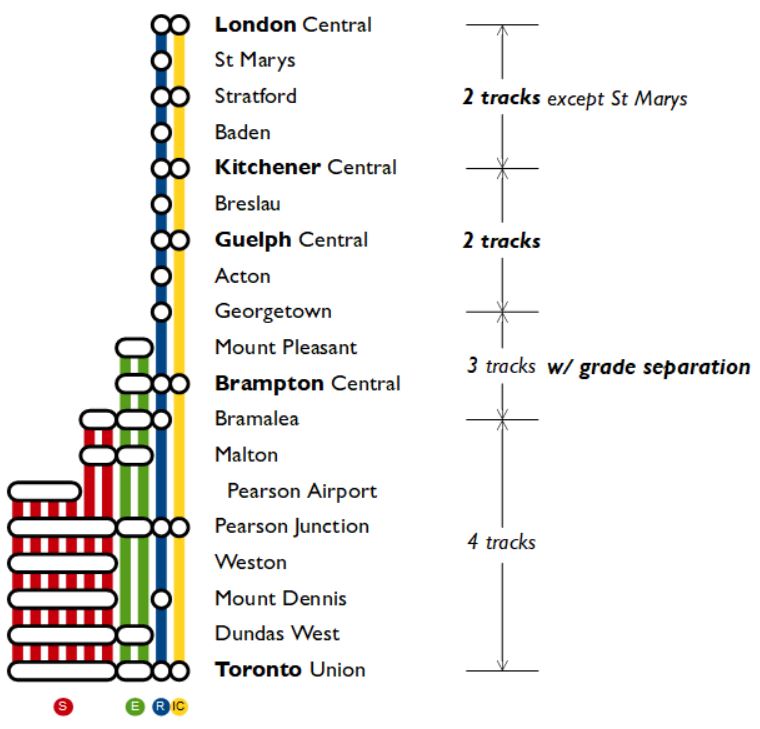

There is all sorts of highly mechanised technology available to do track work, and the tasks required to fix the London-Kitchener portion of the Guelph Sub are all very well understood and practiced regularly by the industry.
The obstacle is the logistics. Either one has to convince CN to squeeze the job into its major project schedule, which would require freeing up their workforce and equipment from a very full schedule of work elsewhere in the system, or hire a contractor who may not be able to finance the investment cost of leading edge, high productivity track equipment for a single 60 mile project. Having CN schedule the job would likely create a multi year lead time. But CN may not allow a contractor without their having control.
Rather than imagining a single pass using the newest equipment, the most likely scenario might be a more moderately equipped contractor doing the work in successive tasks..And a ramped-up maintenance contingent to handle the ongoing upkeep..
However, the limiting factor remains the pace of upgrades to the Halton Sub and the Metrolinx portion of the Guelph Sub, including the new Kitchener terminal. Until we know just how many trains ML and VIA will be able to push through after the dust settles, we are just imagining.
Sure wish CN, ML, and ViA, and two levels of government, saw this as a priority. A moderately upgraded Kitchener line could out perform the Dundas Sub in capacity, frequency and trip time, and possibly has an equal or better ridership catchment. But we don't know whether they are building to that scale.
