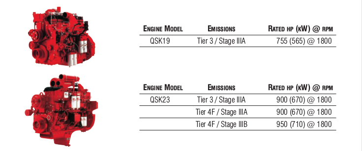

UPX has the max rated power package already. Did the notion of a H series being spliced into a UPX set come to you as a way of making a frankenLRC seem reasonable? ONTC have done no work on an LRC afaik, and a straight up refurb contract put IRSI under - or at least was the straw that broke the camel's back.

"Max rated package"? I think more can go into the space and mountings of that motor, the xmssn might be the limitation for torque although that xmssn IIRC (ZF), has torque ratings well beyond what the present QSK 19 produces.

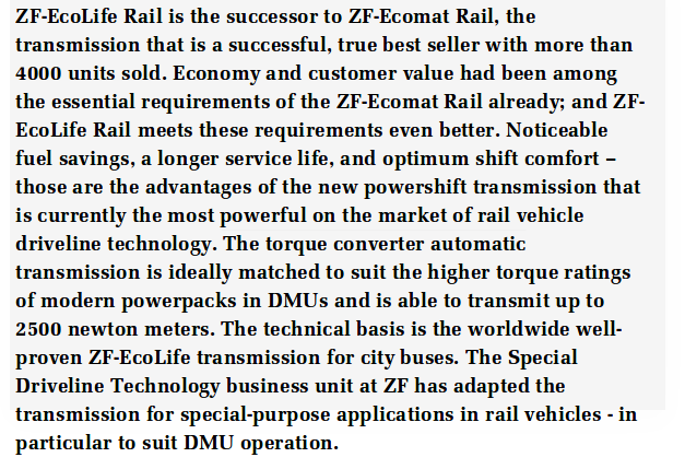

The final drive ratio could well be adjusted to something shorter, as the max rated speed of the vehicle is never reached on the UPX run. Something to consider, although the rating of the Cardan shaft and couplings would have to permit the extra torque as the trade-off for top speed. I believe the SMART models have a lower final drive ratio than the UPX models, but please correct me if I'm wrong.
https://ci-portal.zf.com/global/med...press_kits_1/2015_t/03_ZF_EcoLife_Rail_en.pdf
The rail vehicle optimized QSK23 compared to the present QSK19:
