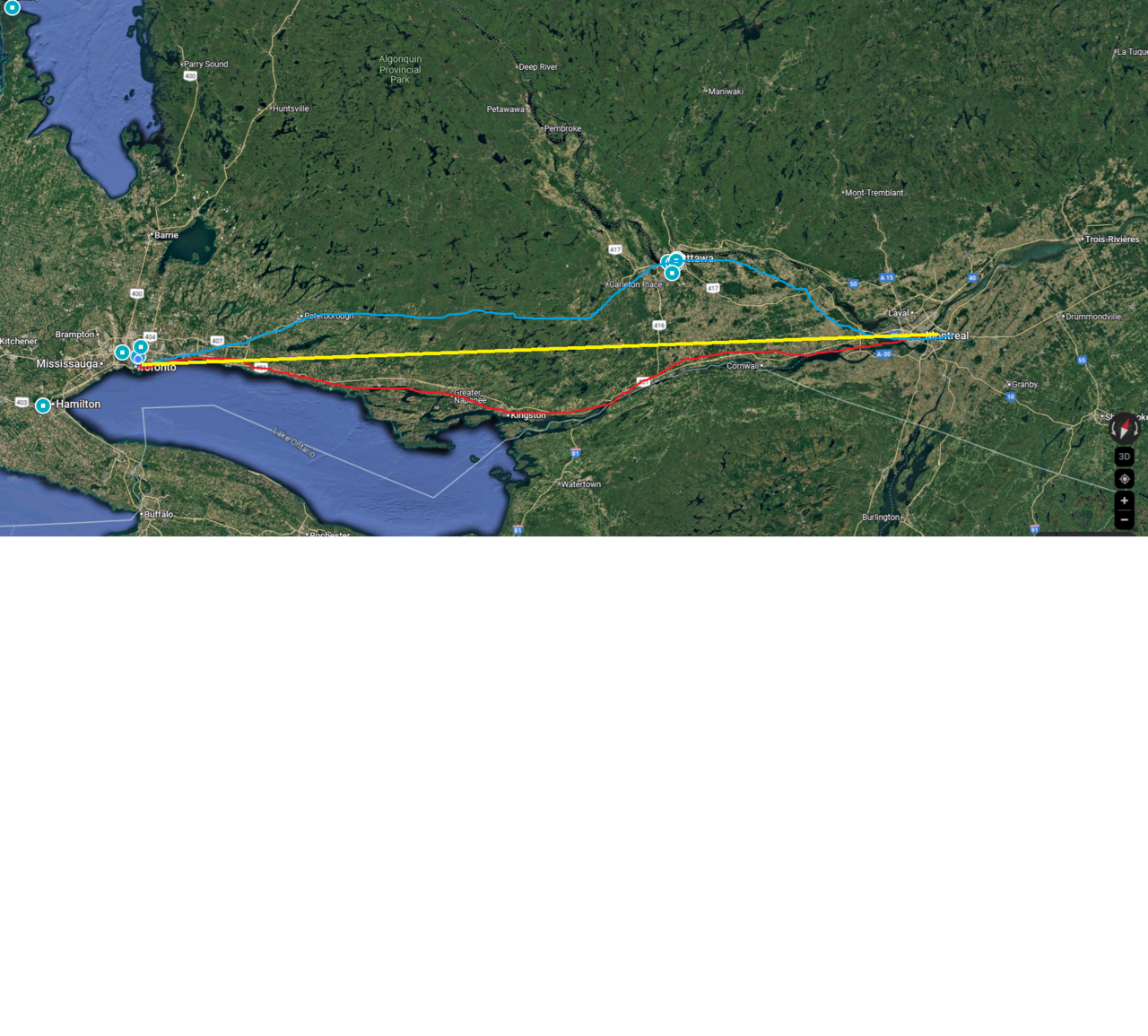

I just assumed the 3 hours vs 2.5 hours is because there is no direct Montreal-Toronto route, but it is routed through Ottawa? Rather than having a straightish line from Montreal to Toronto with a branch up to Ottawa, which would obviously be faster?
All of the previous HSR plans that I'm aware of went through Ottawa. None of them skipped it. Bypassing the third busiest trip generator on the corridor to save 40ish km never made sense.

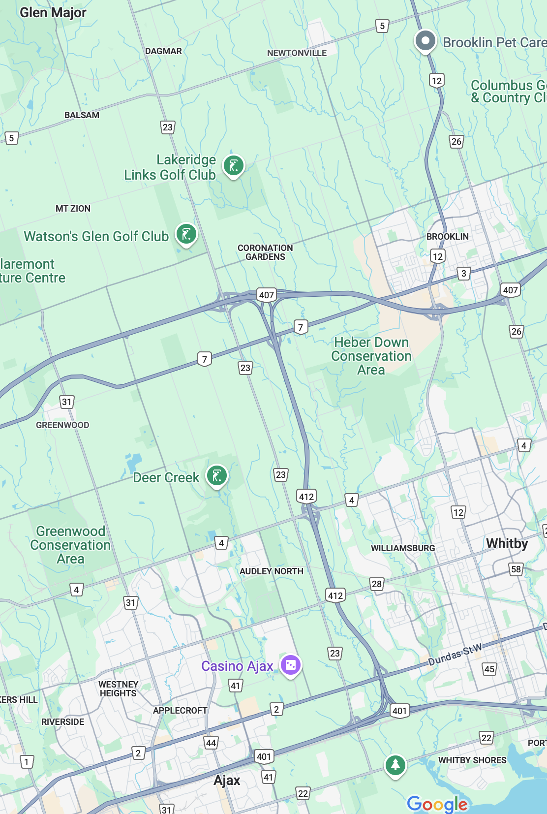

This is what I don't understand. The 407 corridor stretches all the way across the city from Milton to Pickering, right? Couldn't you just build a purely CP bypass along the 407 from Milton to Pickering, maybe with a couple GO tracks added on too, and avoid the York subdivision entirely? I mean, I know the Ontario Liberals original plan was to have CP and CN share the 407 corridor between Milton and Bramalea and then have CP use the York subdivision, but if we accept that as flawed, then why not scrap the part about CN tracks and then have CP stay within the 407 corridor for the Bramalea-Pickering section. If you don't involve CN, then you'd only need to persuade CP, right?
We are in the wrong thread for this discussion (which has cycled ad nauseum already in the correct thread) so I won't belabour here.
But the short answer to your question is - what's in it for either CPKC or CN? And what might befall CN or CPKC, or appear to them to be the likely result, in terms of their interests and competitive positions?
A bypass makes a lot of technocratic sense. Now try selling it to shareholders. At the same time, try to fund it.
