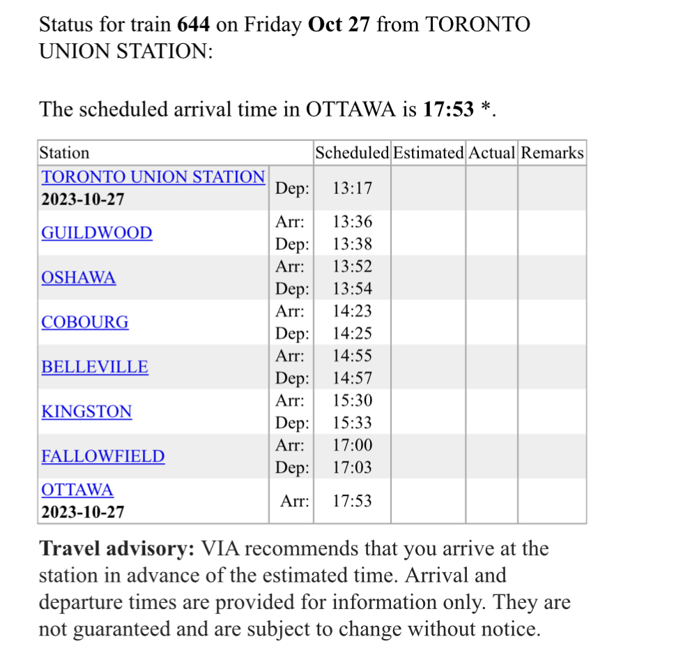

Over at groups.io, Tom Box has already looked up and linked the timings for the new trains:
Here are the schedules of the restored Ottawa - Toronto trains.
#43
#647
#644
#646
Comparing with the last pre-pandemic timetable(March 8, 2020),
we see that #43 is very different, running about 2 h 20 min
later than in 2020. #647 runs about 30 min earlier than in
2020. #644 and 646 are very similar to 2020. None of those
trains stopped at Guildwood in 2020. All of them are to do
so on the new schedule.

I've updated my VIA Rail spreadsheet with the new Ottawa-Toronto trains.
Eastbound: trains 644 and 646 are new
Westbound: trains 43 and 647 are new
The new express train 43 is the fastest trip on the route.
And here's a quick glance at daily frequencies:
There is roughly hourly service from Kingston to Toronto:
