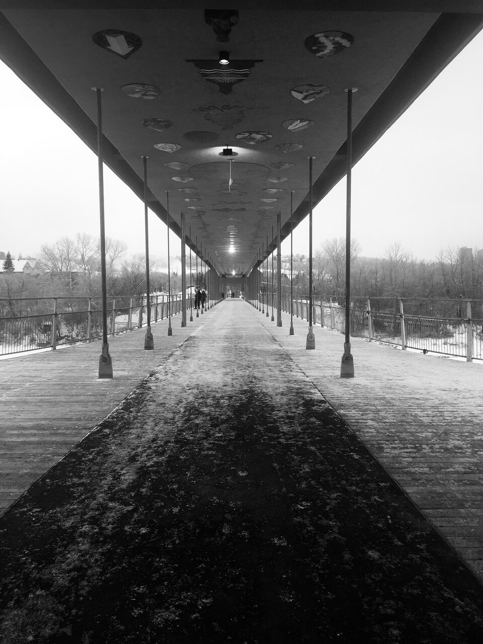

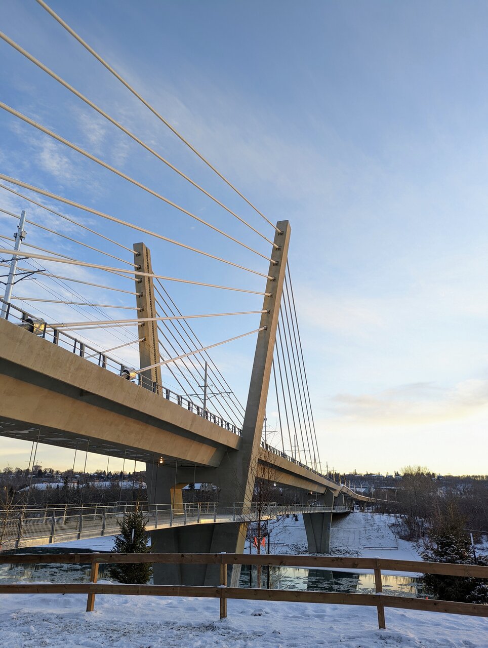

Grand Opening of the Tawatina Bridge MUP
20211212_141301.jpg20211212_142303.jpg20211212_142619.jpg20211212_142632.jpg20211212_142702.jpg20211212_142933.jpg20211212_143339.jpg20211212_143408.jpg20211212_143641.jpg20211212_143920.jpg20211212_144056.jpg

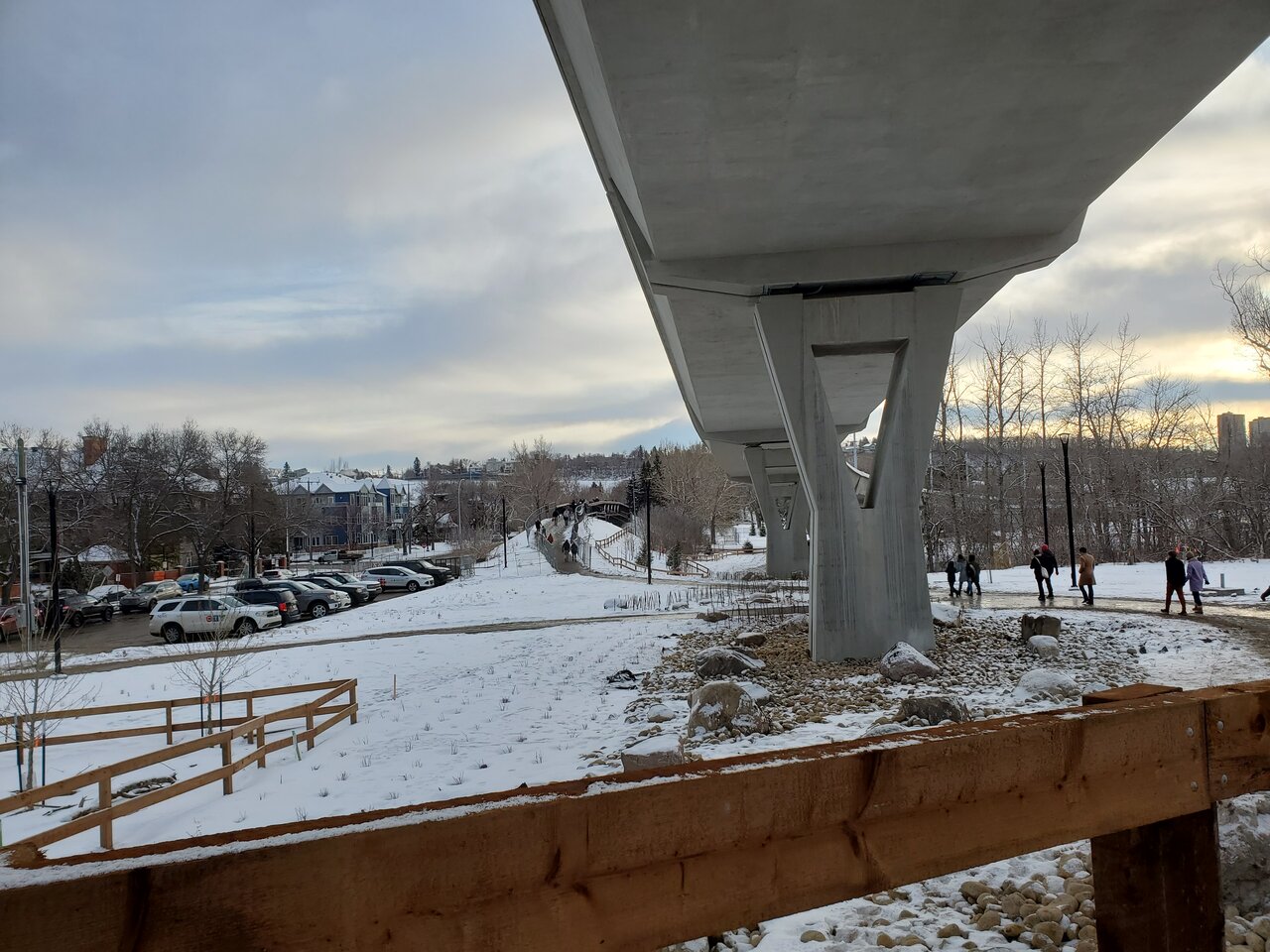

nice wide bridge. lots of people on at 3:30 yesterday.However the trails were a bit slippery getting there.One of the switch backs down from the convention centre was not sanded. so it was a bit of a bobsled run down with a wheel chair. But we made it while laughing all the way down. and it was worth it.

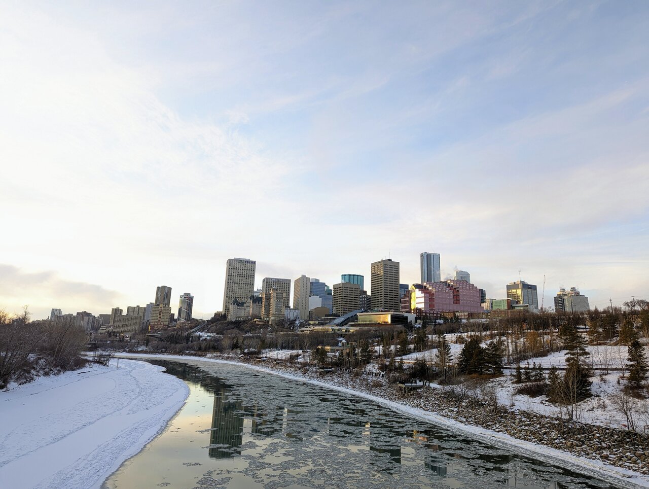

This bridge immediately achieves "landmark status" in Edmonton -- beautiful design well executed. It should garner exceptional use, especially connecting downtown parks to the Muttart Conservatory. Great area location for a riverboat access port. It also should add impetus to Alldritt's 80 storey hill crest development.

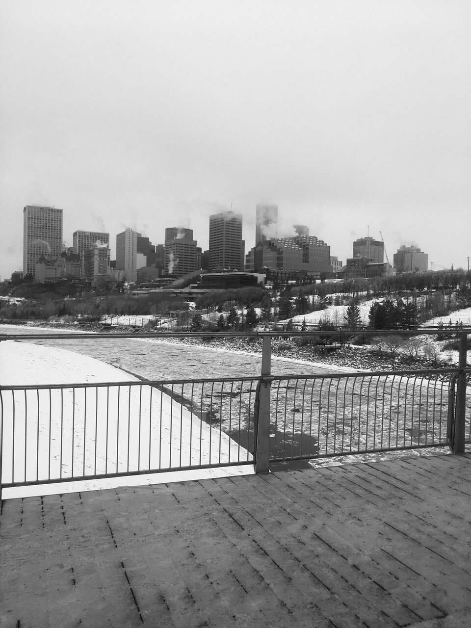

I wiped out a couple of times on my way to the Tawatina, and I had my winter boots on. The SUP of the bridge itself could have used some shoveling.

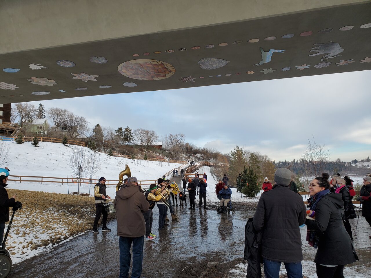

The smudging/drumming ceremony was good, but the yapping dogs on the bridge made things hard to hear.

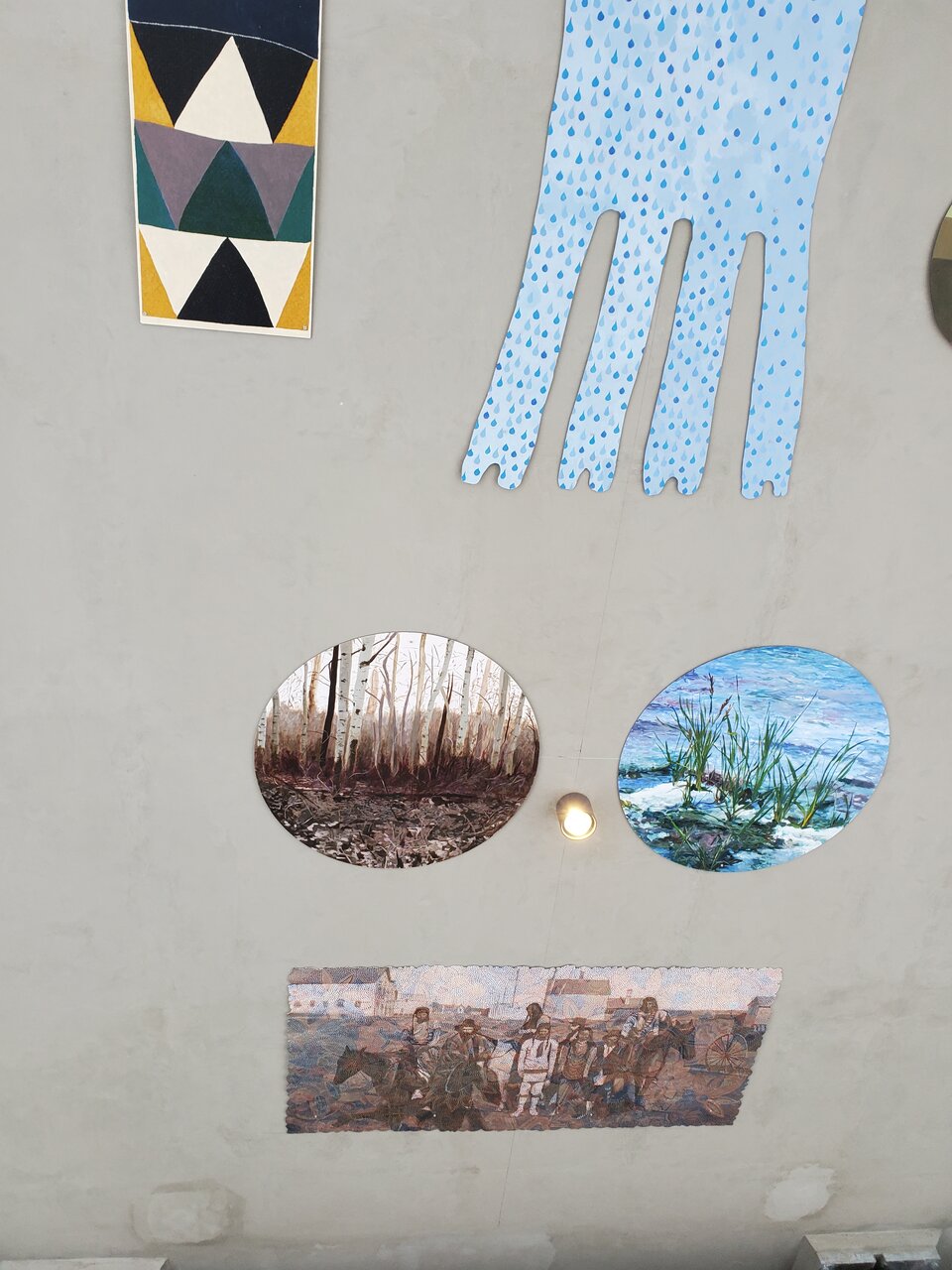

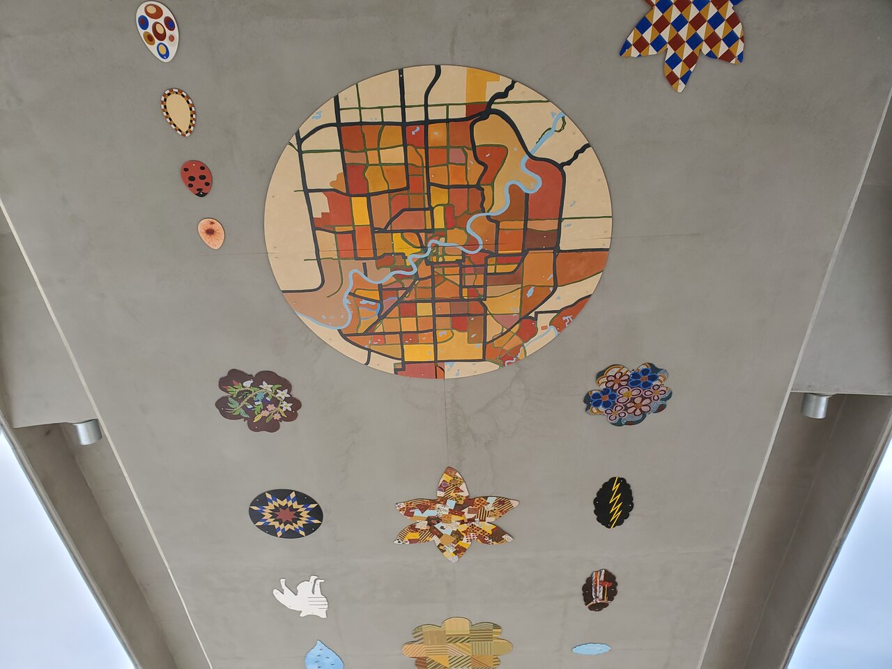

I didn't really see any higher-ups there who I wanted to meet. I did chat with MLA Janis Irwin and we admired some of the artwork together - you can spot her in a couple of my pics.
I wanted to take more pics but I didn't want to lose my fingers to the cold!
I'll be back in the spring once the snow and ice are gone.
