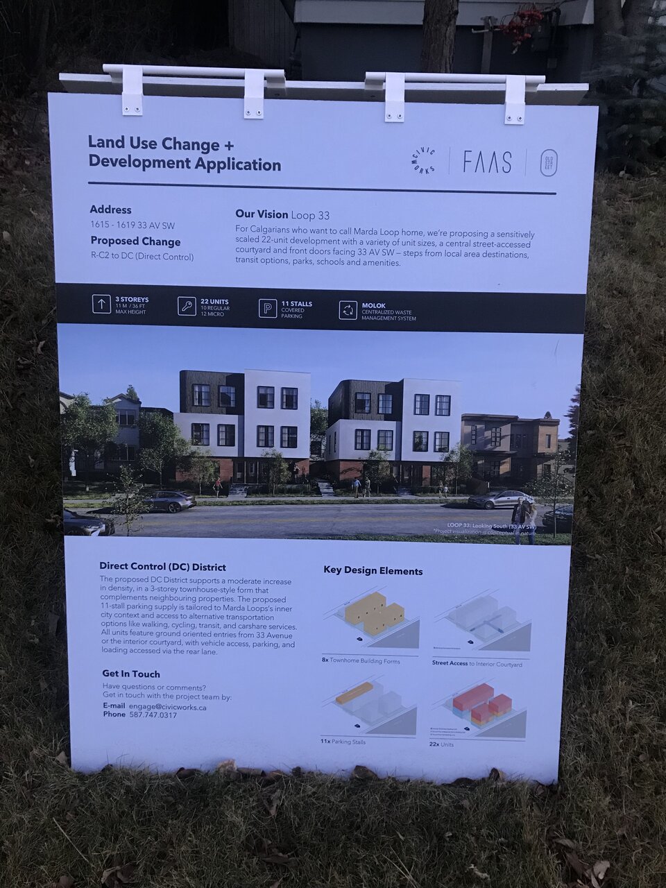

I think there are similar (identical?) proposal(s) on 33rd Ave SW. Looks like the same development team. I actually don't love these proposals on 33rd, as I think development on 33rd Ave SW should exclusively be 4-6 story condos, but row housing continues to be proposed on the street. I think the form makes sense at this location on 18 Ave NE, although it's too bad that they couldn't have purchased the lots on either side of this lot to make this a larger development, particularly the other mid-block lot, because redevelopment of those lots will probably have follow a similar formula.
