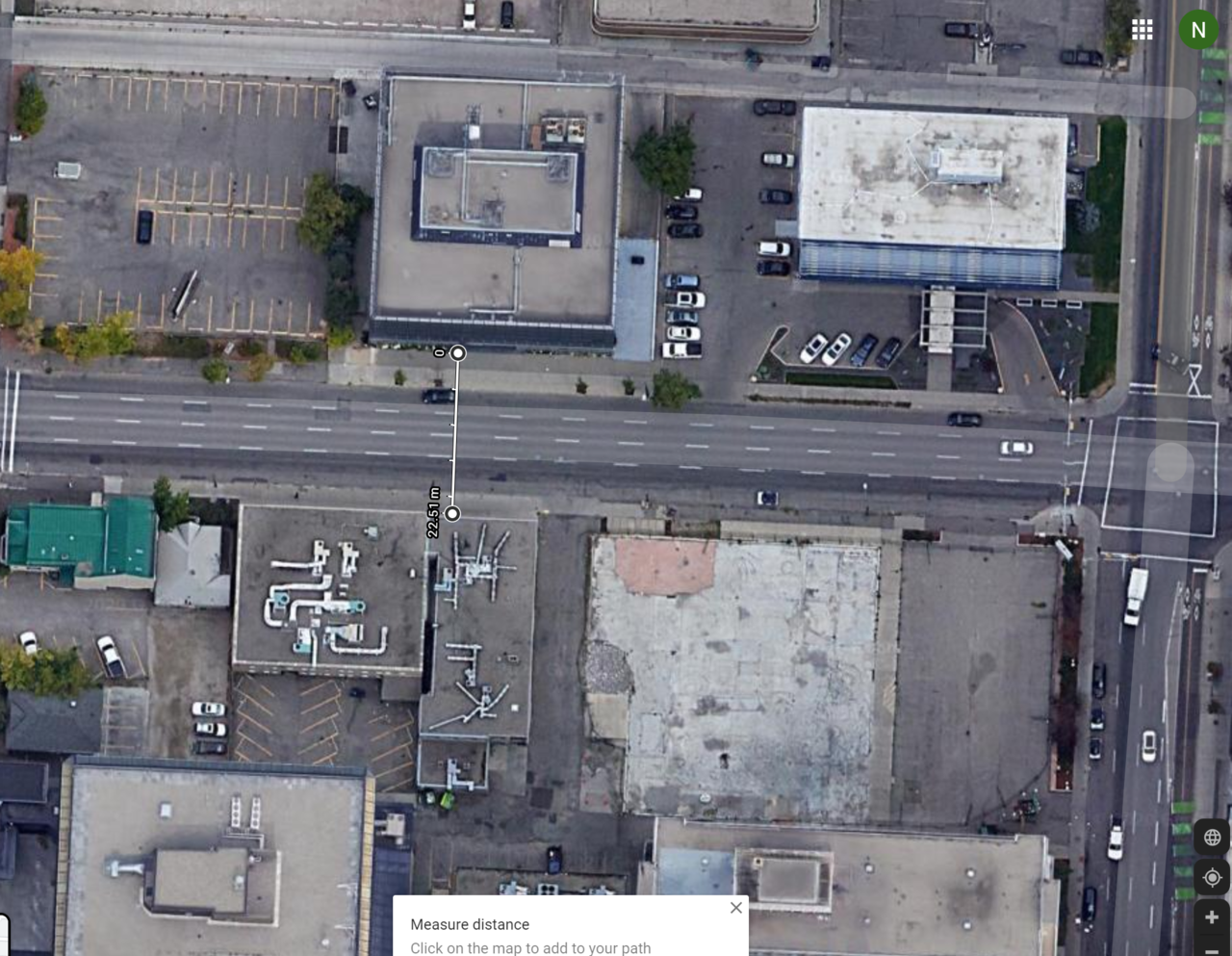

I really think they need to address the fact that no one wants to live on a one-way freeway road which makes up the majority of our downtown streets (4th, 5th, 6th, 9th Ave). The ROWs are way too large for vehicles, have behemoth parking lanes, no tree line assignments and shitty/small sidewalks and public realm. If you want to make streets that are calm enough that people would actually want to live on, convert these Avenues (at least two or three of them) back to two-way streets, or reduce the drive and parking lane widths and keep them one-way for the most of the blocks with the exception of where flyovers come in, etc. No wonder these feel so windy and uninviting there aren't even trees.
Here is what I think:

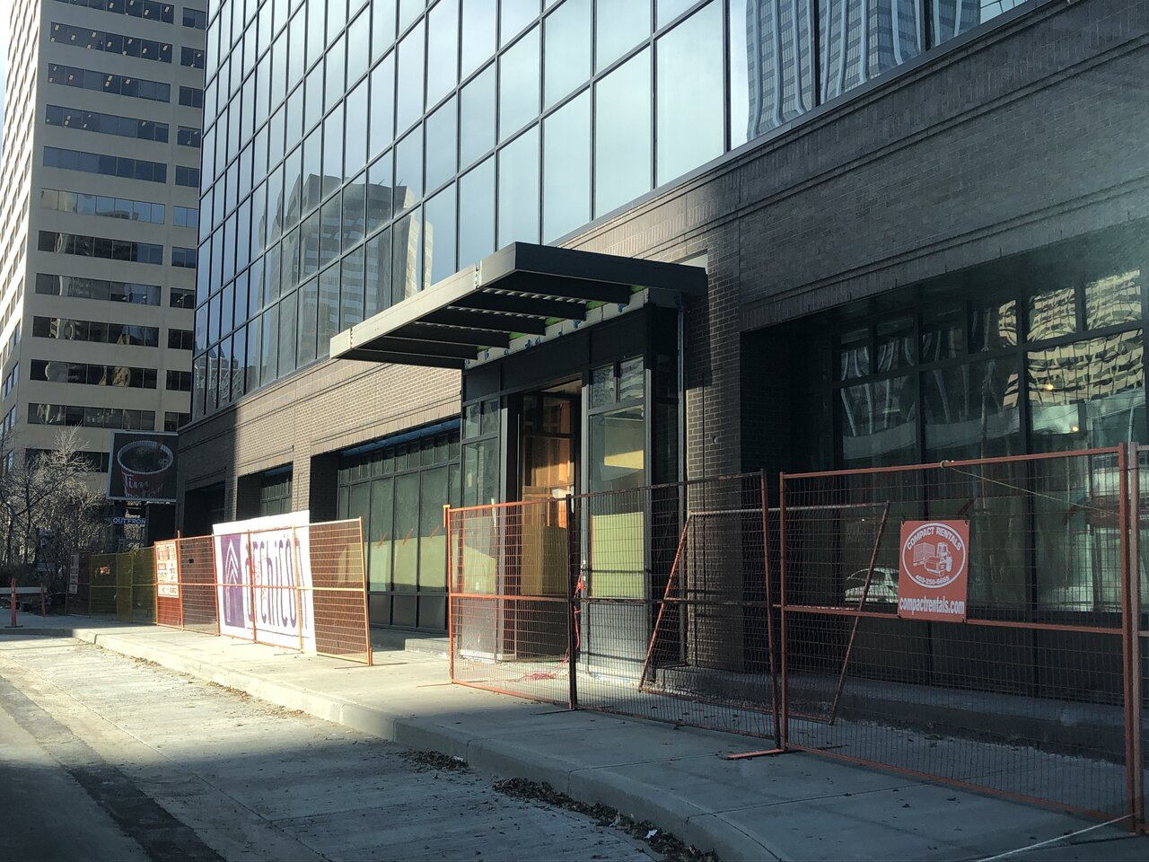

Which in the renovation of this building the city allowed the road to be widened for vehicle parking, making the public realm even worse:

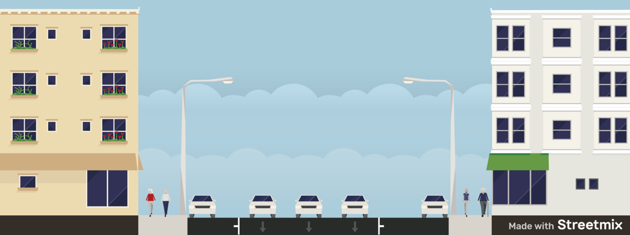

Here is basically how the ROW was before taking away more sidewalk space for a wider roadway (approx):

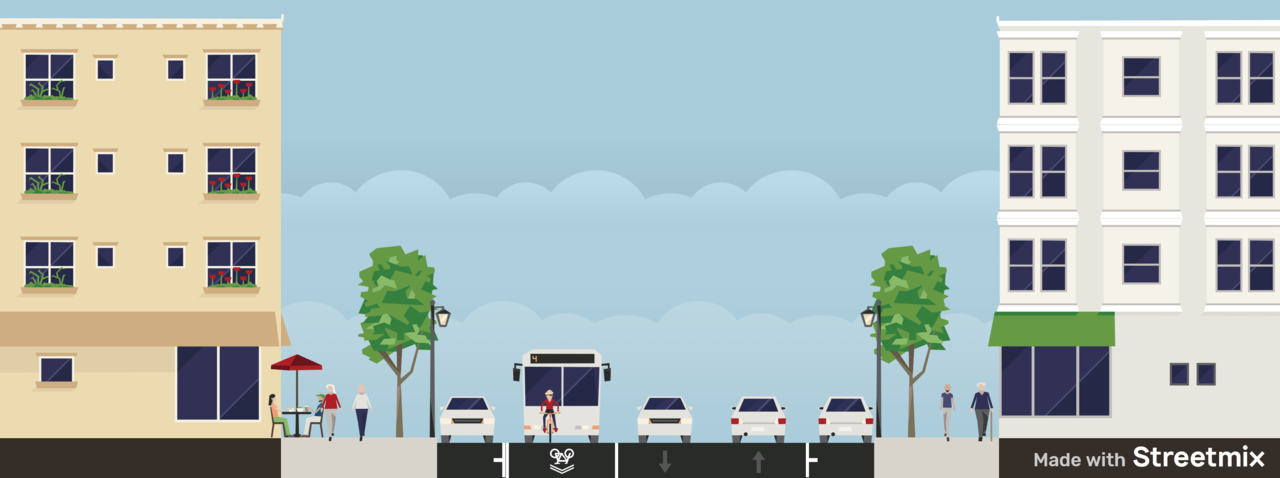

And here is what I think it ought to be if you want to create a street that residential development would actually want to be on (Two-Way example):

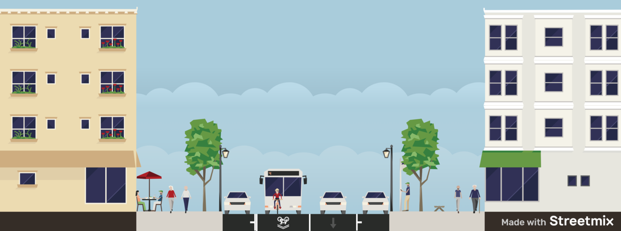

and one-way possibility:
You could still have oversized drive lanes, big lanes for buses, add tree line assignments and more pedestrian oriented light fixtures, expand the sidewalks a bit, create areas to sit outside of businesses and still have completely adequate traffic flow.
The one-way example would being to look a lot like this:
So sure, City admin/council want to create a better downtown, and for this hotel renovation project they allowed them to widen the vehicular ROW exasperating an already poor condition into one that somehow caters even more to vehicles. They have no plan to improve and beautify downtown except to 'encourage investment in residential'. Well no one wants to live on a freeway of a street with no trees where all the retail is in +15s that close at 5pm sharp. Allowing this additional road widening goes to show that the City didn't have a vision for how to improve the condition of 4 Avenue in front of this 'investment' downtown, they just did they same patchwork they always do. The hotel operator wants a drop off point, take that chance to improve the public realm condition not make it worse.
Figured this is the place to talk about how to create a better vision for how downtown could improve without just saying "it needs investment in residential development". Residential doesn't want to be located on the types of street conditions we currently have downtown it isn't desirable, maybe begin addressing that.
Bingo. I sure as heck wouldn't want to live in the downtown core even if I was still in my mid twenties and there was an abundance of residential supply - maybe on Stephen Ave, but certainly not anywhere on 4th, 5th, 6th or 9th Avenues.
I was surprised that so many on here seemed to be okay with the provision of the layby with the hotel conversion on 4th. It's really a case of two steps forward one step back - on one hand the street-front interface of the building is much improved, but now there are no trees on the sidewalk and a reduced ability to provide patio seating. It's unbelievable that we are still doing this in 2020.
There is so much excess capacity on 4th Avenue that there would be no issue having 24 hour parallel parking and a simple loading zone in front of the hotel. Transportation engineers at the City unfortunately continue to operate as if we are living in 1972. Didn't Nenshi bring in Rollin Stanley to fix all of this? What happened there? :)
