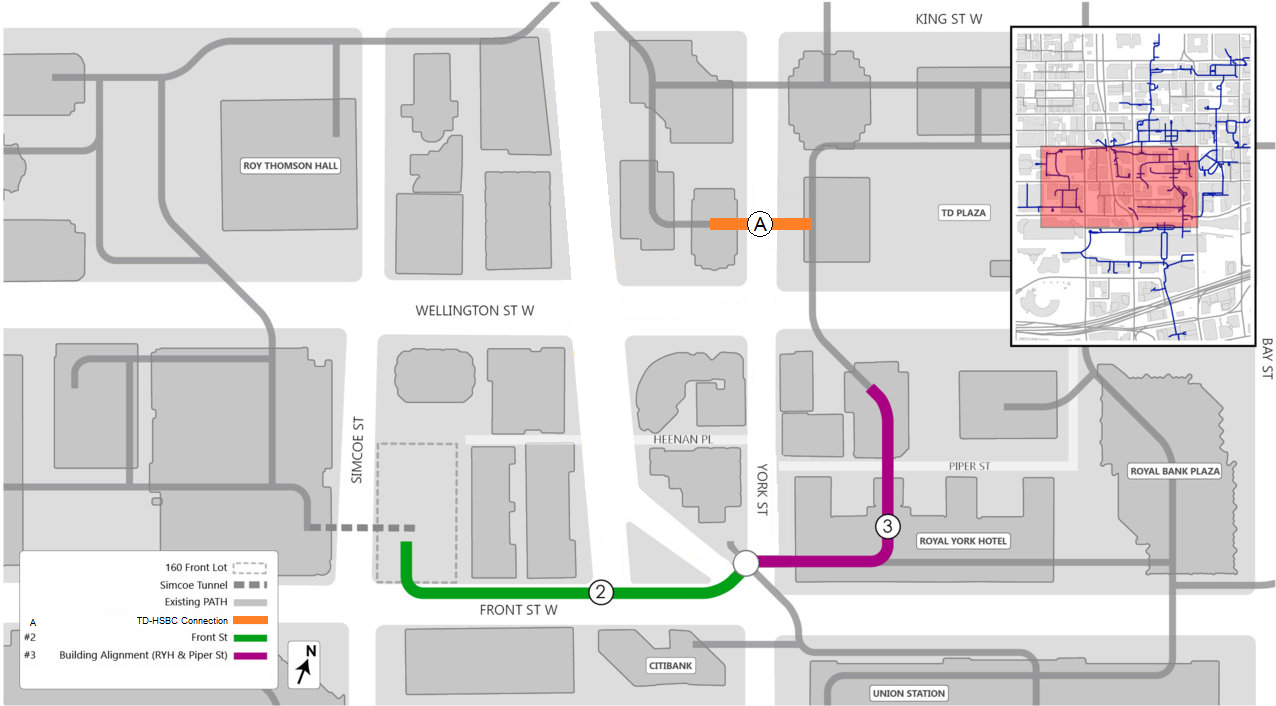

It's still nonsense that it's considered being exclusive. Alignment 2 is needed regardless. Even if there's crazy utility conflicts, it should be protected for, especially when 160-174 Front St W are developed.
  • 2 connects the existing PATH network west of Simcoe Street, which is currently only connected through St Andrew Station
    • 160 Front
    • Simcoe Place
    • CBC
    • RBC Place
    • The Ritz
    • Metro Hall
    • Roy Thomson Hall
  • 4 connects the PATH within the block bounded by Wellington, University, King and York, but being in a parking garage may limit any associated commercial stores
    • 145 King
    • 55 University
    • HSBC
  • 3 is a useful elimination of a dead end, providing another alternative path from TD Plaza while providing more direct access to 95 Wellington
  • 1 just creates an alternative route from TD Plaza, not a fan in terms of building connections

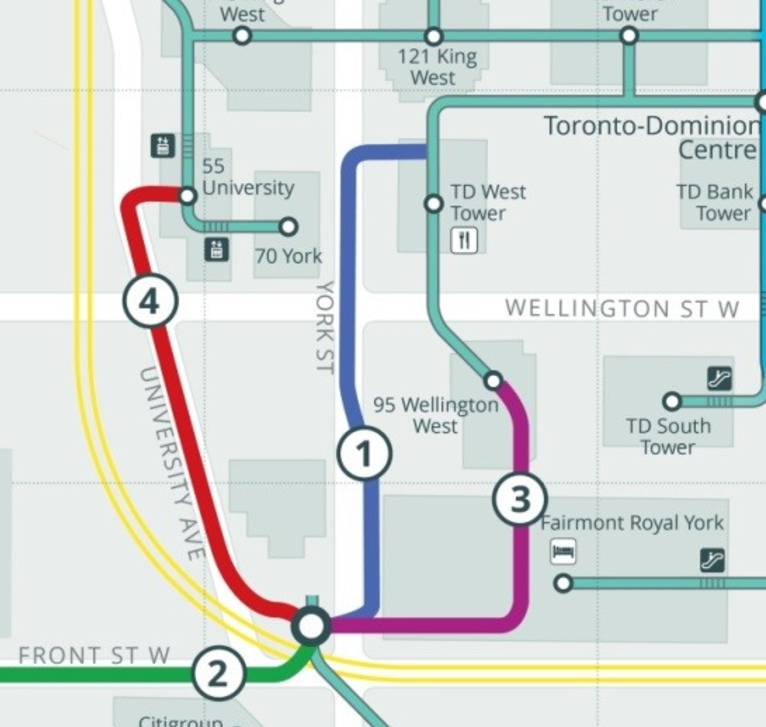

Given this, I agree 2 should be built as the primary connection, and 3 should be pursued shortly after. But a link under York between TD Plaza and HSBC needs to also be on the agenda (A).
I don't think this route is a bad idea per se (especially with an eye on future developments) - but I think the route maybe relatively inconvenient for existing users that you want to divert from the current PATH.
I agree. But the York link to the TD Food court was also lacking. You would have to go back east before going North. The best solution would be to basically make a pedestrian link all the way up York to University (the Sun Life/Exchange Tower connection).
No perfect solution. At least they found one and we hopefully there will be more.
It'll be really bad if they have to close the PATH to build the new CC building for 3+ years during construction. The one route will be way overcrowded.
They didn't want York because it is expensive and the city balk at paying for it, not because it is a bad alignment - in fact that's the reason why we are redoing this spiel in the first place, so that's that.
You would have to go quite a bit further east:
That is why I thought the best route under York was to connect with the HSBC (70 York) building on the west side of the street which, in turn, is connected to 55 University anyway. Not sure why that route never even made it to the map.

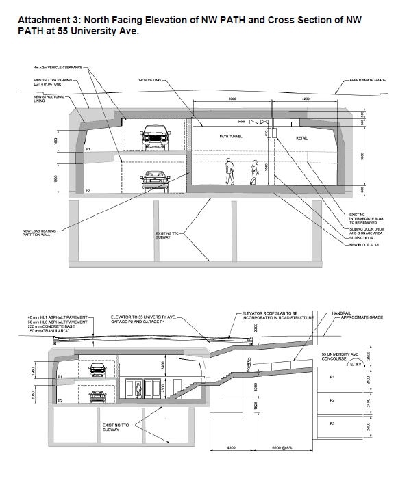

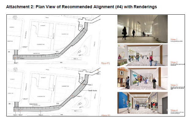

From the July Government Management Committee Meeting:
Item: http://app.toronto.ca/tmmis/viewAgendaItemHistory.do?item=2018.GM29.24
Report: http://www.toronto.ca/legdocs/mmis/2018/gm/bgrd/backgroundfile-117801.pdf
University Avenue alignment chosen - project cost approx $87M. From the report (p 22/23):
I wonder how successful those proposed retail along the route will be.
Great final solution. However, I do have some lingering questions from this report:
1. What will happen to the York Street ramp to the garage? Will it be closed? Alternative NB solution?
2. They discussed accessing the offices on the west side of University. How are they going to access them? A pedestrian crosswalk similar to RBC Dexia?
