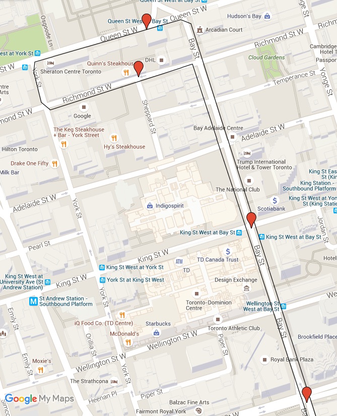

With talk about a Downtown Relief Line going along Queen Street and possibly terminating at the City Hall, let's turn our attention to the very delayed reconfiguration of the Union Station Streetcar Loop.
Instead of just reconfiguring the Union Station Loop (renaming it Front Street Station), remove the loop completely, and replace it with a Queens Quay type of underground station, and continue the streetcar tunnel north. North until it terminates next to the City Hall Station at Queen Street.
Looping counterclockwise a single streetcar tunnel around the block at Richmond, York, Queen, and Bay, could have two single platform stations at Sheppard Street (not Avenue) and at City Hall Station. An additional station could serving and named the Financial District Station at King Street West.
You have it going under the subway at Union, and then under multiple PATH connections in the financial district. I would be surprised if this is feasible.
Go luck with the EA. The line will be sitting at 25m under the surface. If you do dig and cover, you're going to close off one of the busiest road in the whole downtown core.
I also don't think the big banks will be happy to see a tunnel being dug beside their lovely buildings hoping their foundation to get destroyed while this line goes in. If you go with TBMs, it's not worth it for such a short line.
It's definitely feasible. The main question is whether the ridership would justify the costs.
It's definitely feasible only in the sense that engineers can draft plans for anything. It's not feasible with common sense. It's absurd, regardless of where the line is.
