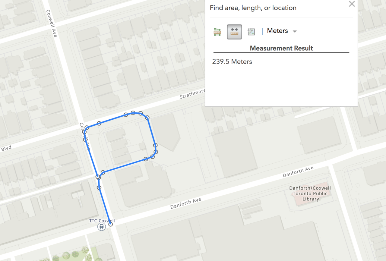

I would just loop it like this:
Space is a concern but the station can be easily modified to fit the 30 meter beast.
Have you ever been to Broadview station?
Broadview and Coxwell are two completely different cases. Broadview has to deal with streetcars from both the 505 and 504B, two of the busiest streetcar lines in the entire system. Coxwell is also far less busy than Broadview so there's less risk of running behind schedule or disturbing traffic. Remember, Coxwell would only see a streetcar at most every 10 minutes, so traffic slowdowns would occur but shouldn't significantly impact traffic.
Broadview and Coxwell are two completely different cases. Broadview has to deal with streetcars from both the 505 and 504B, two of the busiest streetcar lines in the entire system. Coxwell is also far less busy than Broadview so there's less risk of running behind schedule or disturbing traffic. Remember, Coxwell would only see a streetcar at most every 10 minutes.
Both however looop via sidestreets.
