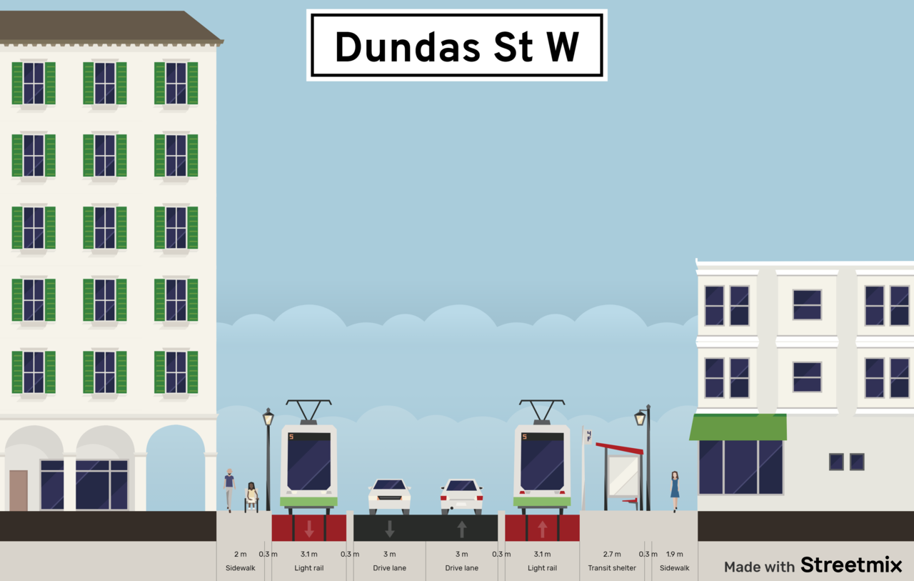

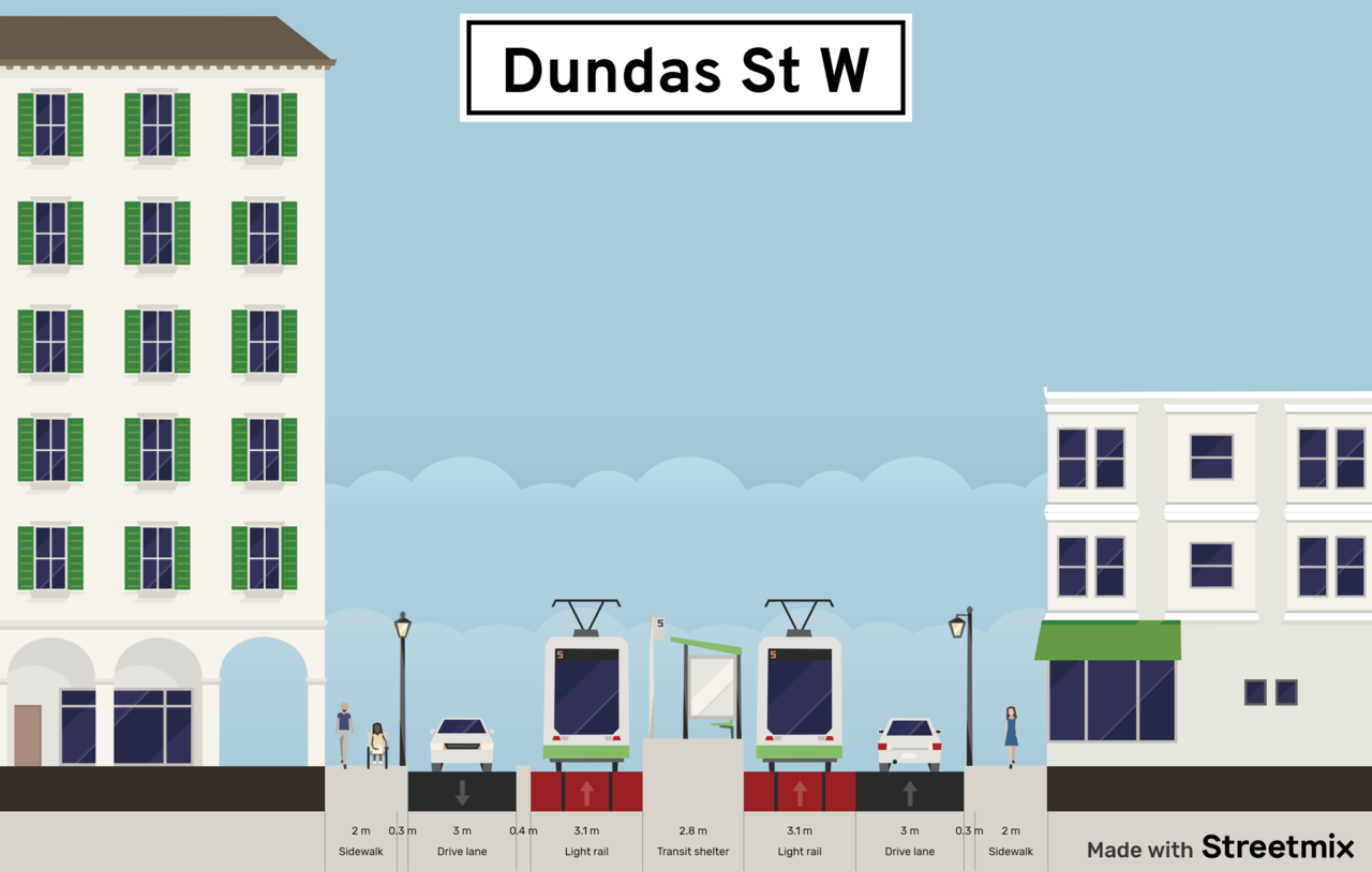

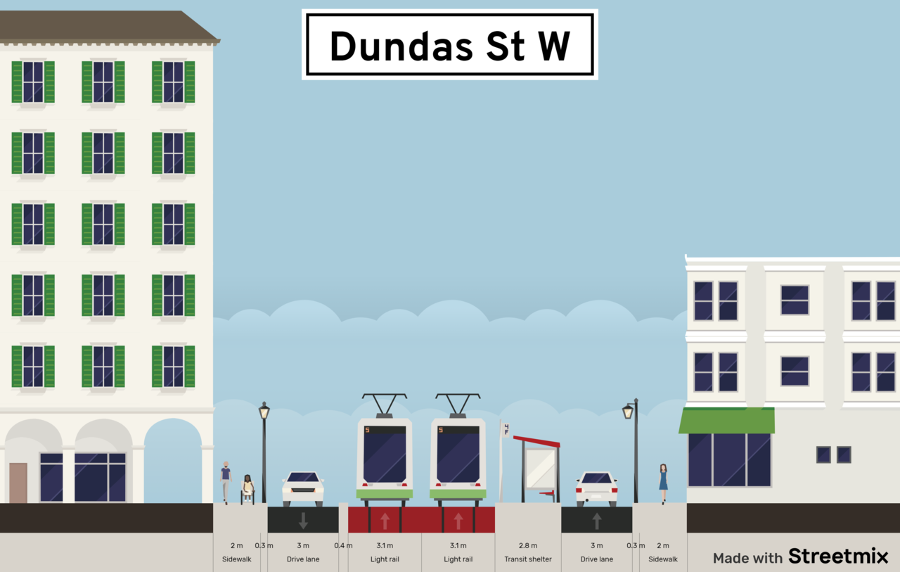

Used streetmixer to come up with some ideas for how dedicated streetcar(/bus) lanes could look like on narrower ROWs

Used streetmixer to come up with some ideas for how dedicated streetcar(/bus) lanes could look like on narrower ROWsView attachment 475586View attachment 475581

I applaud the ambition, but just to note, the City's minimum standards for accessibility require all sidewalks to be 2.1M wide at the minimum.
South of Dundas, though the City/TTC would doubtless object, you could easily run the LRT on a single track in that section, so as long as you had a two-track area right at Queen, and another north of Dundas where you could hold vehicles. This is done in many places around the world.
North of Dundas, I think the streetcar volumes are likely too high for any one-way operation.
And yet they are quite happy in making sidewalks that are already narrower than 2.1 metres, even narrower. 1.9 is generous compared to what I frequently see.
They certainly REPAIR narrow sidewalks without making them wider but do you have examples of a new sidewalk being narrower than 2.1 meters. If so, I would ask the appropriate Councillor why.
