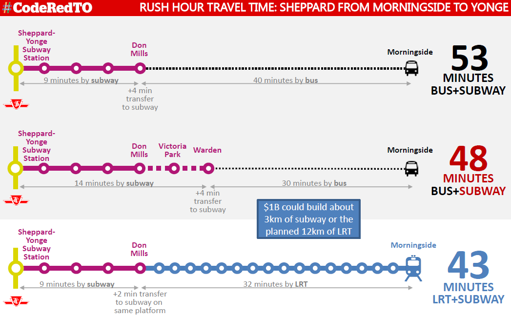

And yet it is faster than the bus. And even faster than instead extending the subway.
Note that this is AM peak, using 40-minutes from Morningside to Don Mills of 40 minutes. It's scheduled as 49 minutes at PM peak - if it's on time.
I love how the transfer time magically becomes 2 minutes with their preferred option. Seems fishy considering transfer time is dictated by the subway frequency regardless of how frequent the LRT is. You could have an LRT come every minute and you're still going to have the same average waiting time for the subway. But, you know, who cares about math.
Excellent point.
Seems reasonable to me. Don Mills (and Warden would too) have a 2 minute walk from the bus platform down to the subway platform. The LRT didn't have that problem; it's closer to a 15 second walk off the LRV to the subway (no stairs, no escalators, no long hallways).
You might want the the bus to terminate at subway level too. That's certainly doable but adds $600M (or more depending on ventilation/tunnel size requirements) to the cost of that option. Similarly, you could run LRT into the bus loop and chop $600M off the cost of that option.
You might want the BRT to terminate at subway level too. That's certainly doable but adds $600M (or more depending on ventilation requirements) to the cost of that option.
All you have to do is walk a few feet. If the subway comes every 4 minutes, then it's a 2 minute transfer. Might be slightly optimistic - but compare to the 4-minute transfer they use to get from the bus at Don Mills. That means they are giving you two minutes for a very long walk. Honestly, both numbers should be a minute or two higher really. I think you are cherry picking.
it's the fact that they recommend a solution based on decreased travel time which, if you were to adjust the transfer time to 4 minutes, the benefits would be, for all intents and purposes, negligible. It's not nitpicking it's putting it into perspective that it isn't inherently the LRT that is making this trip faster...it's the fact that the LRT will be at platform level. By that logic build a tunnel for the buses, which would be much cheaper and you'd shave off 2 minutes of travel time making the second option a mere 3 minutes longer than the preferred option without the need for a new LRV storage facility, intrusive road work on most of Sheppard, etc while still creating a sizable benefit to existing conditions.
it's the fact that they recommend a solution based on decreased travel time which, if you were to adjust the transfer time to 4 minutes, the benefits would be, for all intents and purposes, negligible. It's not nitpicking it's putting it into perspective that it isn't inherently the LRT that is making this trip faster...it's the fact that the LRT will be at platform level. By that logic build a tunnel for the buses, which would be much cheaper and you'd shave off 2 minutes of travel time making the second option a mere 3 minutes longer than the preferred option without the need for a new LRV storage facility, intrusive road work, etc.

However, if you did, it might work, for now, westbound in AM peak. But recall the whole basis of this is to deal with 2031. It's already 9 minutes longer eastbound in PM peak. And it's supposed to get worse.
I agree that comparing the transfer time isn't useful, but it is obvious that cross a platform transfer is a lot quicker than going from Subway to Bus (especially at this station). By "much cheaper" I assume you mean a more complicated and expensive bus tunnel to somehow bring buses to the platform level is much cheaper than the entire LRT? I would suggest that tunneling the last portion of the LRT is a large and complicated part of this design - but to say we can run buses down to the subway platform level as a way to discredit the transfer times is not apples to apples. Larger tunnel, more ventilation, and probably the most impossible part, a place for the buses to loop around. Even with BRT there is a lot of road work that would have to be completed.
The point of that chart is just if the LRT goes to track level you will save switching vehicles - I don't think that's why they recommended the option.
