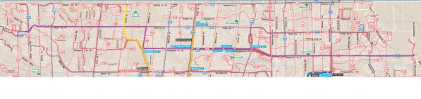

In the Scarborough RT thread, EnviroTO drew up an absolutely brilliant proposal for Sheppard West. Rather than have it continue along Sheppard, tunnel it underground northwest to Bathurst and Finch, and then run along Finch to Keele. Not only would this close the loop, but would connect the Finch and Sheppard LRTs without the need for an extra transfer.
Here is EnviroTO's map

They found out it would cost them more then they initially thought. That being said to eliminate a transfer at Fairview and to have a continuous route it makes a lot of financial sense. Going west with LRT with surface stations is much cheaper then going underground. The conversion is what sucks but it at least makes a real crosstown route. I don't see the problem as long as Bloor Danforth is extended then scarborough residents cant say they didn't get a subway.
Still a bad idea. You would need to dig under Sheppard Ave. until at least Bathurst From Yonge. 500M$ is a lot of money that could be used elsewhere. With your plan, you're screwing people living east of Dufferin on Finch. Between Bathurst and Yonge, lots of growth is happening and single homes are being replaced by townhouses. The density is rising very fast and an LRT would very useful to them.

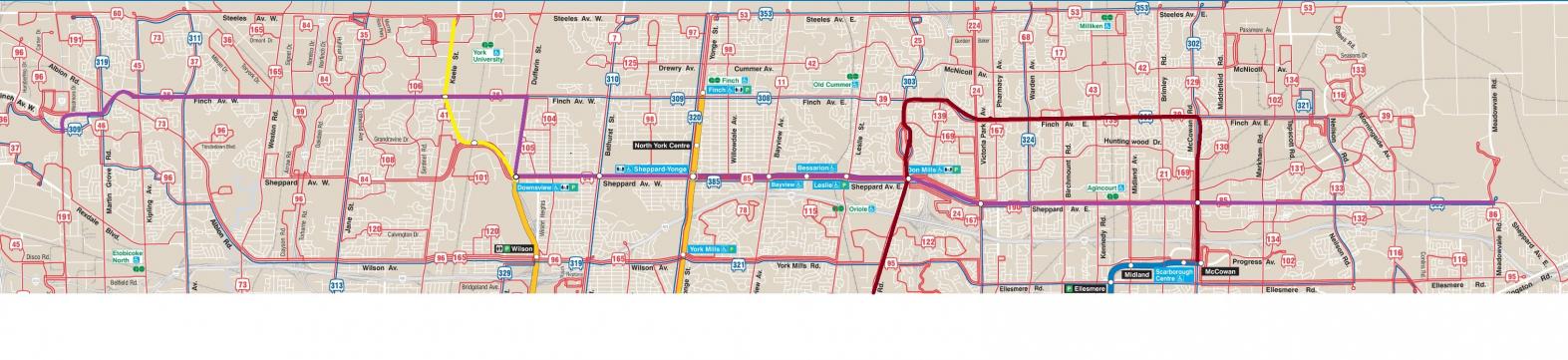

does that mean you are ok with service on both finch and on sheppard??????? most people think that's a duplication of service although I would eb in the camp that would like to see both get service. The idea is that dufferin is easily wide enough to fit in the LRT. Sure you are correct that people living in the area you mentioned are screwed. No plan is perfect. If I was to continue drawing lines on a map my Don Mills LRT would turn east at finch and go all the way to mcowan.

does that mean you are ok with service on both finch and on sheppard??????? most people think that's a duplication of service although I would eb in the camp that would like to see both get service. The idea is that dufferin is easily wide enough to fit in the LRT. Sure you are correct that people living in the area you mentioned are screwed. No plan is perfect. If I was to continue drawing lines on a map my Don Mills LRT would turn east at finch and go all the way to mcowan.View attachment 13005
LRT and Subway doesn't provide the same level of service (in regard to Finch and Sheppard). They would complement each other, not duplicate each other.
I know that on a map Sheppard and Finch seems near but they are farther apart than they look except between Allen Road and Keele
